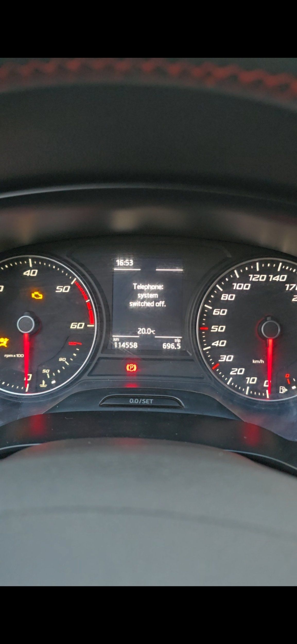

I own a 2015 Seat Leon Mk3 (MQB platform) and recently installed a Junsun V2 Plus Android head unit (8667Q, 1280×720).
Since the install, I’m having several CANBUS / MFD issues and I’m hoping someone with a similar setup can help.
Problems / symptoms:

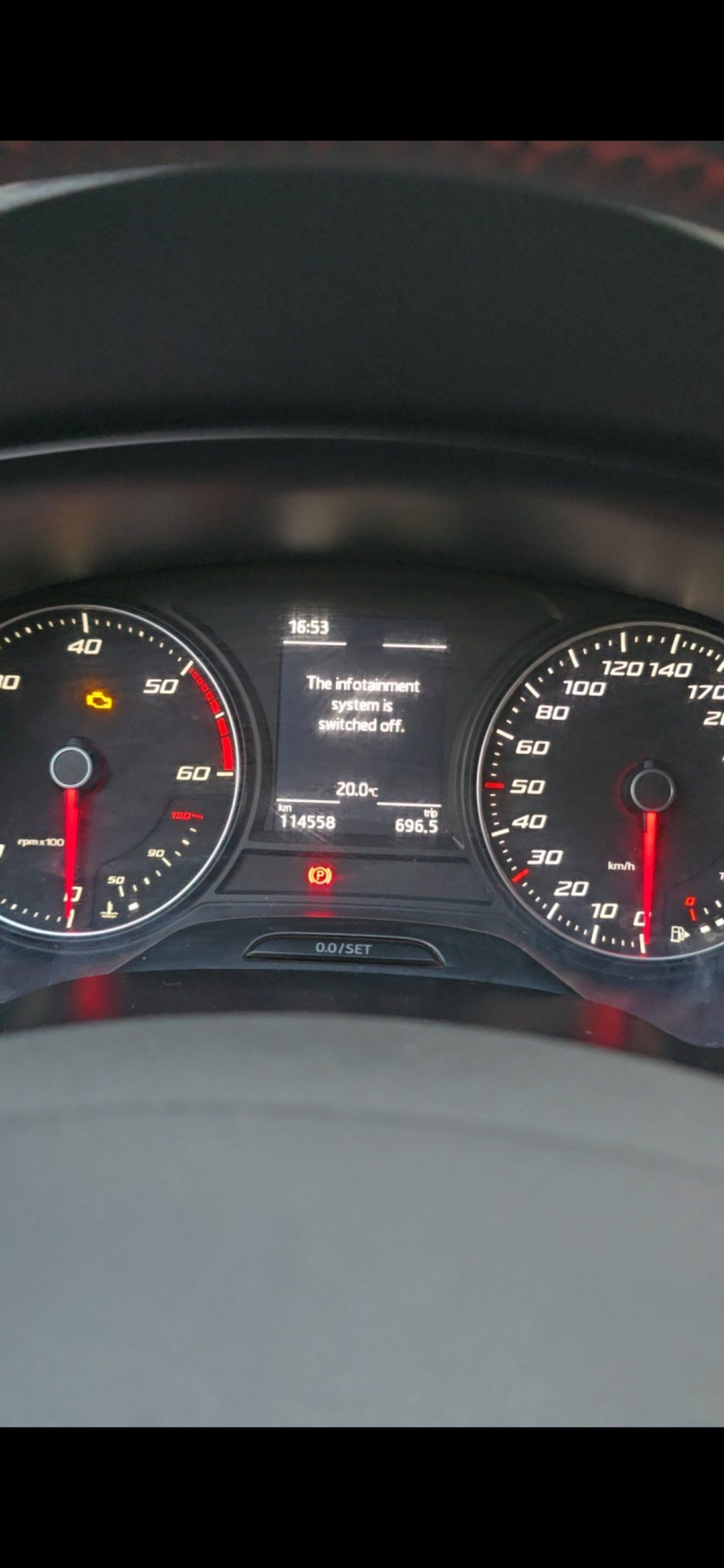

1. The MFD (cluster screen in steering wheel) constantly shows these messages:
– “Infotainment system is switched off”
– “Telephone system is switched off”
2. Steering wheel buttons work, cameras work BUT:
– no track / song info is shown on the MFD
– no caller info is shown
– Android Auto works on the head unit screen, but the MFD only shows “no name” instead of the track title
3. When I change source on the head unit (Radio → BT → Android Auto), the error message on the MFD changes (Infotainment / Telephone), but it never fully goes away and I never get proper infotainment data.

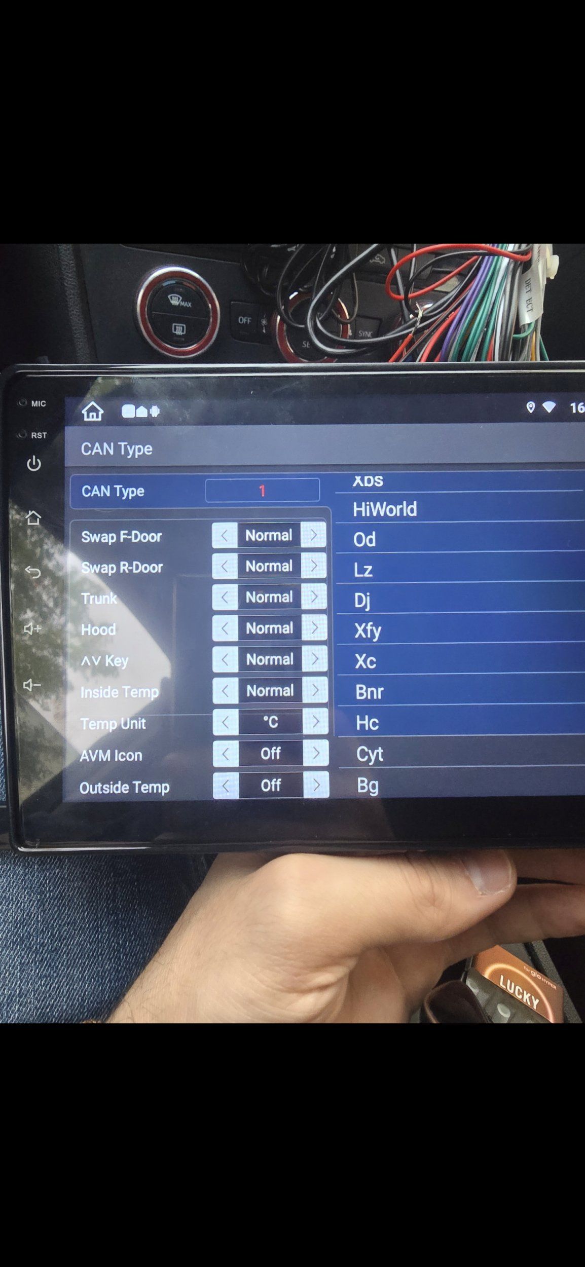

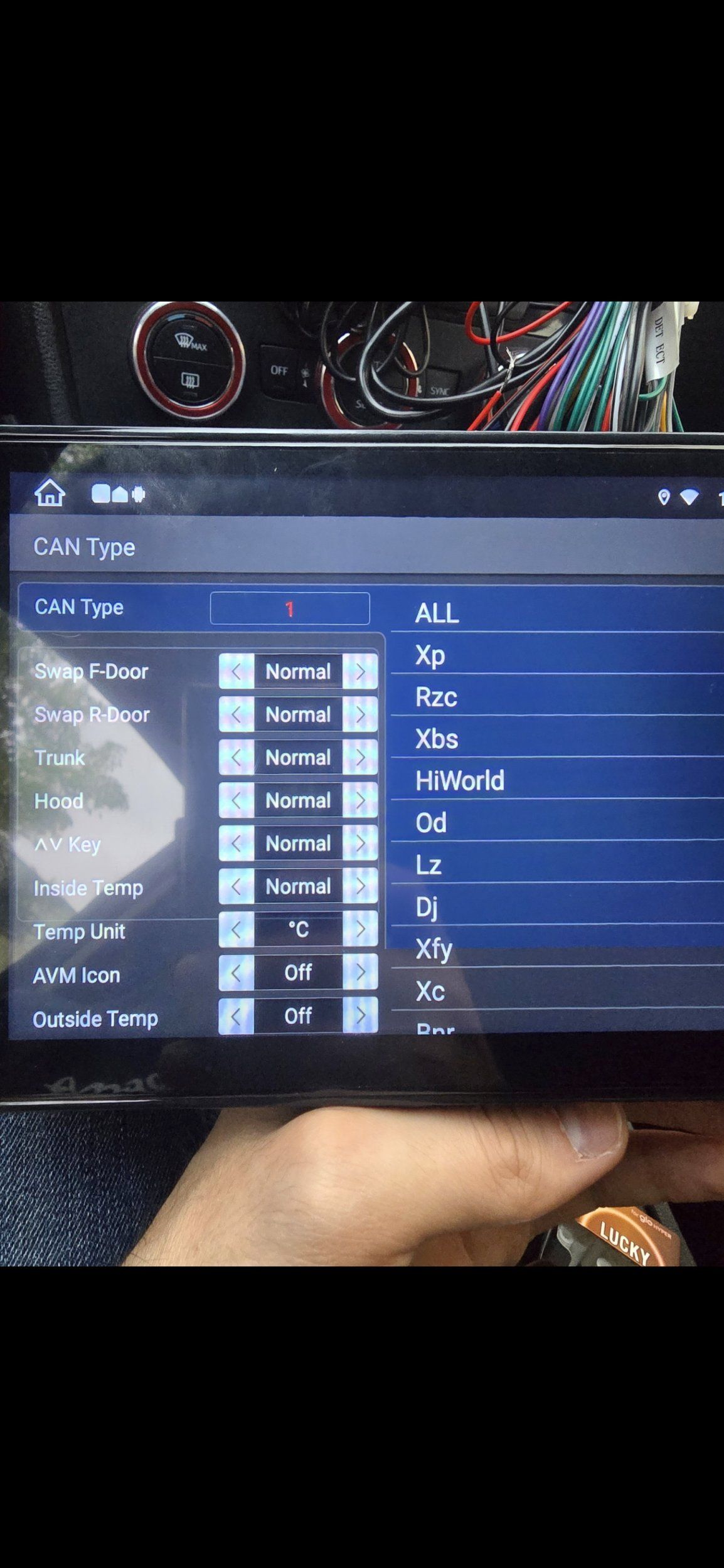

In the CAN settings of the Junsun, I have several CAN types to choose from:
XP, RZC, HiWorld, XBS, XFY, DJ, etc.
I’ve tried all of them. None of them fixes the MFD infotainment issue.

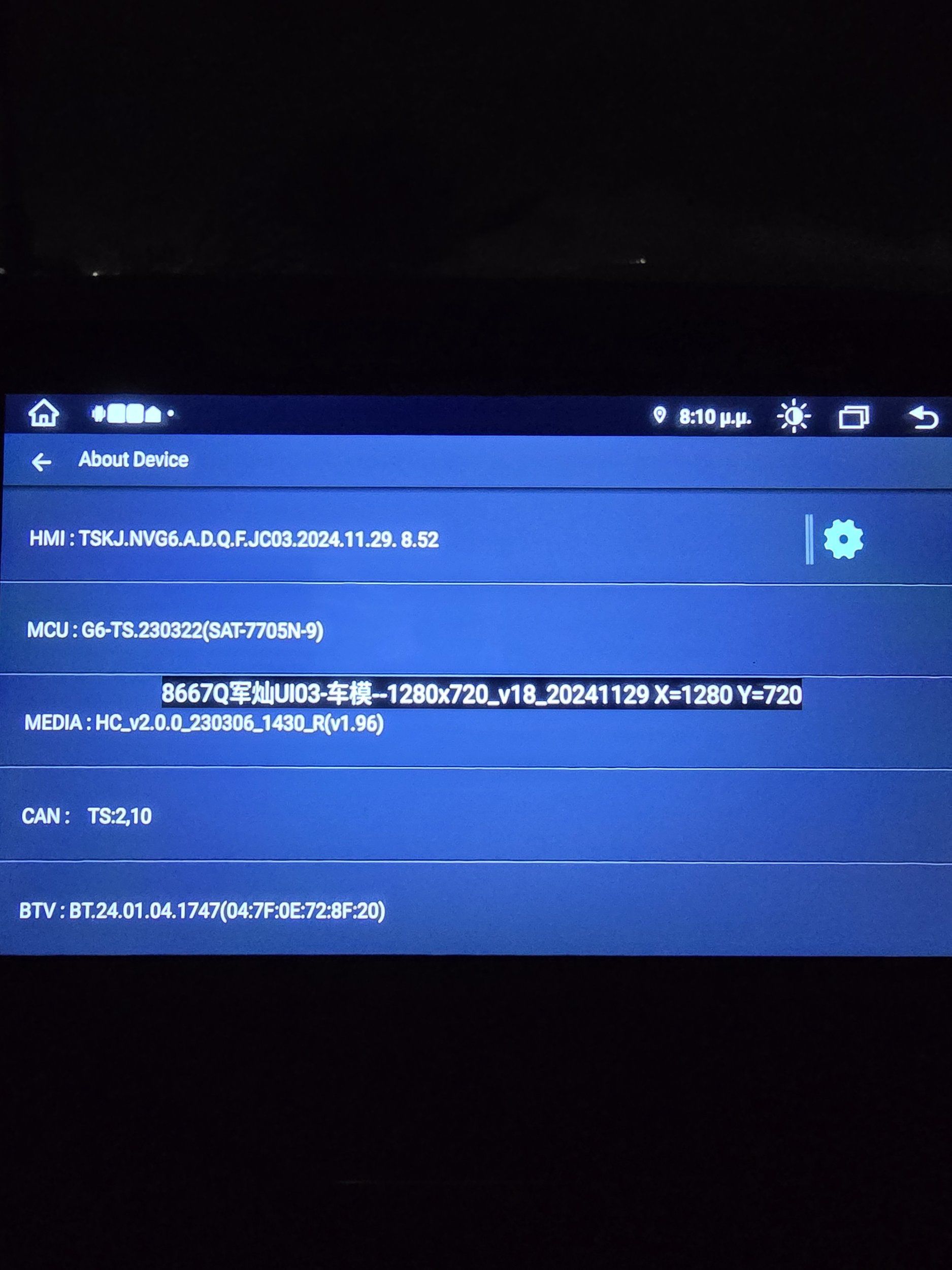

Head unit details:
- Brand/model: Junsun V2 Plus - FF_866X - MS96NV - 8667NV
- Platform: 8667Q
- Resolution: 1280×720
- HMI: TSKJ.NVG6.A.D.Q.F.JC03.2024.11.29 8.52
- MCU: G6-TS.230322 (SAT-7705N-9)
-MEDIA: HC_v2.0.0_230306_1430_R(v1.96)
- CAN driver/version: TS:2.10
- Android version: 14

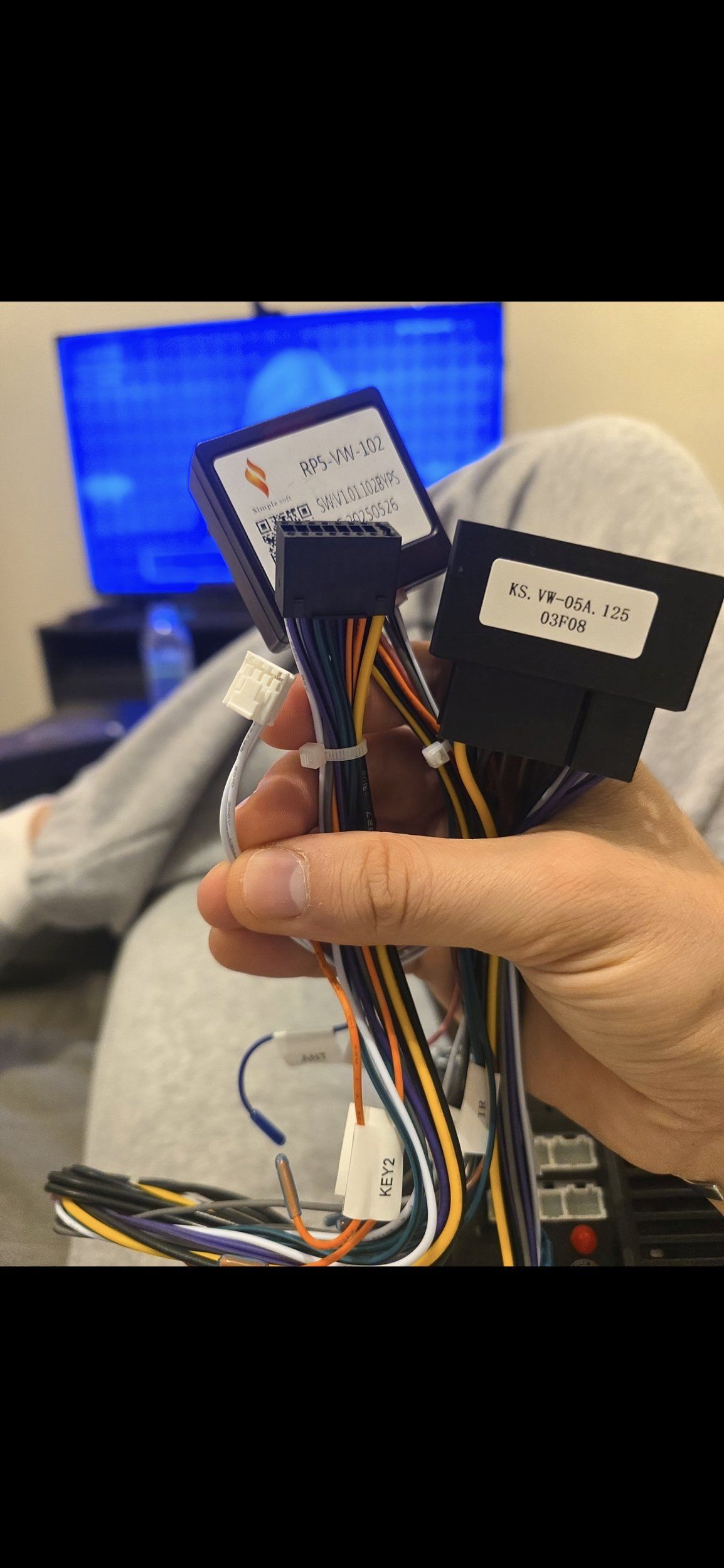

Wiring / CANBUS setup:
- Car: Seat Leon Mk3 (2015, MQB)

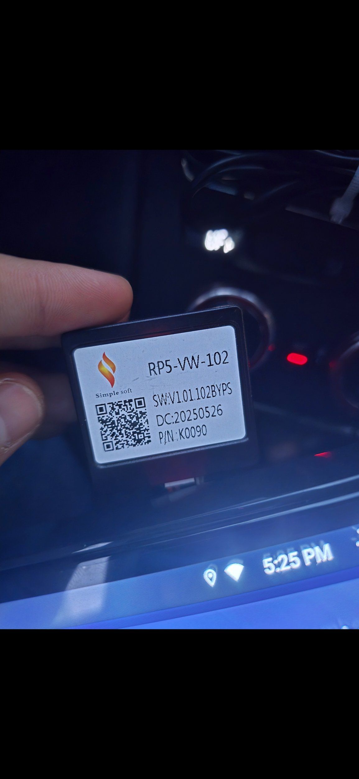

- Factory Quadlock → KS. VW-05A 125 03F08 harness
- CANBUS decoder on that harness: SimpleSoft RP5-VW-102

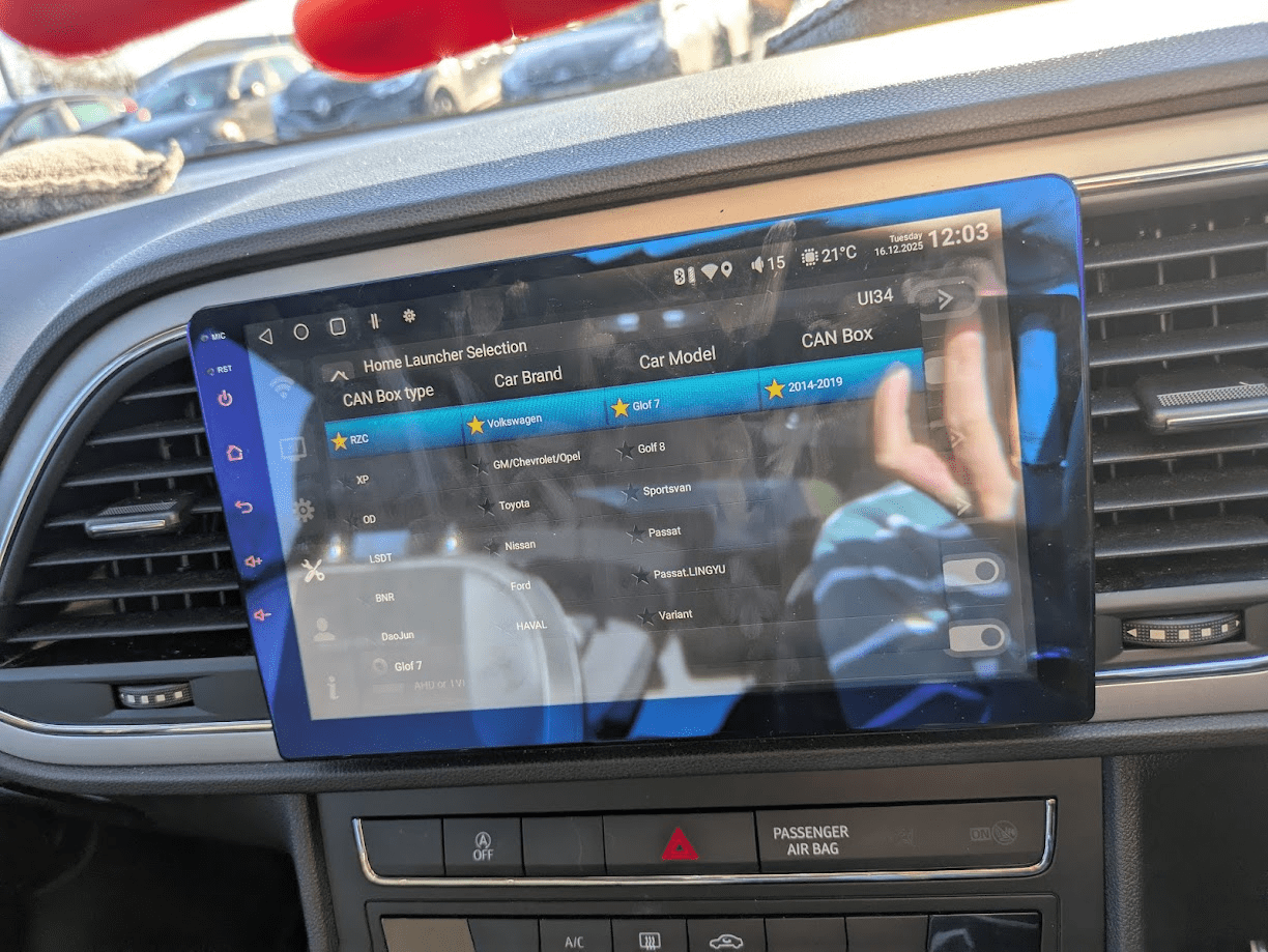

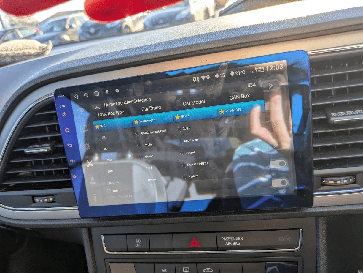

I have a EKIY T9 android (uis7862) headunit in my leon mk3.5. I've had no issues like yours, mine has been pretty flawless apart from poor microphone. My software looks a bit different, but for what it's worth I'm using a raise canbus decoder. I believe these canbus decoders are specifically for VW cars. Mine is set to golf 7 in the settings.
Note, my car spec is very basic, no autoheadlights, no autowipers, no heated seats, very basic standard headunit (MIB2-ENTRY), no ambient lighting, no radar, no folding mirrors, no auto climate control, basic black and white instrument cluster.

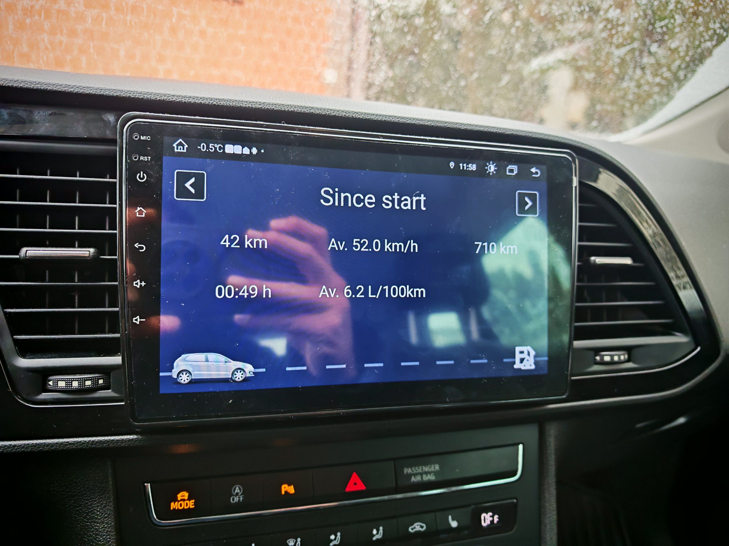

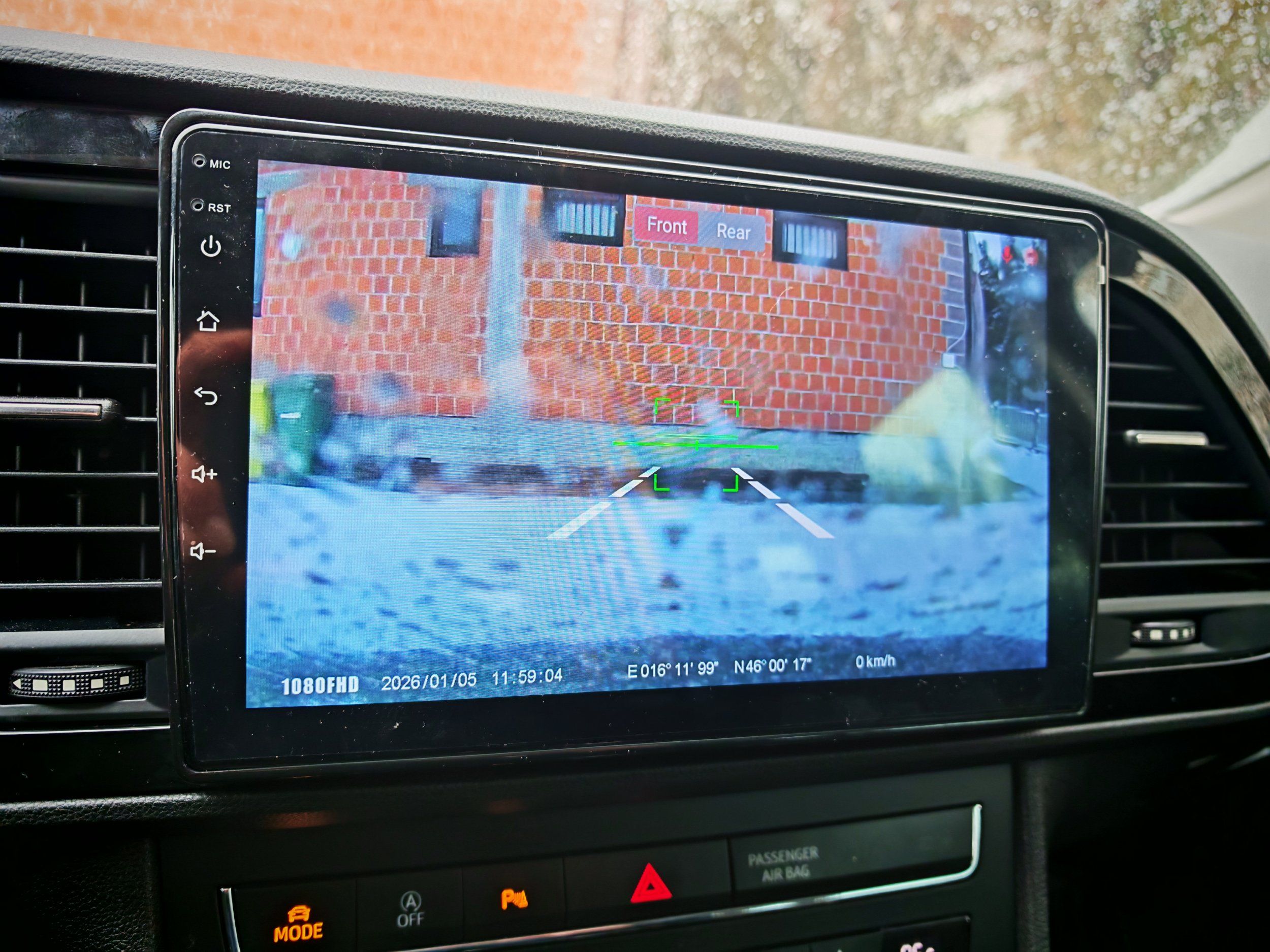

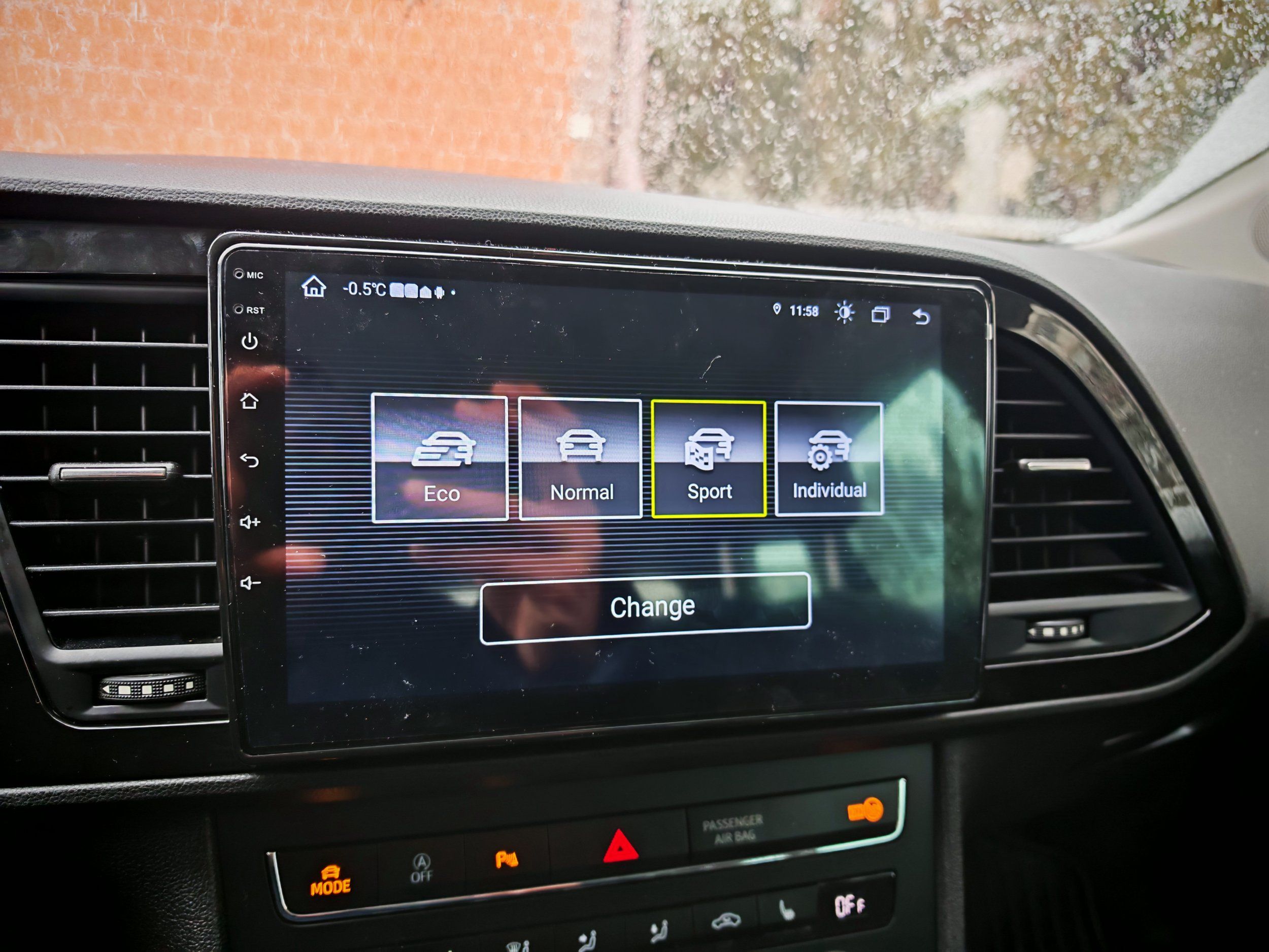

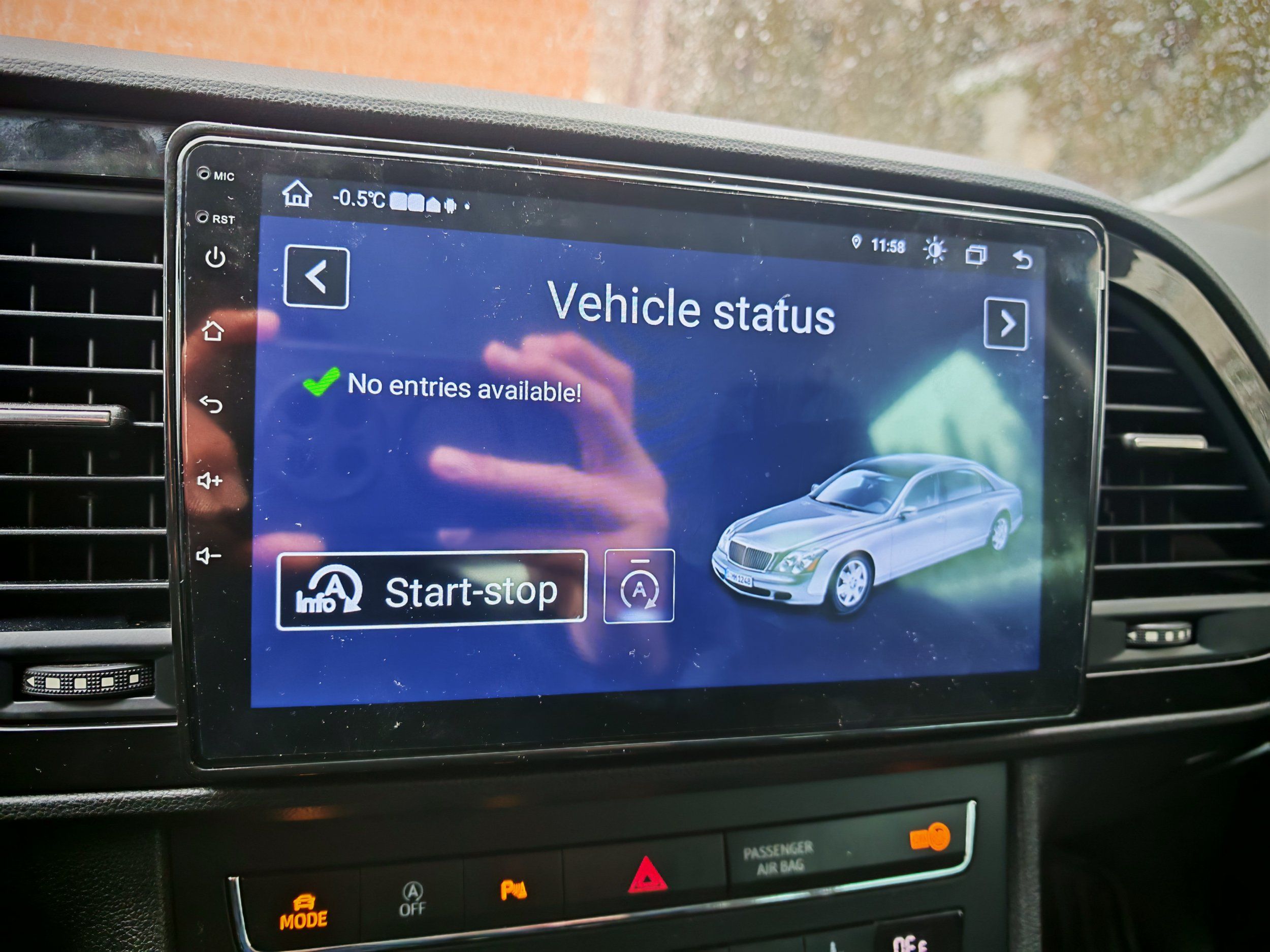

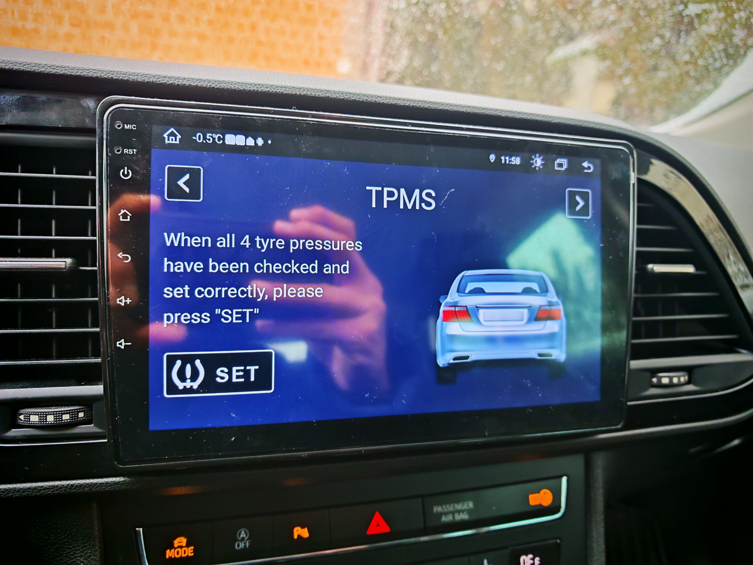

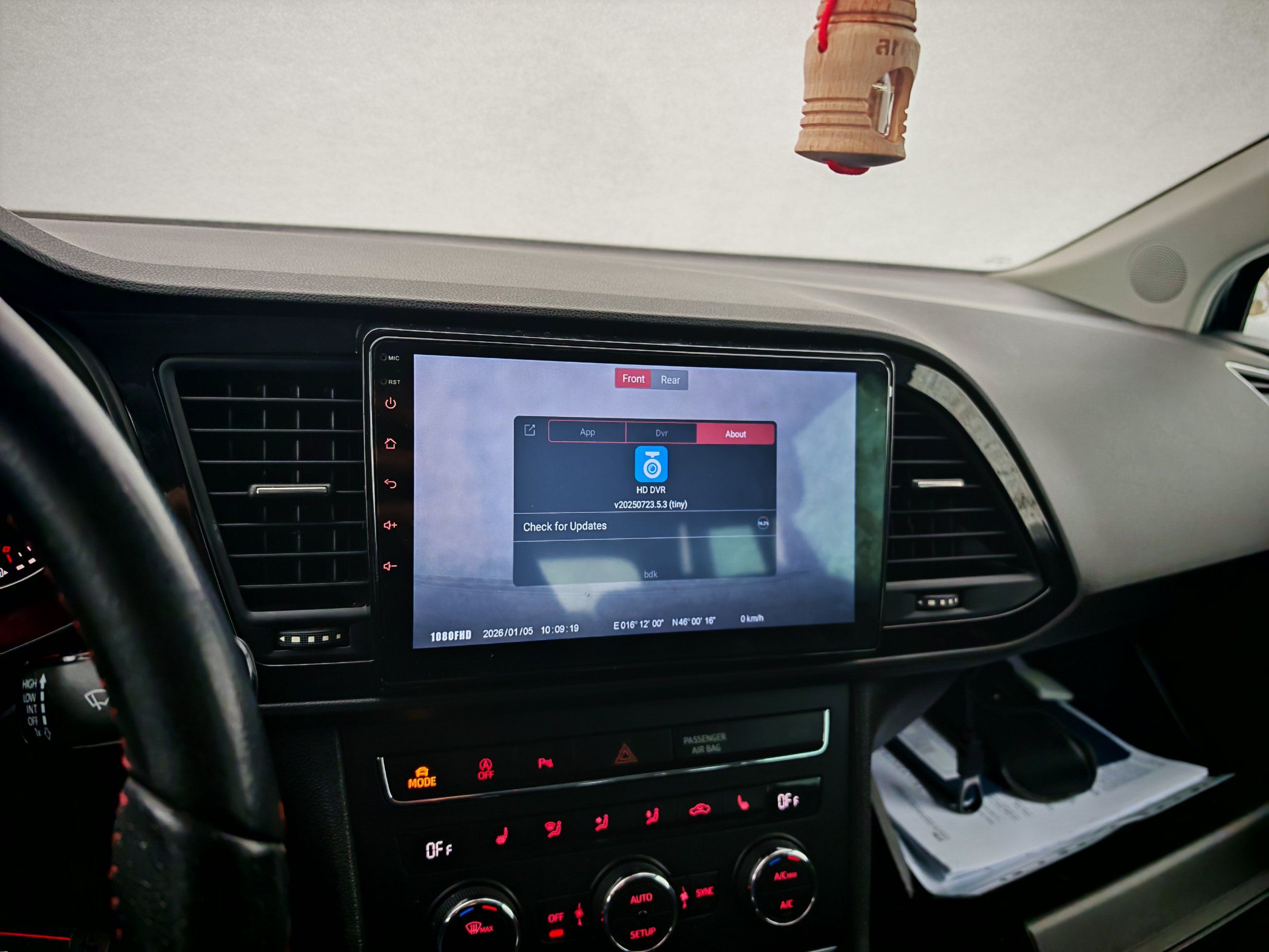

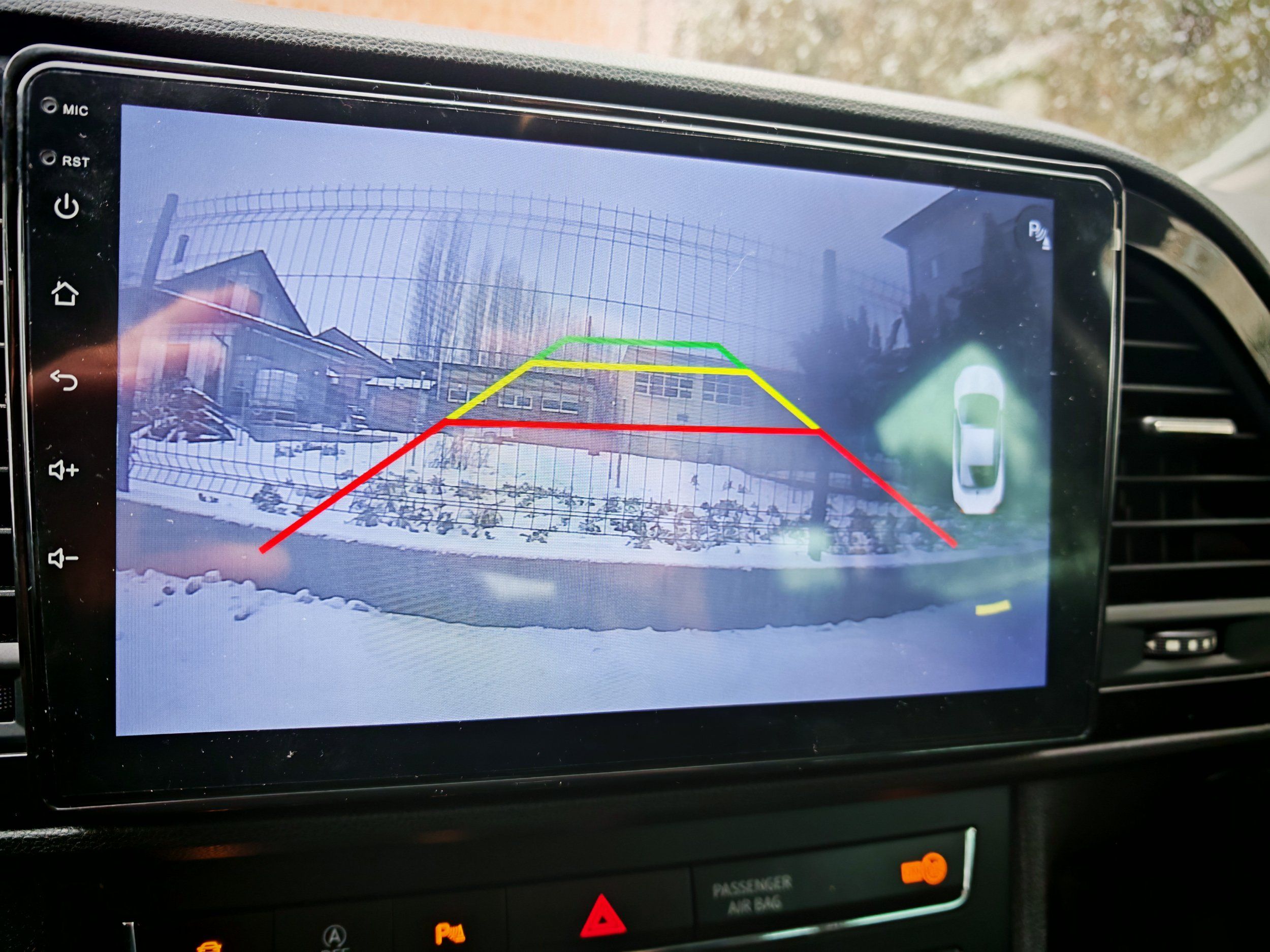

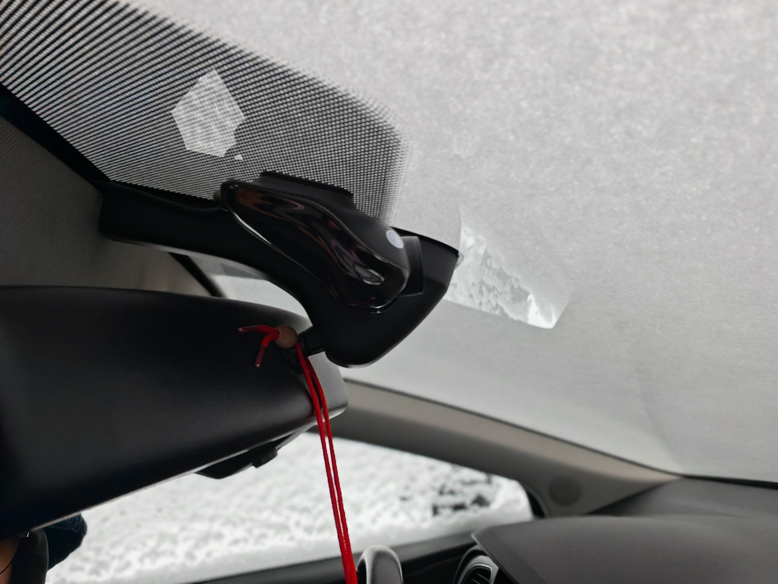

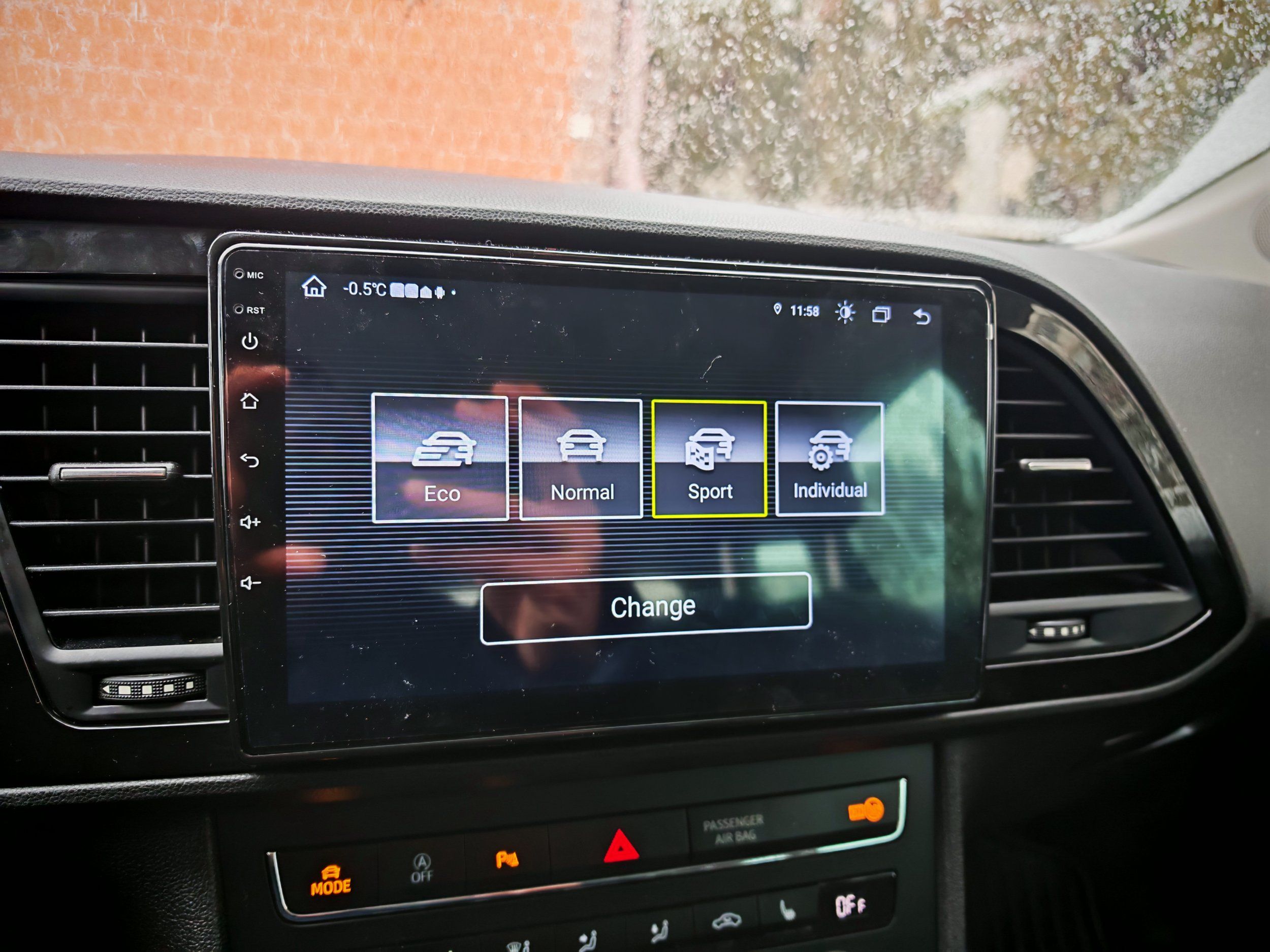

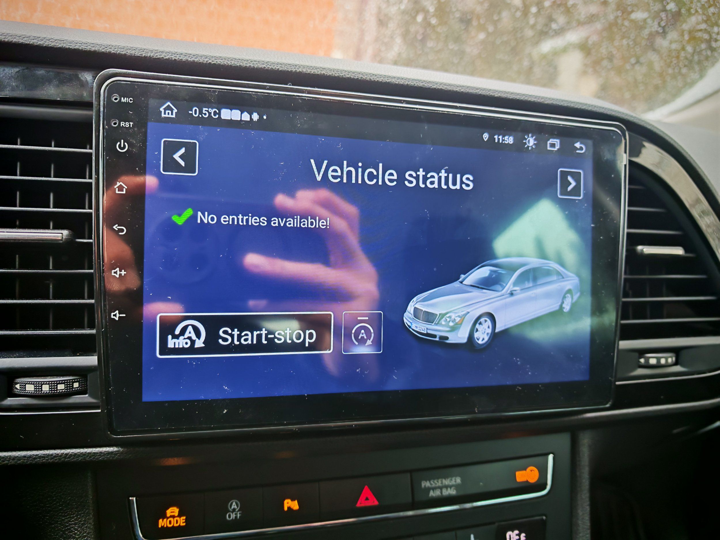

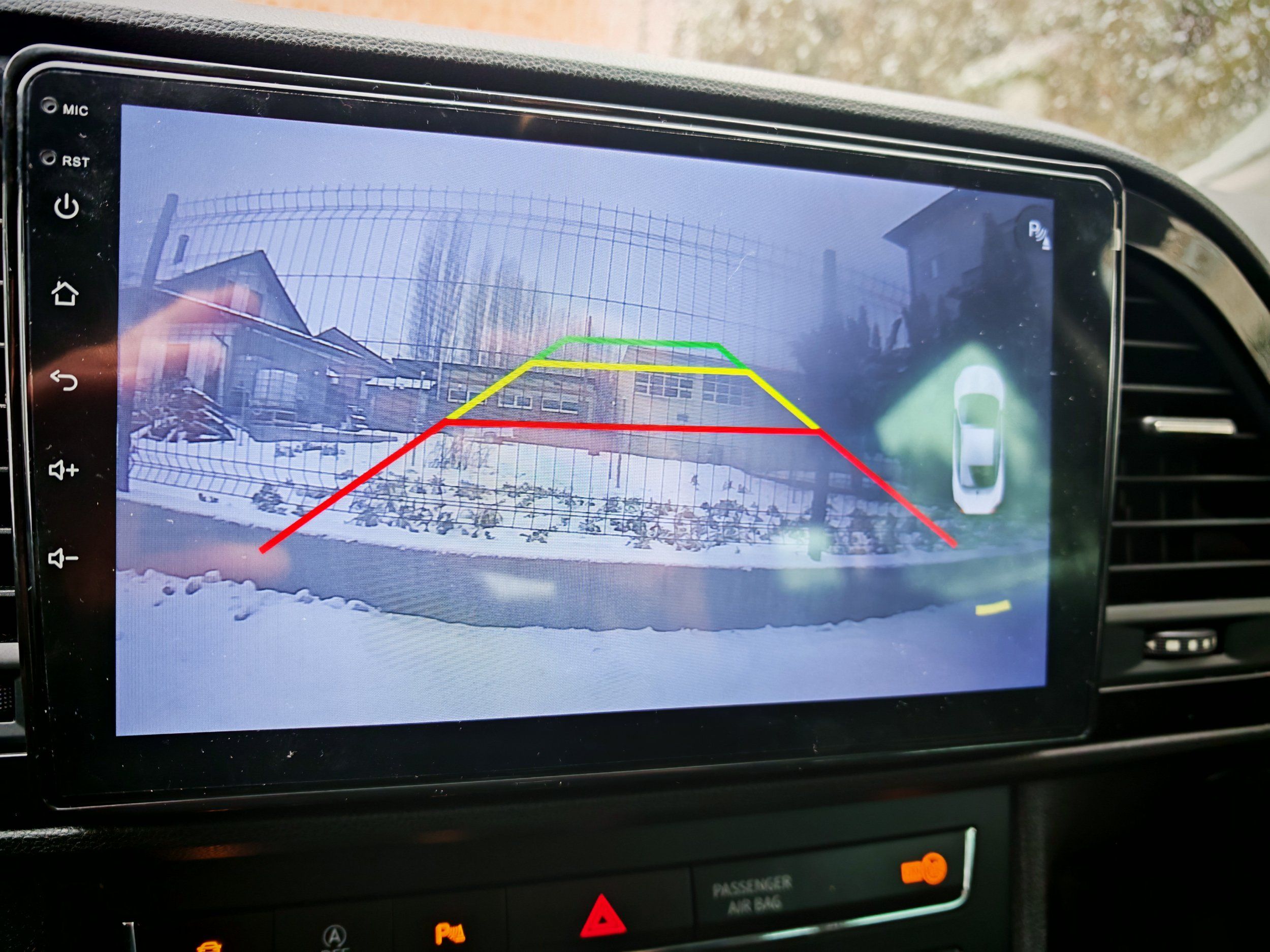

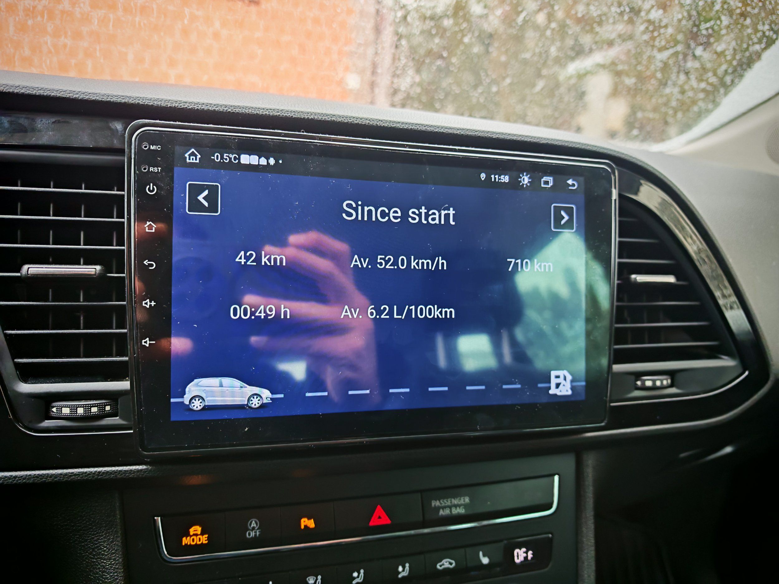

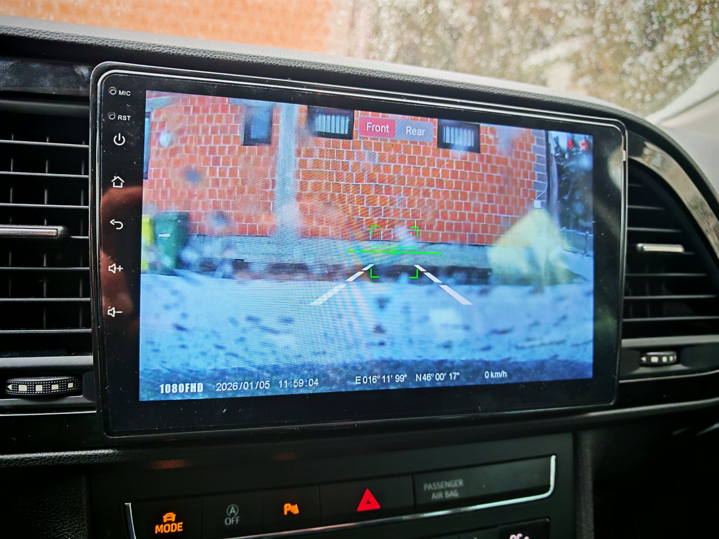

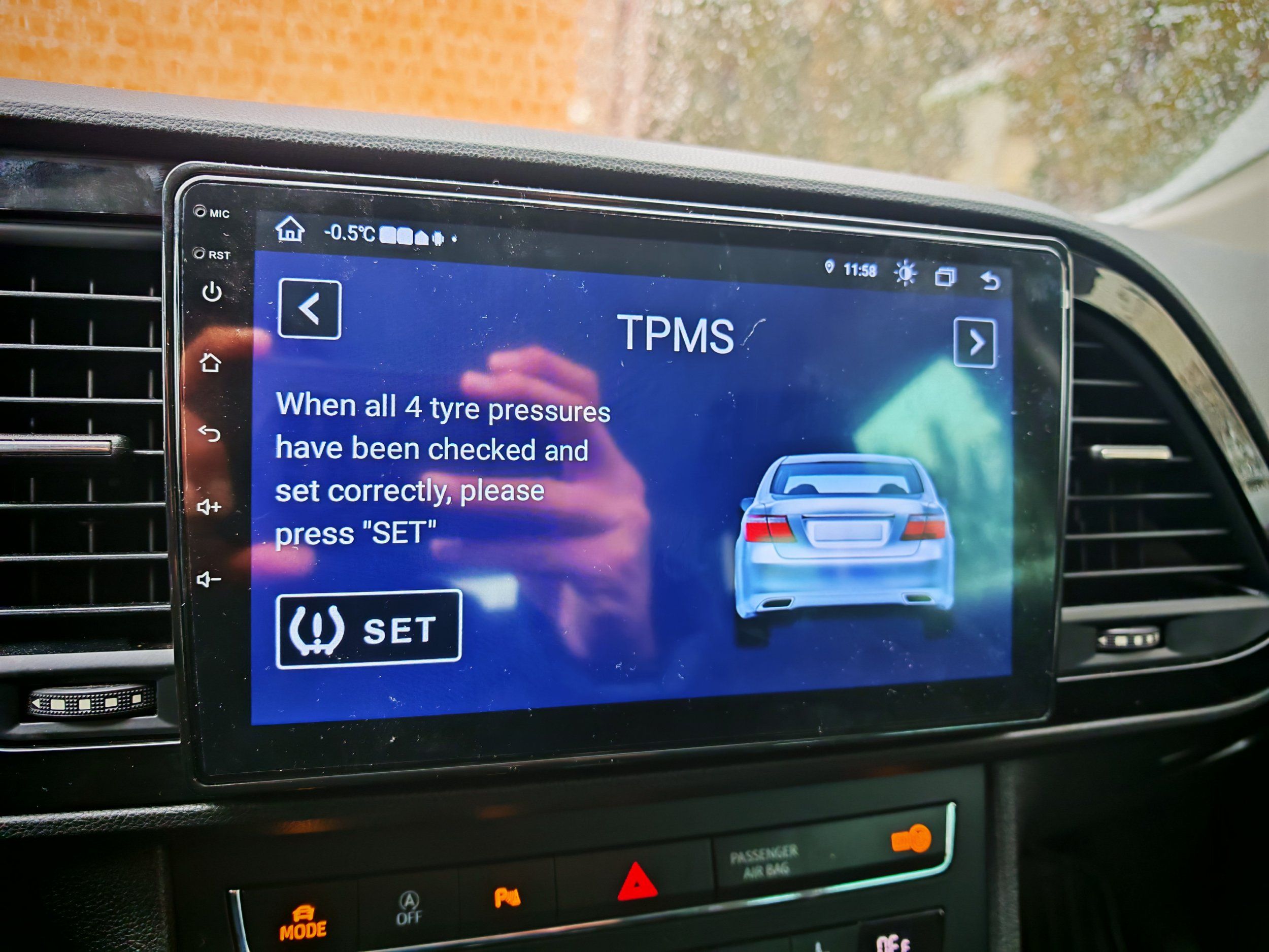

I am satisfied with the HU, for 213euro it exceeded my expectations. I bought a bundle with a front (with ADAS) and rear camera for Leon.
The unit is fast and works with no problems. All buttons are working, on the steering wheel, even the drive mode button below is working!
Subwoofer also works with a correctly set canbus module in settings.
The rear camera lights up on the display when I shift into reverse. Sensor display also.
I have a unit installed a few days ago and didn't drive much since then (hollydas..), but as far as I checked everytihing is working correctly!

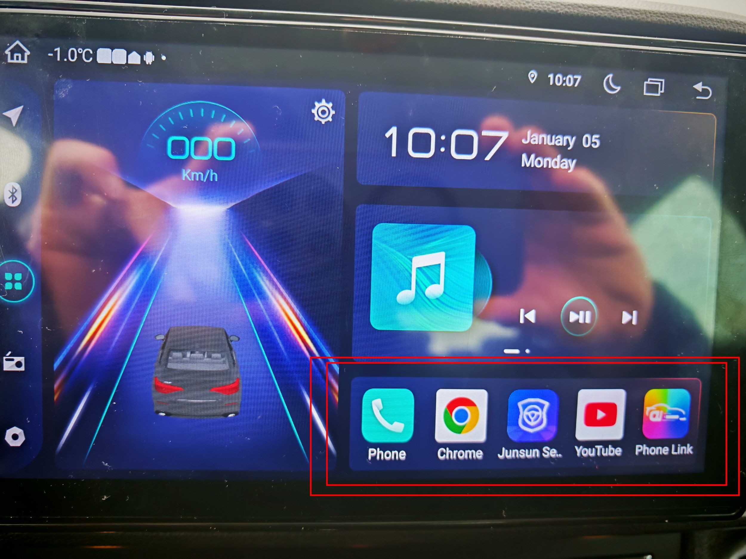

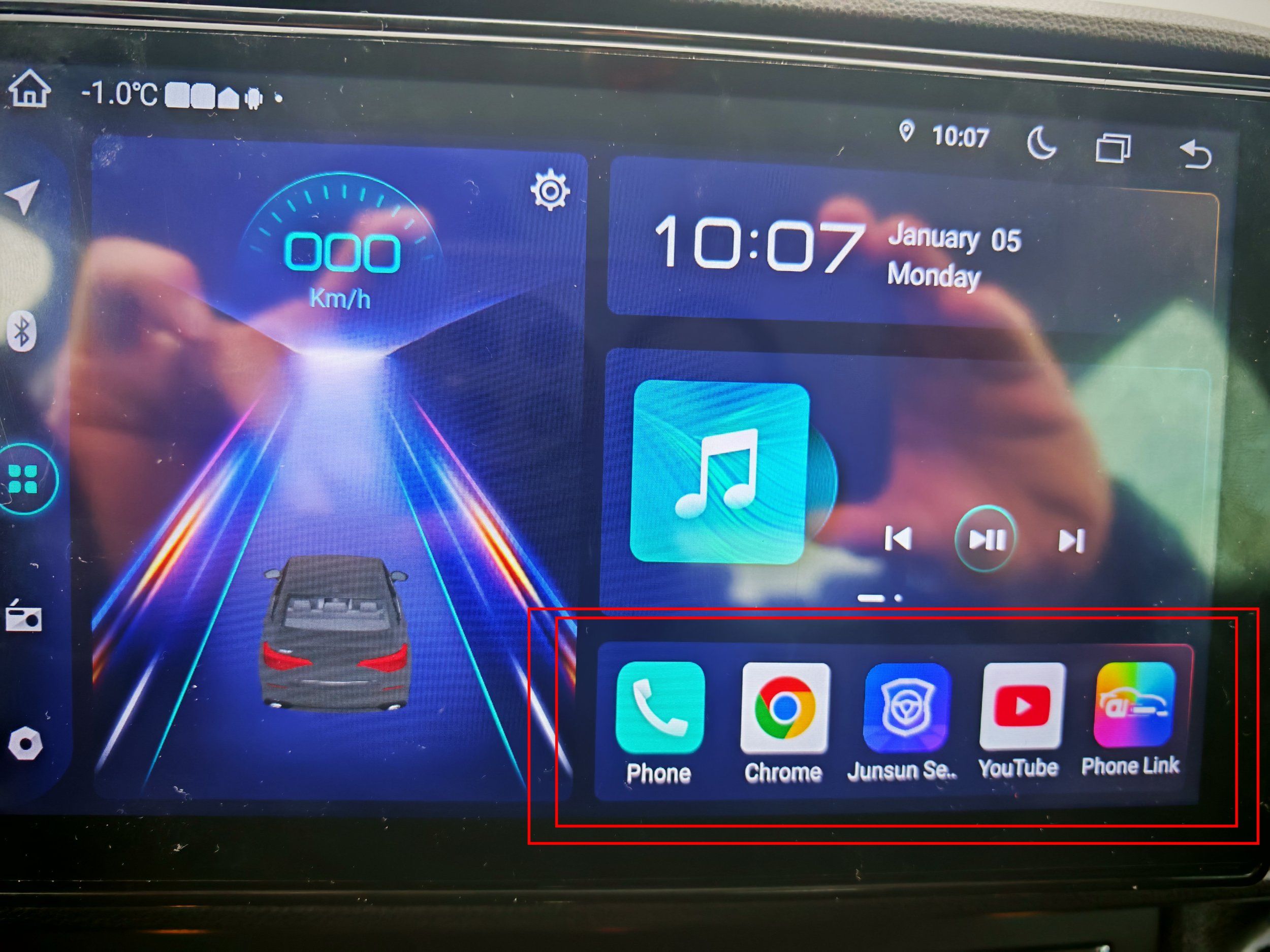

One minor downside is that the unit does not save custom shortcuts that I have set; it always reverts to the original set of shortcuts.
Awesome, thanks for sharing.
Which model/part number did you get?

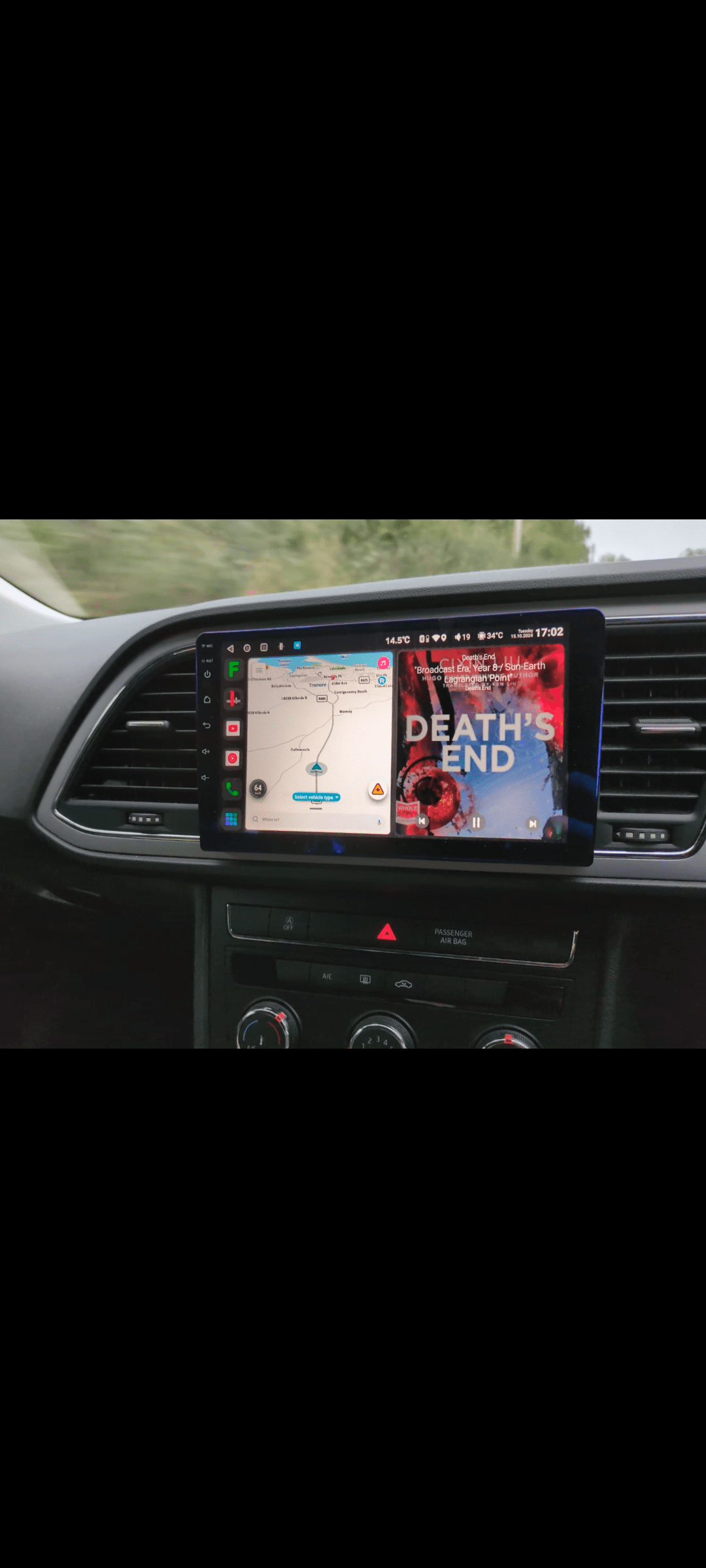

You might be able to install a custom frontend UI, look up XDA forums for your model type. Mine is a UIS7862 and I installed PeaceOS frontend. Looks way better than the stock frontend the unit it came with from EKIY and has custom shortcuts. It is a bit techy though getting this stuff installed but not rocket science either!
