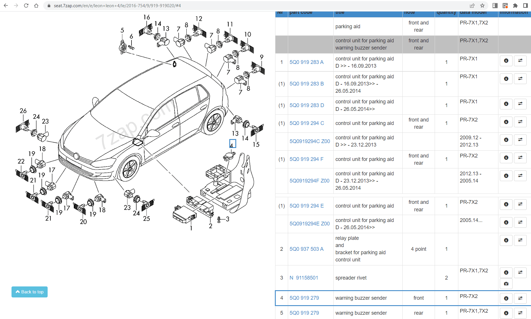

serdar_18fr Active Member May 29, 2021 959 1 707 May 7, 2022 #2 Parts catalog for Leon shows something like this. Not the exact place but it looks like somewhere at the left side, under the dash.

markh85211 May 7, 2022 2 1 May 8, 2022 #4 Hi,thanks, found it on top of fuse box,need to take complete glovebox out to get to it. Reactions: serdar_18fr
