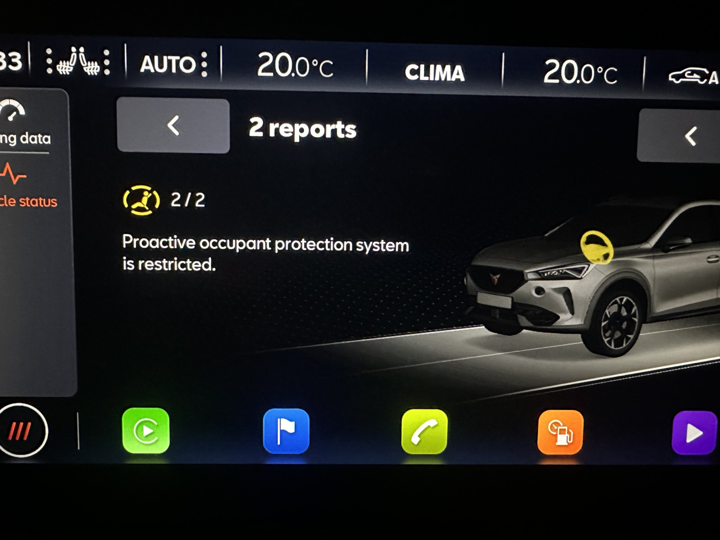

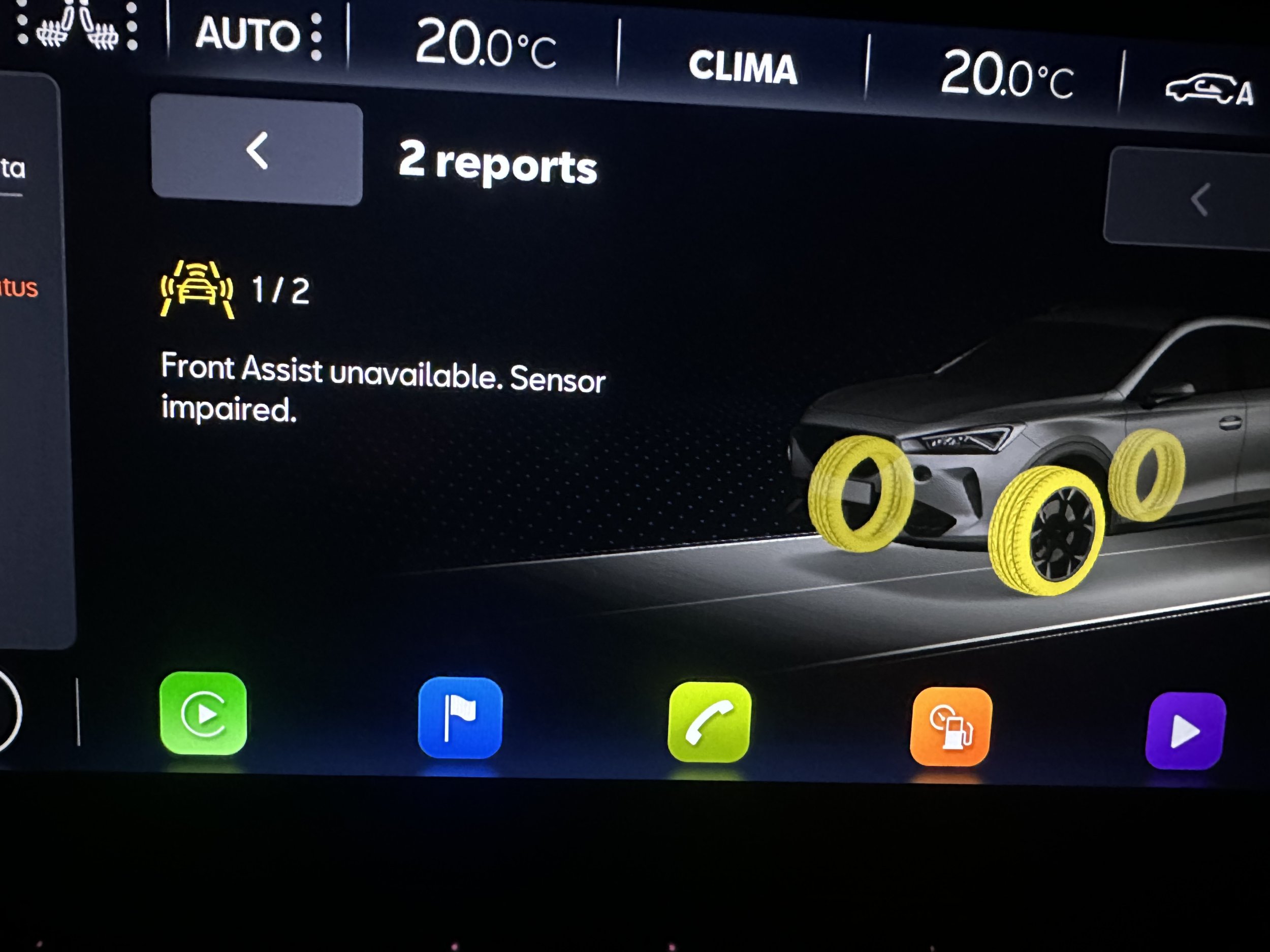

So I’ve just had a warning come up that my front assist is unavailable - sensor impaired alongside a proactive occupant protection system is restricted error. When looking at the front radar sensor I’ve noticed that there was a scratch along the top of it but it’s not something that has been an issue previously but now I have this constant error. I’d like to know if this warrants a replacement or if I can just fix it with a plastic scratch removal like meguiars plastx. If I do have to replace the sensor, will it need a complete replacement or just the plastic cover at the front as I understand these sensors are fairly expensive so I’m hoping cupra have some sense and the plastic can just be replaced. Oh and also, if I do need a replacement I’d like this to be a one time thing so ideally I’d like to protect it somehow, would some ppf be helpful or would that impact the effectiveness of the radar sensor

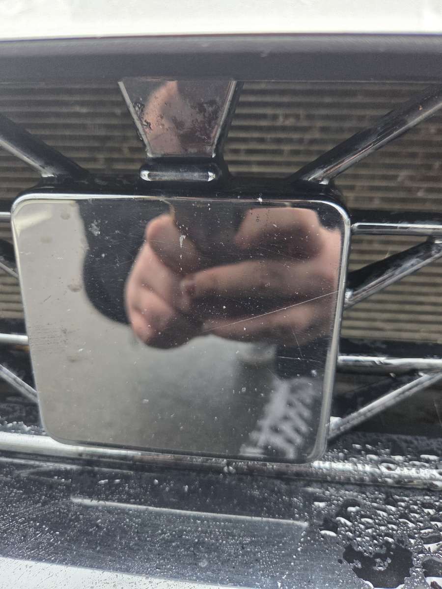

I don’t have an obdscanner but have purchased one so will plug it in tomorrow to check the code. I have attached the image showing the scratch and if there’s any other advice anyone can give on how else to check, maybe there is a cable I can reach around to see if it’s loose? I’d very much appreciate any advice so i don’t have to visit the consistently useless dealer
I would say that scratch will be having no impact on the function of the radar.

I will say as well, I’m 90% certain that these scratches were on the sensor since I purchased the car which was 7 months ago now and this is the first time these faults have appeared. I’ll attach what the faults are on the infotainment as well
It isn’t a plastic cover. It’s the complete lower grill. I highly doubt it’s the scratch causing the issues

It’s unlikely that the scratch (or scratches) are causing the issue as the frequency used by the radar module means the plastic cover is “transparent“ as far as the radar module is concerned. However, ingress of dirt or water into or on front of the cover would cause failure. It would be interesting to see what a scanner makes of it and the fault code(s) it reports.

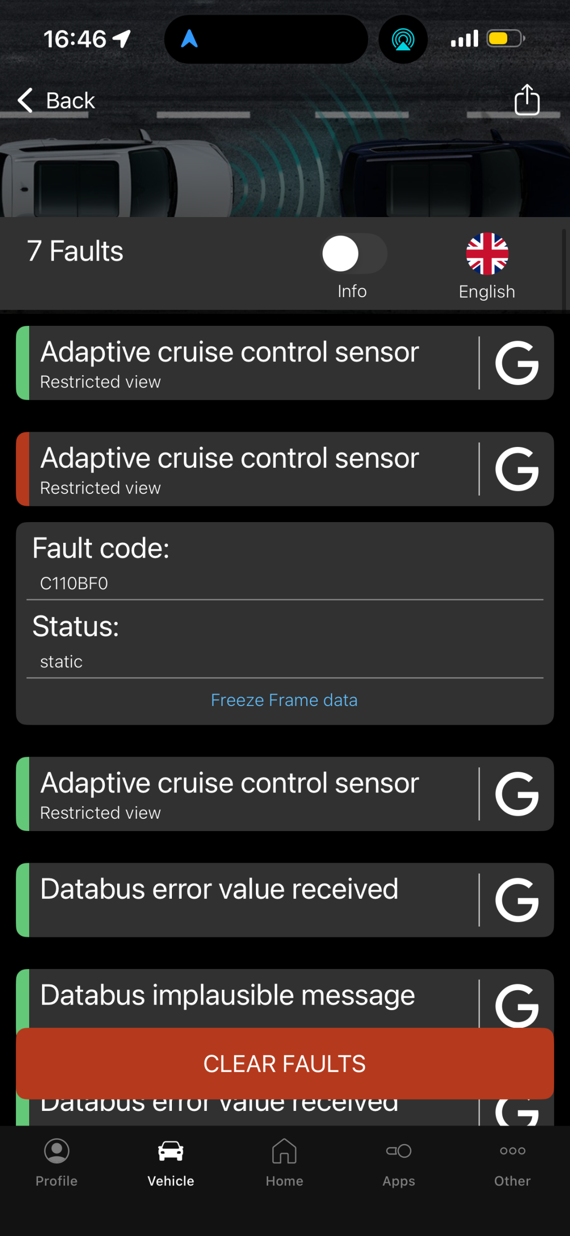

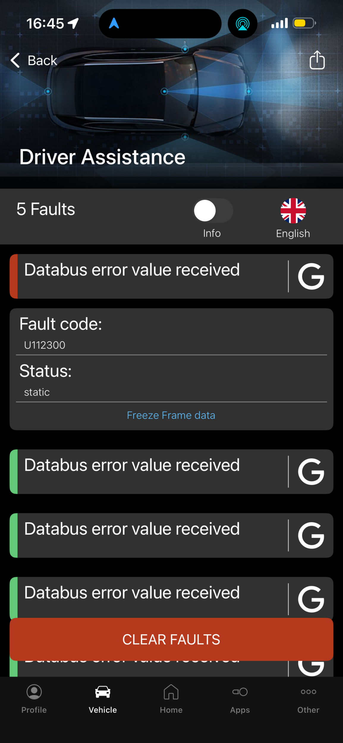

So after plugging in the obdeleven and clearing all of the errors these are the only ones that persist and my dashboard is still showing the same front assist unavailable etc. Errors. Does anyone have an idea as to what these codes mean and what I can do to clear them up?

No a scratch panel on the sensor won't affect it. It sees straight through that. Water can get inside them. I dont get it on the Ateca. Arona we do. Parked facing down a hill will cause it to get blocked in wet wezther. Weird one. Did it from day one. Once they dry out all is well. Obviously you haven't got any front assist protection or not within parameters when the warning light is on.

Calibration may fix things but the interesting thing is that the persistent faults are coming from the Driver Assistance control unit, meaning the camera on the windshield, not from the radar. A problem in some unit would definitely cause others also to throw faults but with no fault in the radar, not sure which unit is the suspect and may require calibration here.
Did you check the faults again, after you cleared them & drive 5 minutes & fault showed up on dash ? Still only those 5 persistent ones or also the newly thrown ones in radar too?

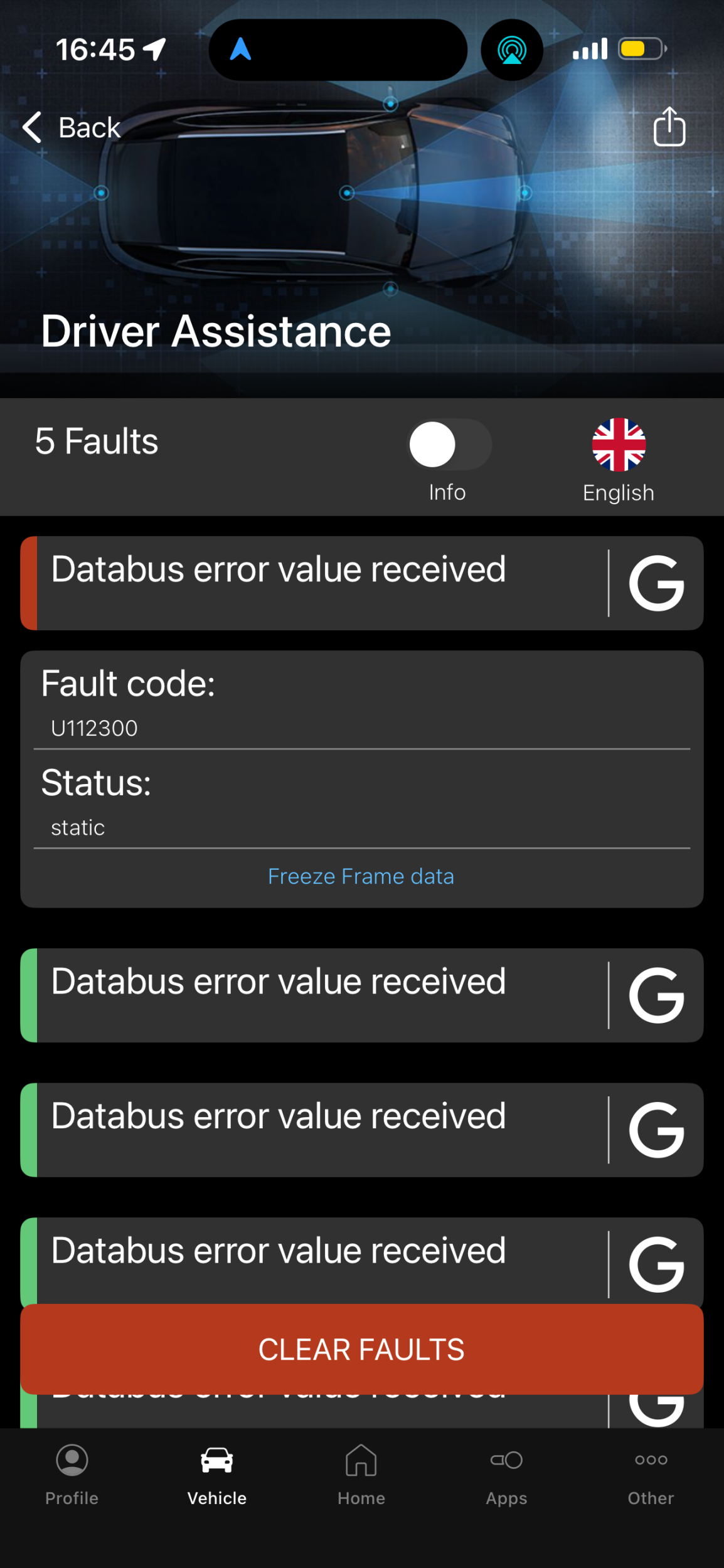

So after plugging in the obdeleven and clearing all of the errors these are the only ones that persist and my dashboard is still showing the same front assist unavailable etc. Errors. Does anyone have an idea as to what these codes mean and what I can do to clear them up?View attachment 50511
So there are no faults in any other modules? Nothing in the radar? These fault codes suggest otherwise
