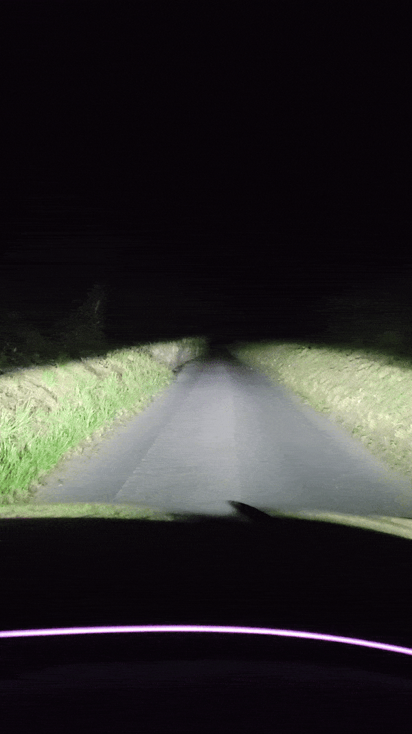

I have created a GIF that shows the issue on a country road with trees either side, which are not visible on main beam at all.

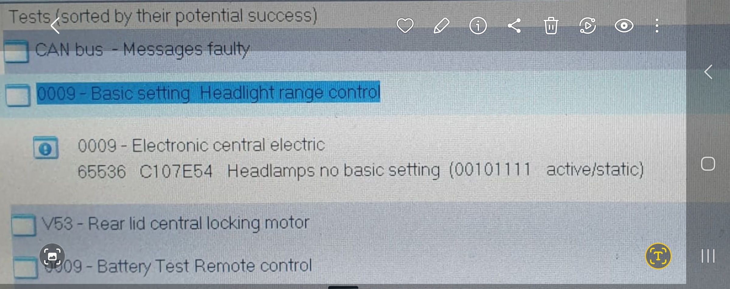

I took it to a friend of mine who hooked up his diagnostics to it..
It turns out that the vehicle was left in Headlamp Basic Setting (not finished)
Once he changed from basic to complete or finished that solved the issue.
The headlights now have a noticable raise in the lights when changing from dipped to full beam.
