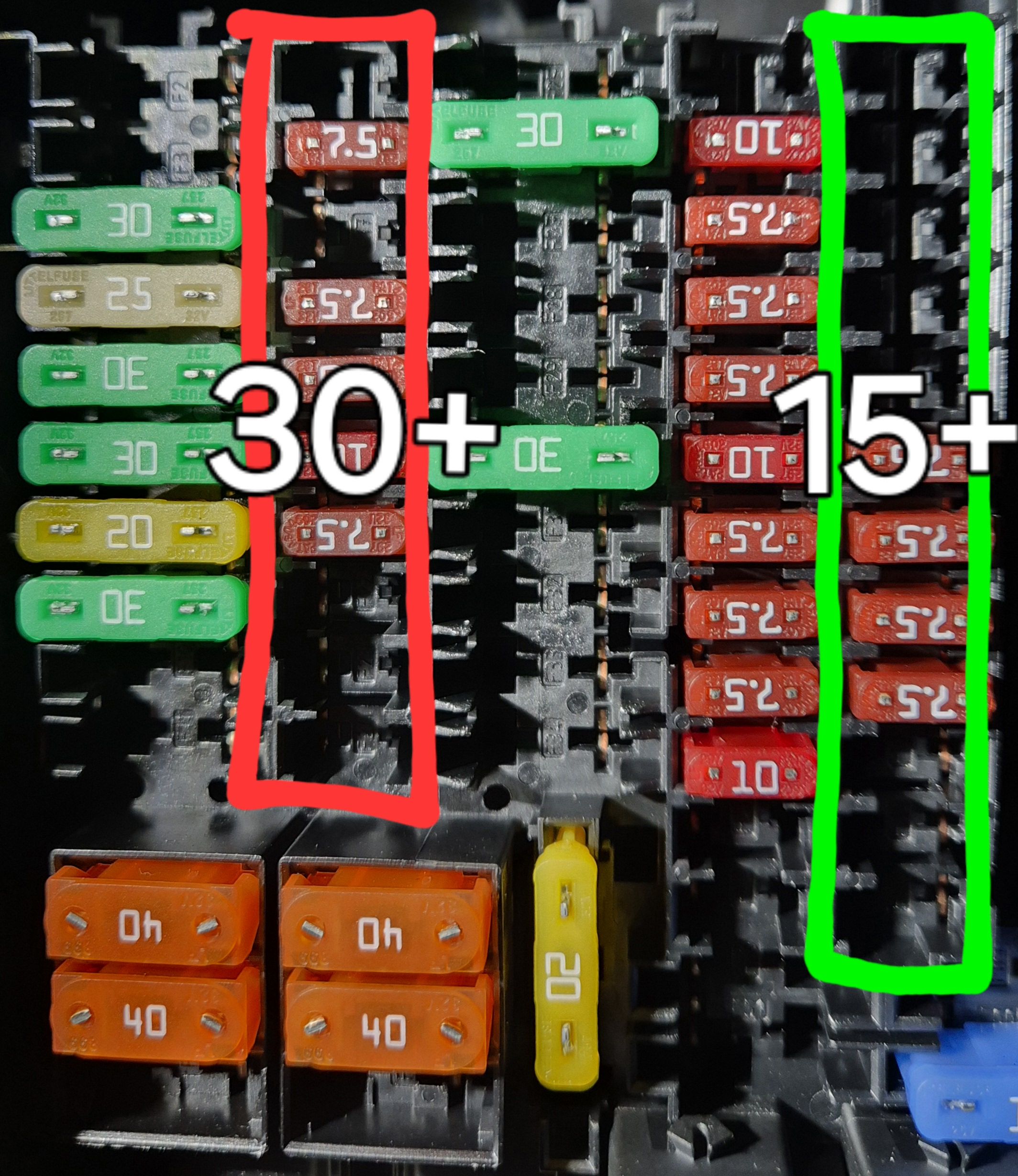

Fuse box - 30 is permanent live, 15 is ignition live.
Thank you for your response.
I also would like further clarification regarding which fuse slot I should choose.
Would you recommend selecting an empty slot that has power (although I understand that some empty slots may not actually be wired and would need to be tested), or would it be more appropriate to use an existing slot such as the USB charging fuse?
Also if I use an empty fuse slot, would I only need to install a single fuse for the accessory? Correct? Two fuses are required only when piggybacking an existing slot , meaning the original vehicle fuse plus the new fuse for the accessory, as shown in the image.
Could you please confirm whether this understanding is correct?
I would appreciate your guidance on the safest and most appropriate option.
Do you have any recommendations regarding which fuse slot I should use — an empty slot (if powered) or an existing/used slot?
I would appreciate your advice on the safest and most appropriate option.
