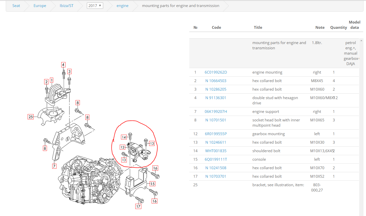

Yes I do think that mine is different...
it is this one -

Yes slightly different as expected but the procedure is still the same, ie replace all bolts that you need to take out and for you it probably means the console bolts as well as you might need to remove the mounting/console combo as one part then swop over the new mounting.
