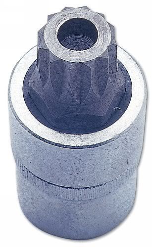

I did have a search, found a bit of information, but basically was wondering if someone could tell me what is required to change gearbox oil on MK1 LCR?
Think a spline socket is required as well? But not sure which one?

Its an M16 security bit if you need it, the other plug is a 14mm hex :)
