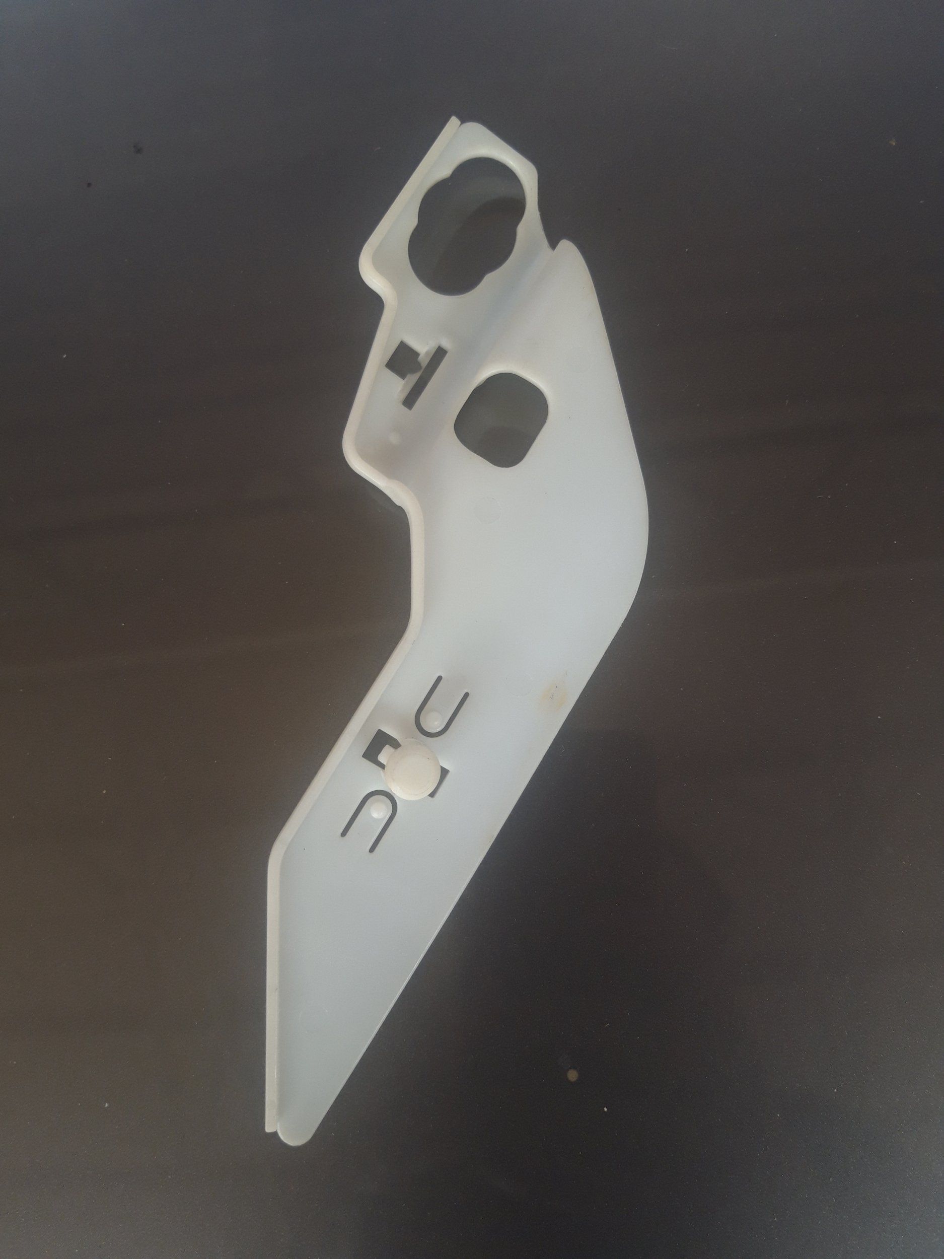

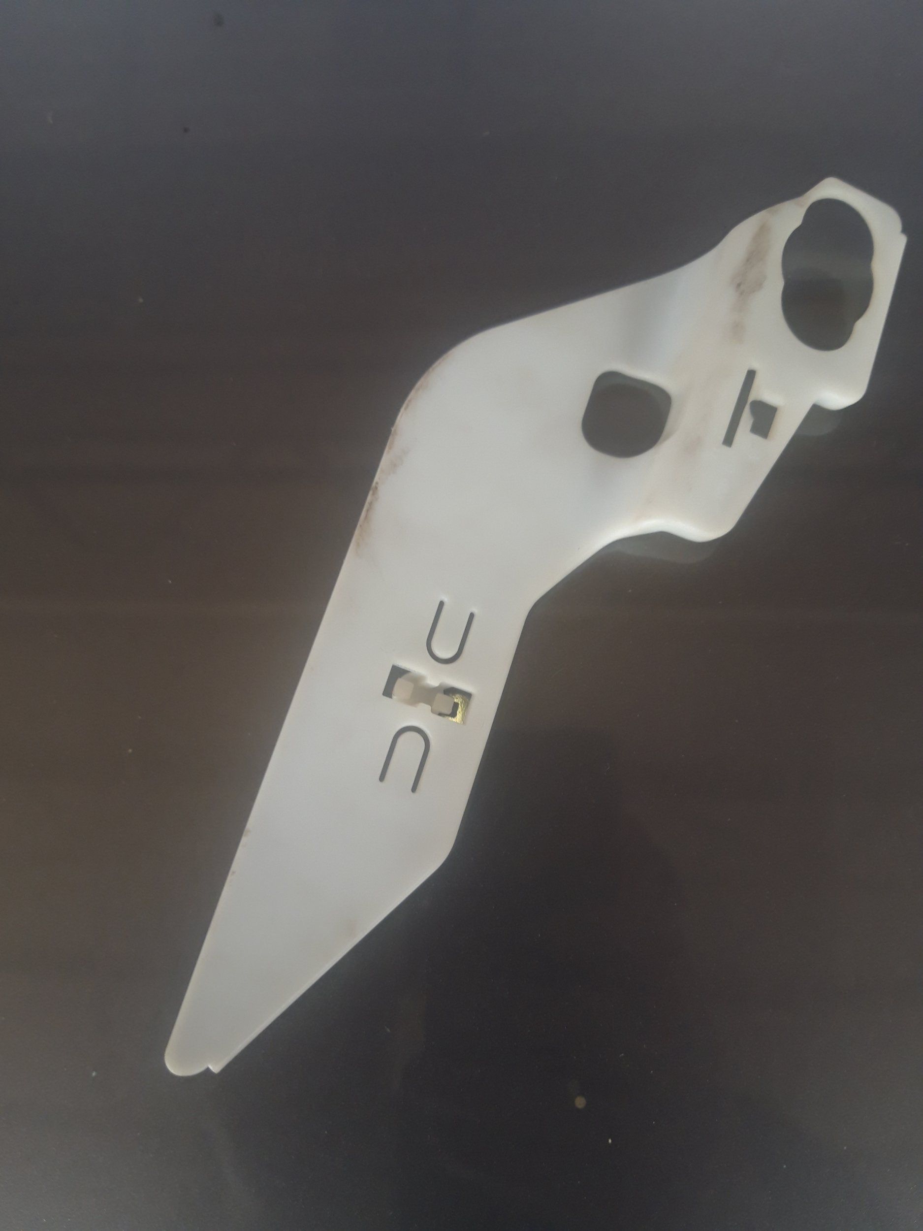

Just replaced the fan on my car and took the glove box out to get to it.
When i lifted the glove box out a piece of white plastic fell out.
Can not figure out how it attaches.
Anybody know?

Seems a piece from the ventilation shaft. Have you tried to open/close the interior air induction to see if it works?
Yeh, everything seems to work ok.
Im thinking it goes between the glove box and the end of the dash.
But i tried loads of configurations yesterday and it didnt seem to fit anywhere.
