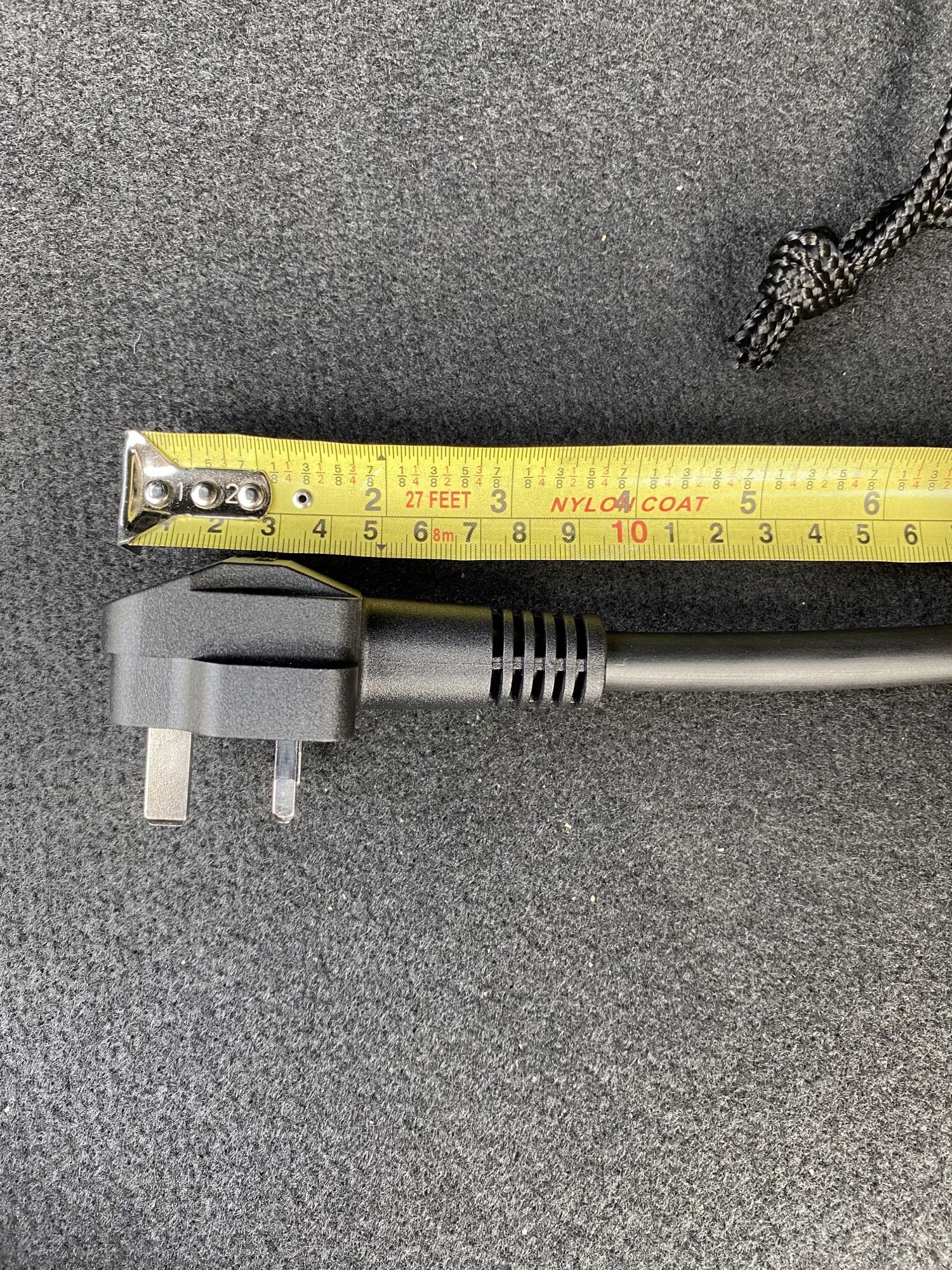

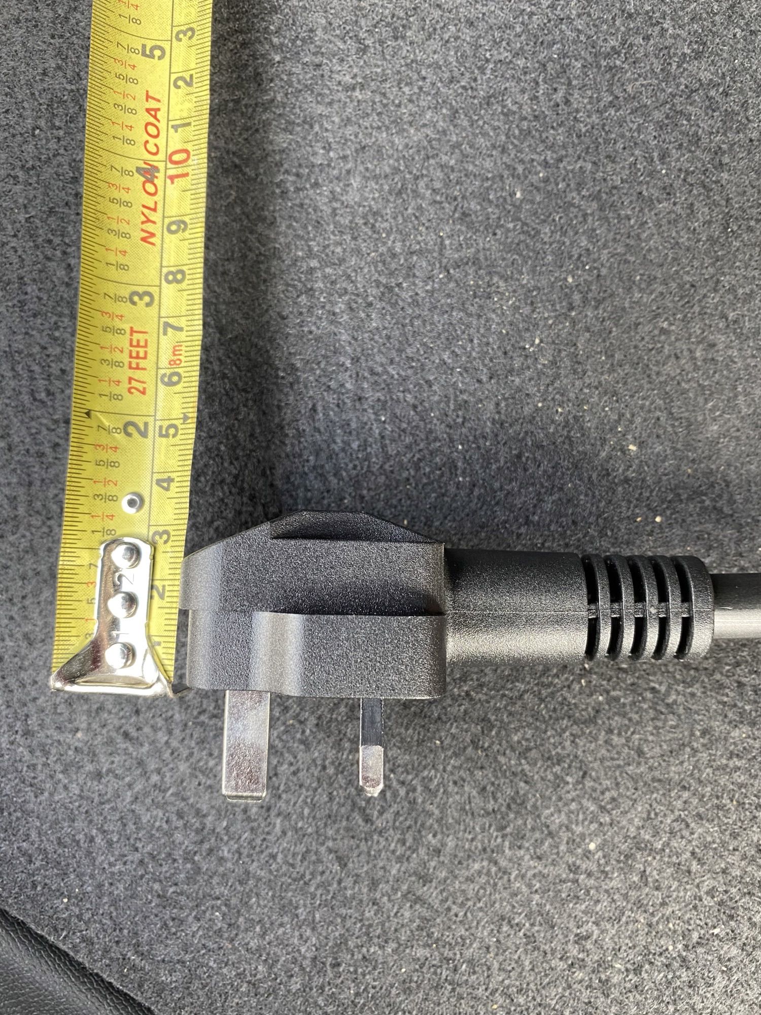

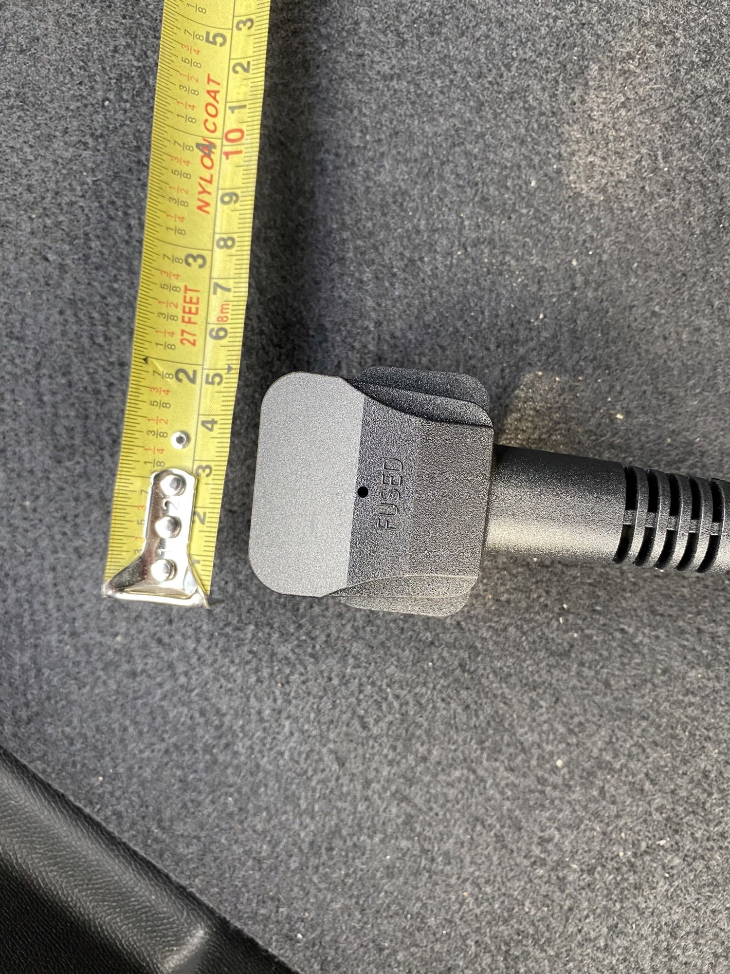

Hi All, a question for PHEV owners.
What is the depth of the plug on the Granny Charger that comes with the car please?
I am having a proper charger installed but to charge the car until that is installed I am having a dedicated 13Amp socket installed beside the overnight parking location. I want to make sure I have a socket installed that permits the cover to close when the unit is plugged in. The question is, is the plug the same dimension as a standard 13A plug or is it slightly 'fatter'?
Thanks in advance
ES_Formentor
Sep 30, 2021
36
32
To answer my own question have managed to get the dimensions from the Cupra Dealer who provided the attached pictures. I have since sourced a waterproof socket and enclosure from my local electrical merchants which has sufficient clearance to latch shut with plug connected. Several I looked at were not deep enough.
