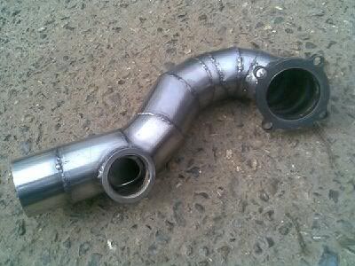

got myself a tan this afternoon tig welding it together. Been a long while since I did some Tig... back purged welds full penetration, happy with them. The technique is returning.

3" does go into an ibiza, mk4 is more room.
Tim should get hold of the 1D and 1.5D 3" dairy fittings to save the cut n shut. Nice flowing route and less welding req'd

Out of interest, I was under the impression that the wastegate should discharge with the flow of the exhaust rather that against(ish) like yours?
its discharging @ 90' to the flow, but given there is no space for anything else, this is used by many people without any reported issues. Purist in me agrees with you, practical head says it fits where it touches.
What you dont see inside is a deflector in that little stub pipe to direct flow where I want it downstream. ;) I had given it some consideration. :)
