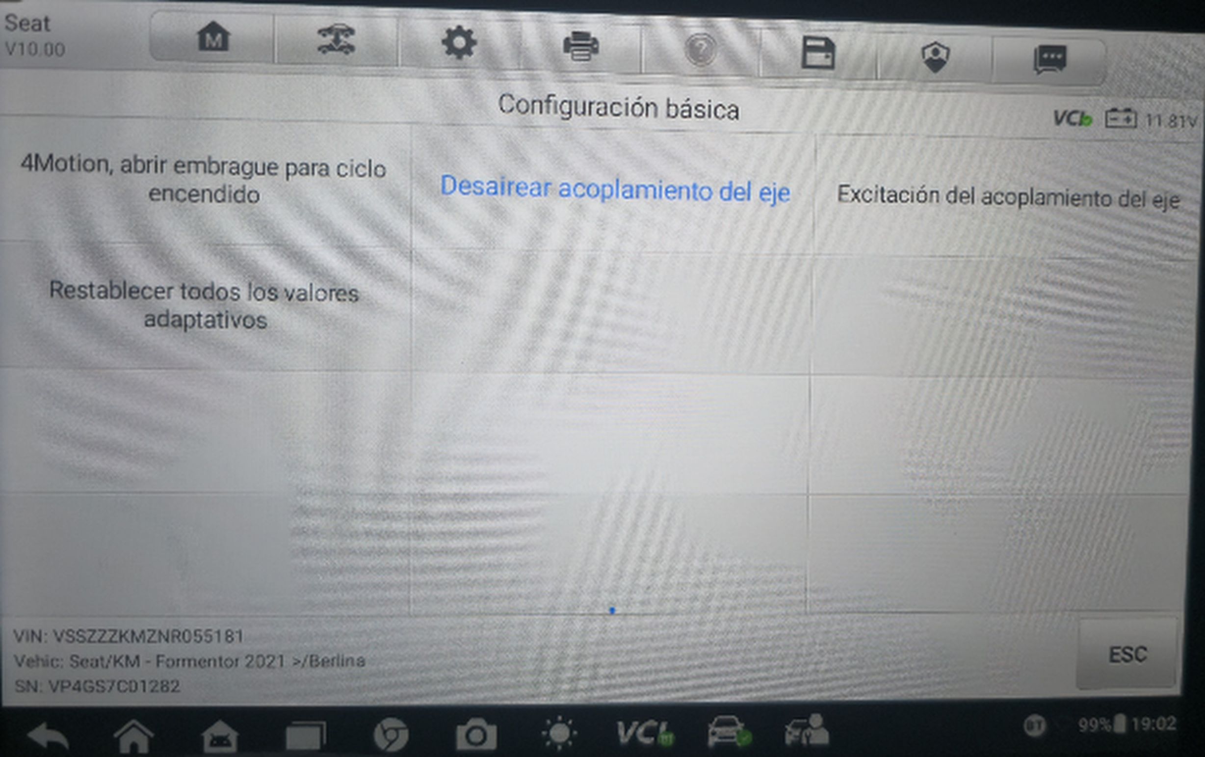

First of all, using ODB11-Pro plan does not (at this point) support Live data for All wheel drive, as well as pump calibration function. Already in discussions with OBD11 support team. Meanwhile this operation can still be done via VCDS.

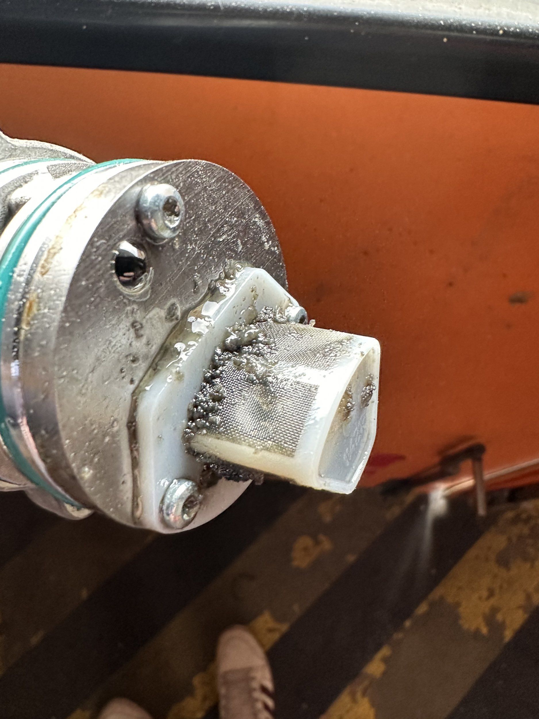

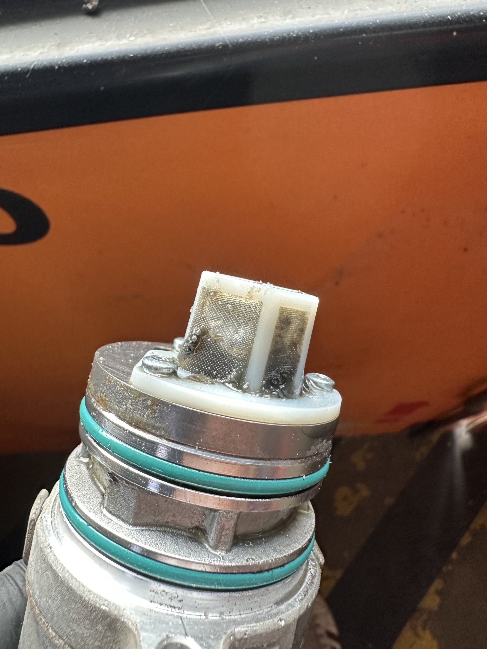

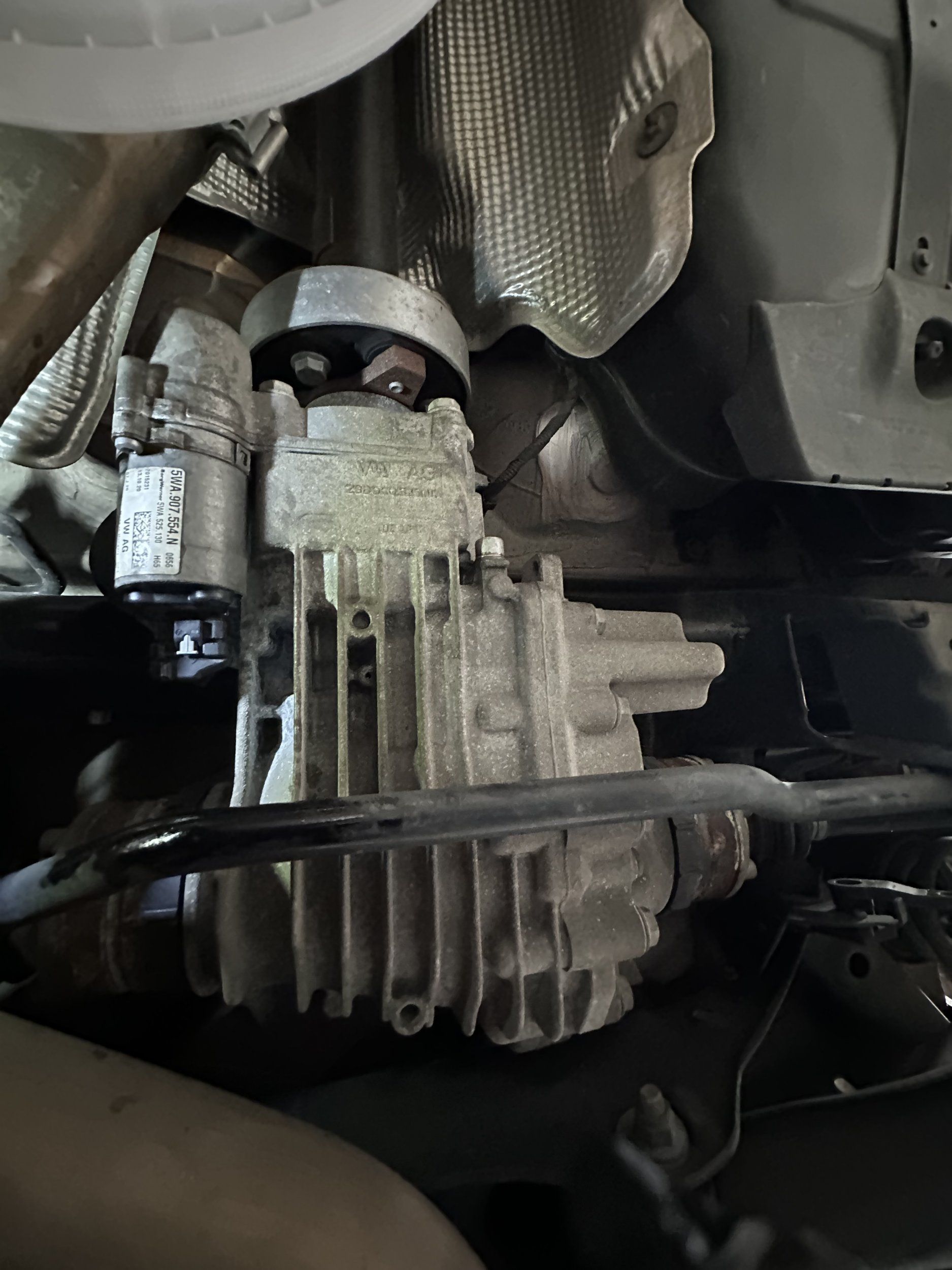

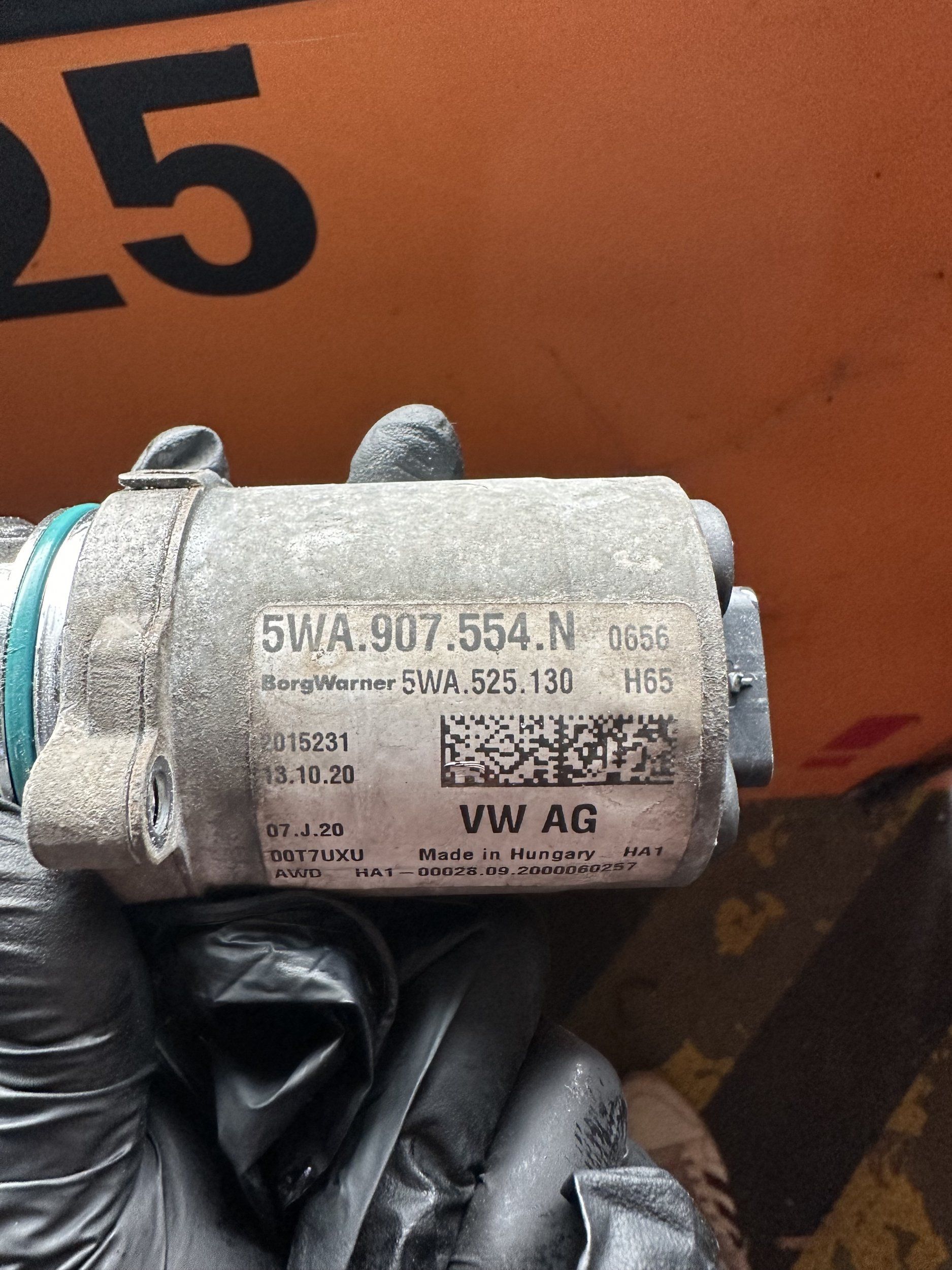

Of course the Haldex had to be different than any other car I’ve seen, perhaps because Formentor is built on MQB-evo as I wrote in my previous post, and that “evo” at the end means there are quite a few differences to the MQB platforms.

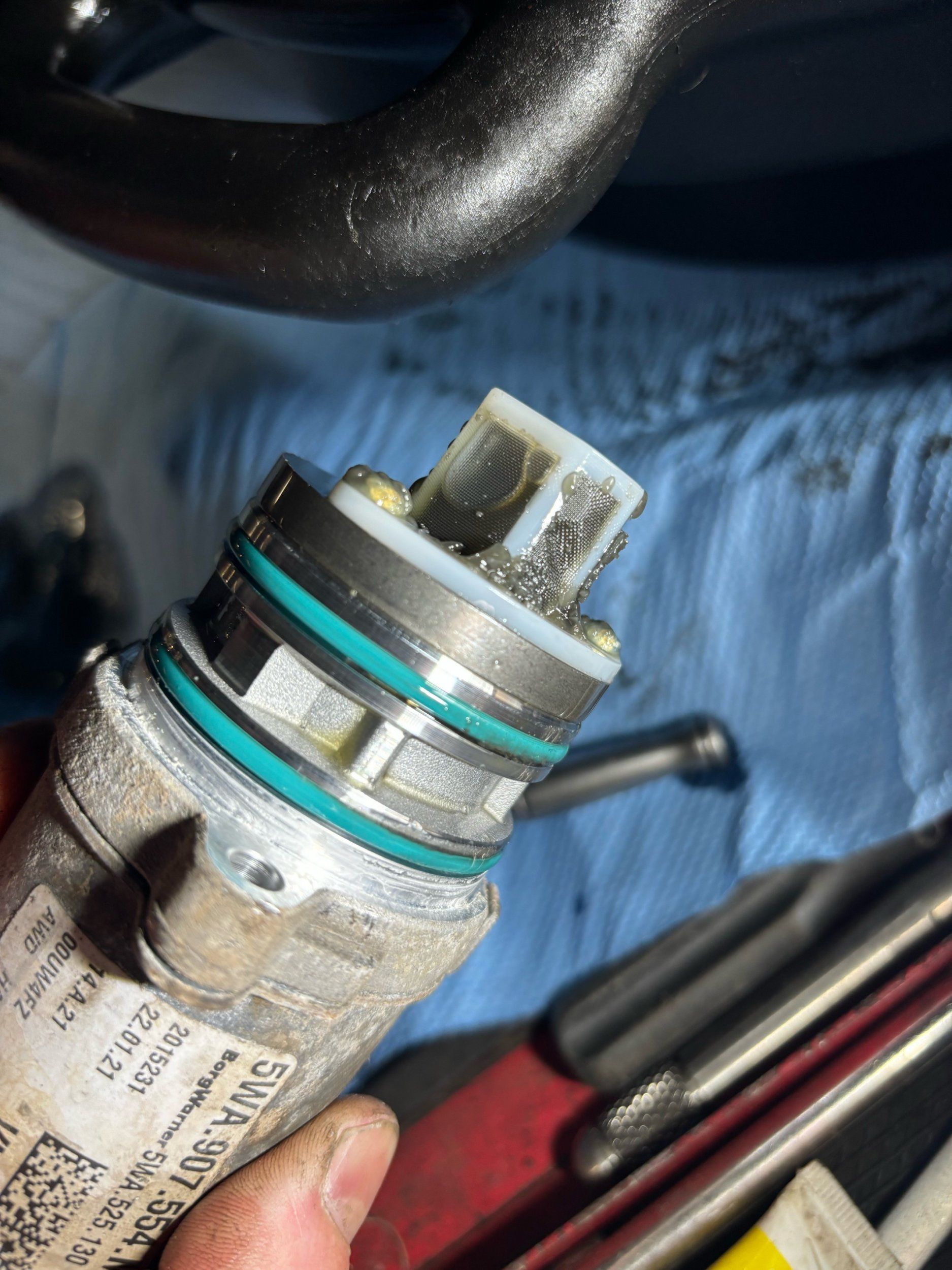

Anyway I did the maintenance, by taking out the oil and then the pump, which had a clogged filter (car has 60k km and no Haldex maintenance was done), had to use compressed air but also brake spray to clean it properly.
Unfortunately the spare parts I ordered for the Haldex pump are not compatible ! So I had to reuse the old o-rings (which looked good) and the old screws. I’ll be changing them next time.

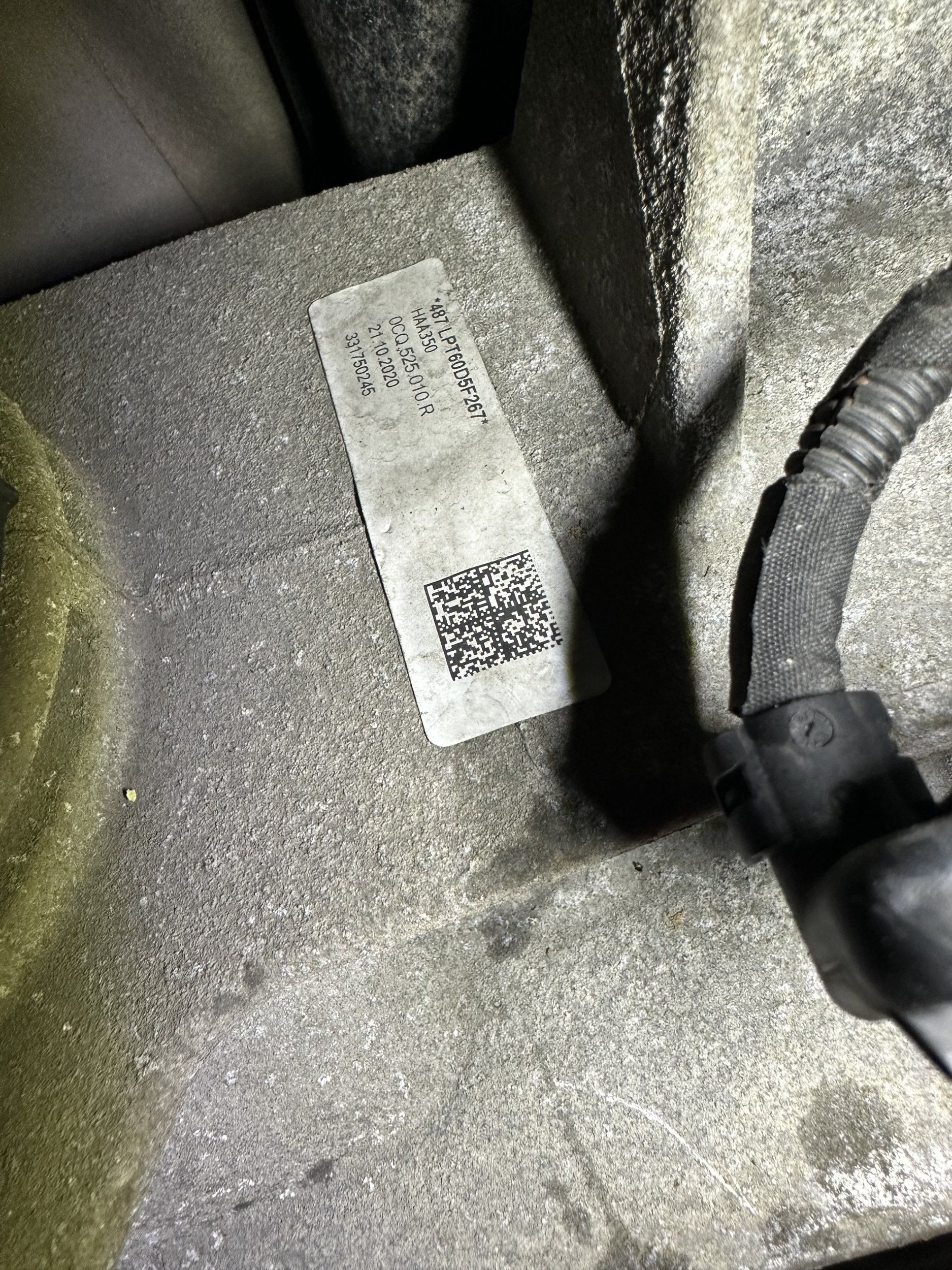

Few photos with the pump, pump lable, Haldex unit and its lable.
PS: OBD11 does not support the pump relearning process as of now ! “Perks” of owning a “new” car.

O rings are often good for several repeats, a little lub to get it sliding into place and nothing to stick/tear like gaskets. Do/can you run a little oil through the box to flush any sediment out before refilling, just in case all the ‘gunge’ is not stuck to the filter but lying in the bottom?
Reactions: dan.cupra
Yes, that’s possible if you have more than 850ml which is the amount of one bottle…which is quite expensive btw. I didn’t do that but I would do the Haldex maintenance more often than the manufacturer recommends.

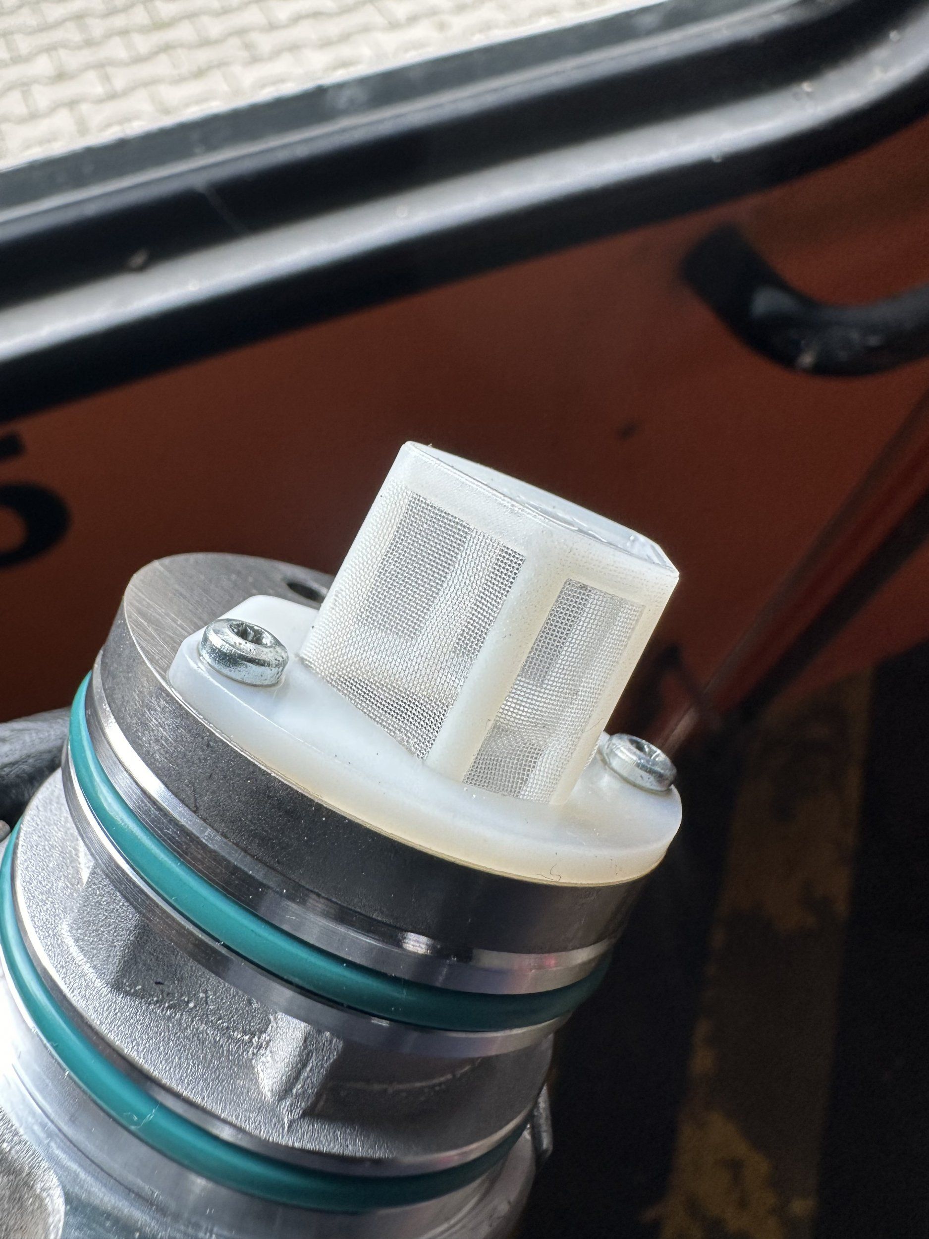

Just got my Haldex sorted for another 18k
Before cleaning
And after
all done book stamped, sealed up n done with no fuss by Myles at VAG tech in Waterlooville Hants.
Very Happy Customer ?
