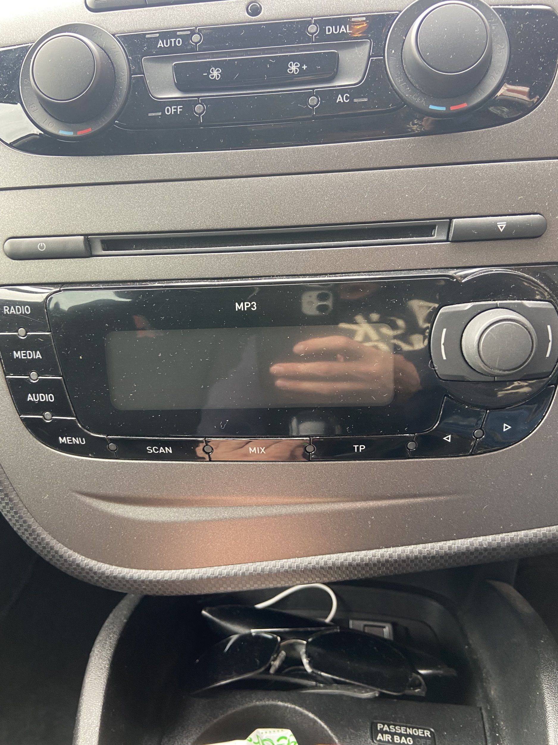

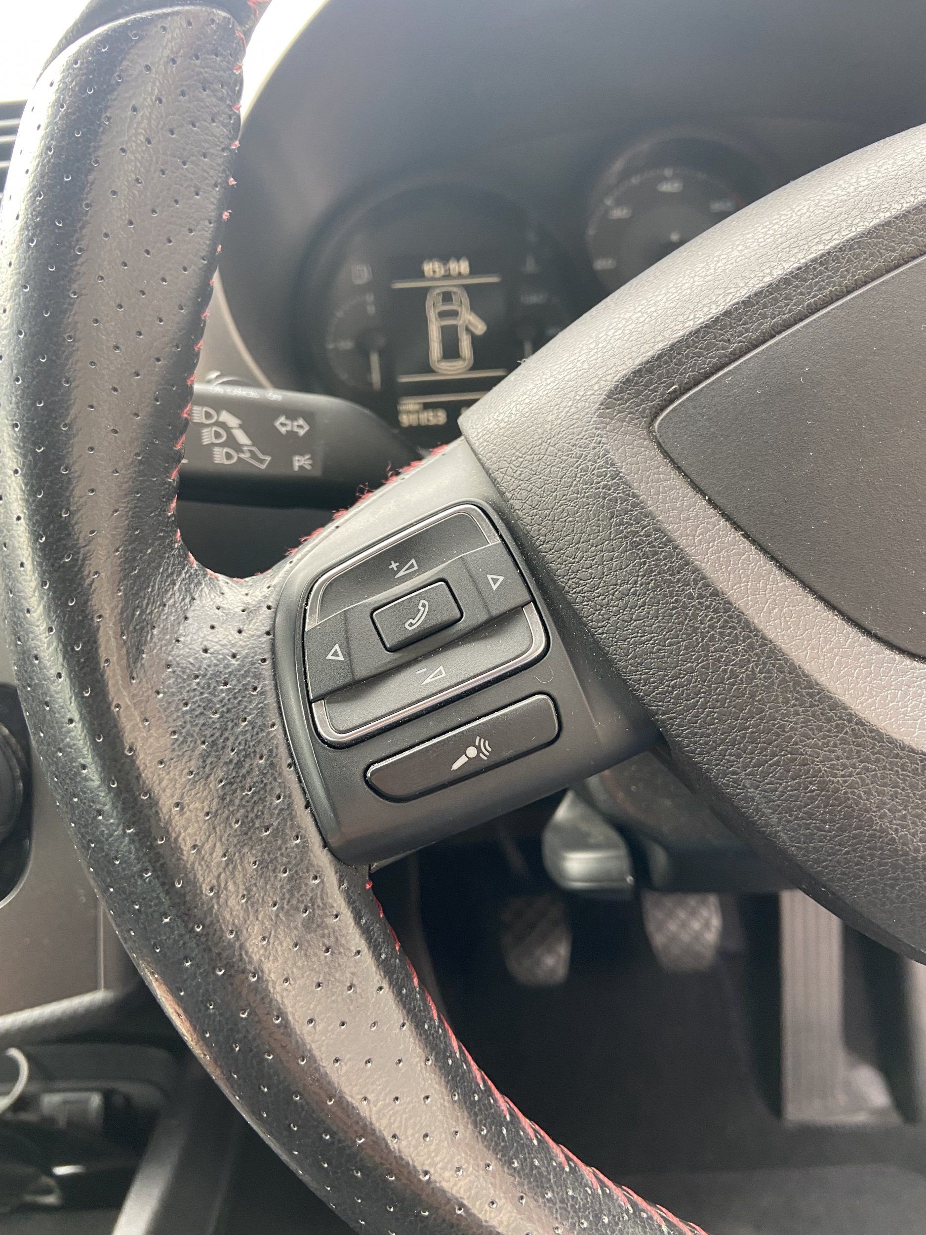

Afternoon people I have got a 2008 Leon fr diesel, but I can’t seem to find how I can connect my phone, I have the phone button on the steering wheel and I have got the the dashboard menu but I can’t see nothing about Bluetooth. Any help would be great thanks.
Some pictures that might help

As above you have a facelift MK2. If its the same as pre- facelift 'and you have Bluetooth' you simple turn Bluetooth on on your phone and you will get a message on the MFD asking you for the code to connect your phone, try 1234 or 0000. (first time only) And that's it.
Press the phone Button, you will here a dong then say, 'dial number', you will then be prompted to read out the number which will be repeated back to you, then say dial'.
I don't use mine much but when i have its one of the best I have used, little tip when you read out the number read it in chunks rather than 1 number at a time it likes that much better. E.g. first 5 numbers then 3 sets of 2 if its a mobile. The system will repeat the numbers back to you when you pause. If its misheard say 'cancel' or 'back'. If all is well say 'dial'.
