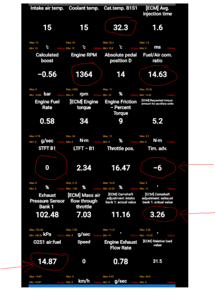

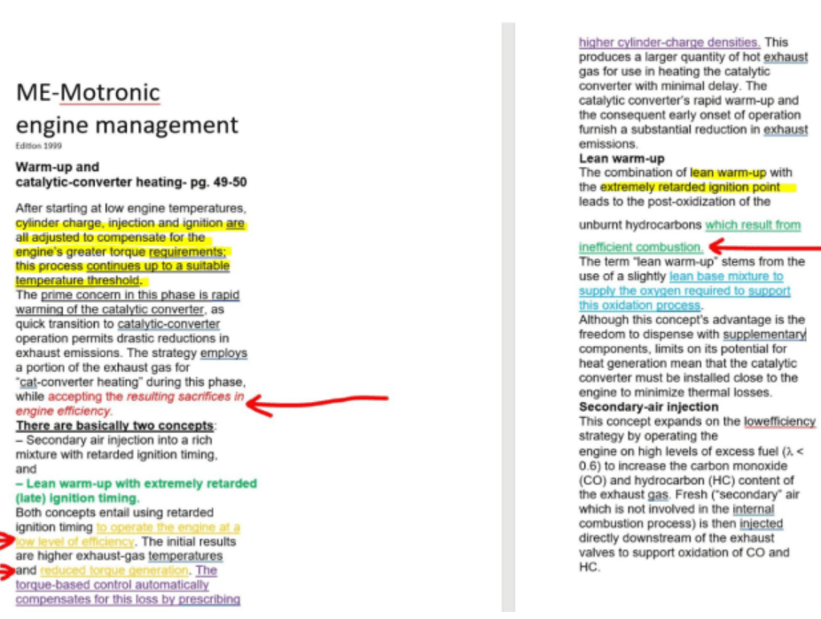

the difference between 1.4 and 1.5 is the stroke, it has the same bore.
another main difference is the injection pressure, in the 1.5tsi it is 170-350bar in order to be able to have up to 5 injections per cycle.
in the 1.5tsi the kangaroo is much more present, below is the cause:
