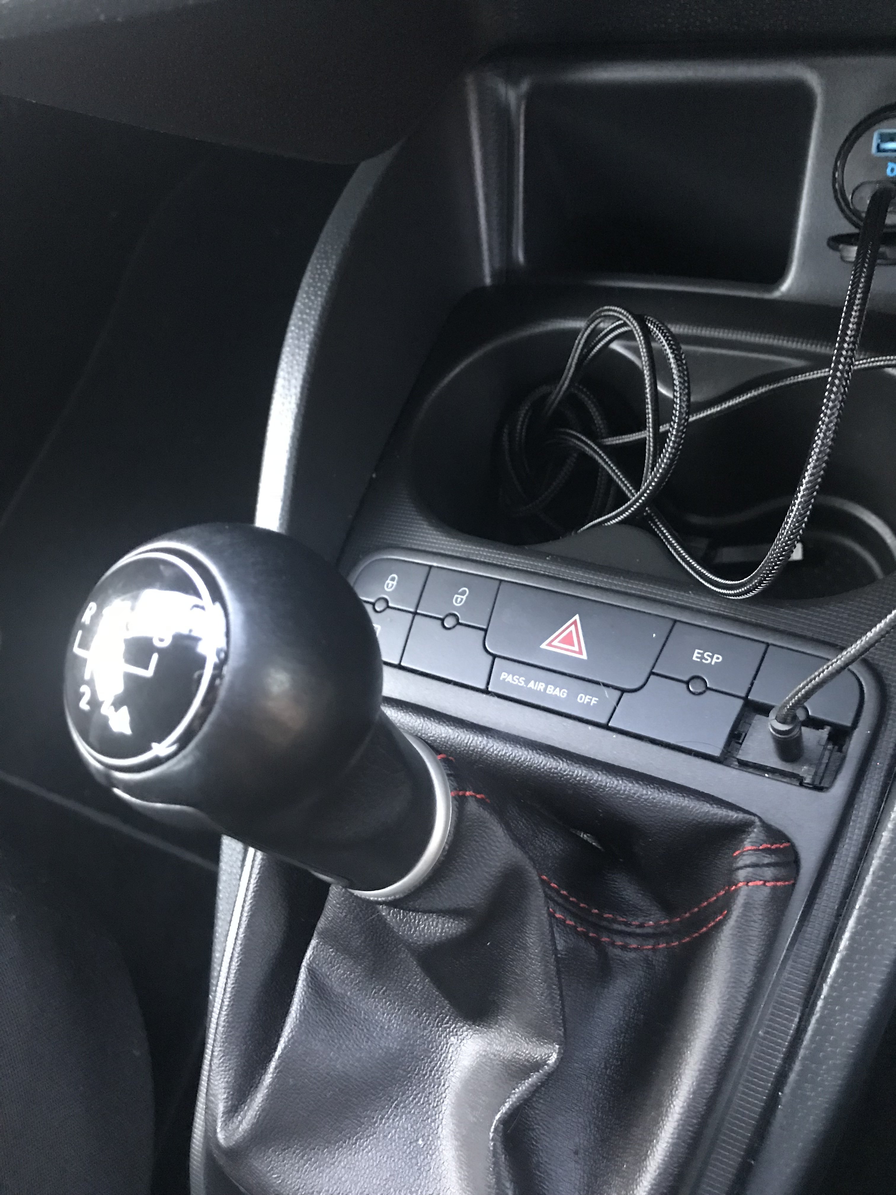

My car has a esp button:
So does this confirm I have Hill assist ? Do I need to press the button to active it or not at the start of a journey?

ESP is traction control and has nothing to do with hill assist. Hill assist is on my default and you will know if you have it simply by testing. When you're in neutral on a hill with your foot on the brake, select first gear and bring the clutch slightly up. when you let go of the brake, the hill assist will engage and hold the car for a second or two so you can find the biting point. If you roll straight away, you do not have hill assist.
