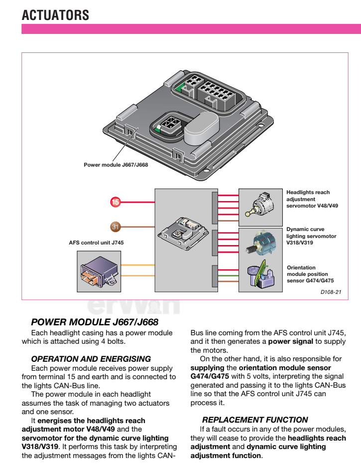

AFS CONTROL UNIT J745
To access the diagnosis of the AFS control
unit J745, it is necessary to select the address
word 55 whether using the Guided fault finding,
Guided functions or Self diagnosis option. The
most important operations are shown below:
SELF DIAGNOSIS
DIAGNOSABLE ELECTRICAL
COMPONENTS
Using the option, “Electrical components
for automatic headlight reach adjustment”
the following components governed by the AFS
control unit J745 can be checked individually:
– Level sensor G76/G78.
– Headlights reach adjustment motors
V48/V49.
– Dynamic curve lighting servomotors
V318/V319.
– Orientation module position sensors
G474/G475.
– Power module J667/J668.

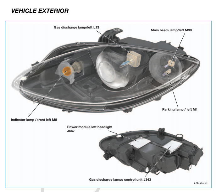

Well, this cost me a leg n an arm to fix. Can't get a good picture of it, but the power unit literally had the soldered legs corroded together from the water ingress. They are >£300 a piece. Then had to have a brand new headlight as the seals were gone on the old one and water would just leak back in again. There goes another £570. But all seems to be well again and AFS / autolevelling confirmed as working. Cheers for the advice and diagrams.
