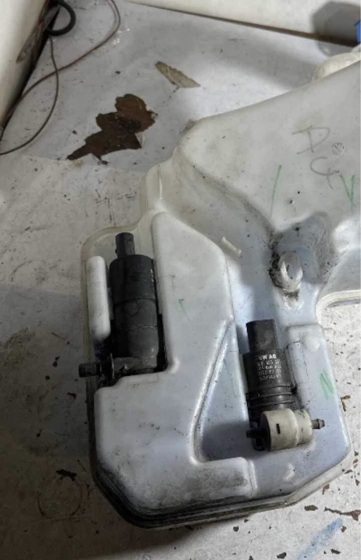

Hi all, I have a 2104 SE and I am currently doing a full FR upgrade. I have the FR front bumper and it has the headlight washers on it (both jets and cables are attached) I am getting the washer bottle with the pump for the headlight washers attached. Does anyone know what is involved in wiring the pump in for it to work?

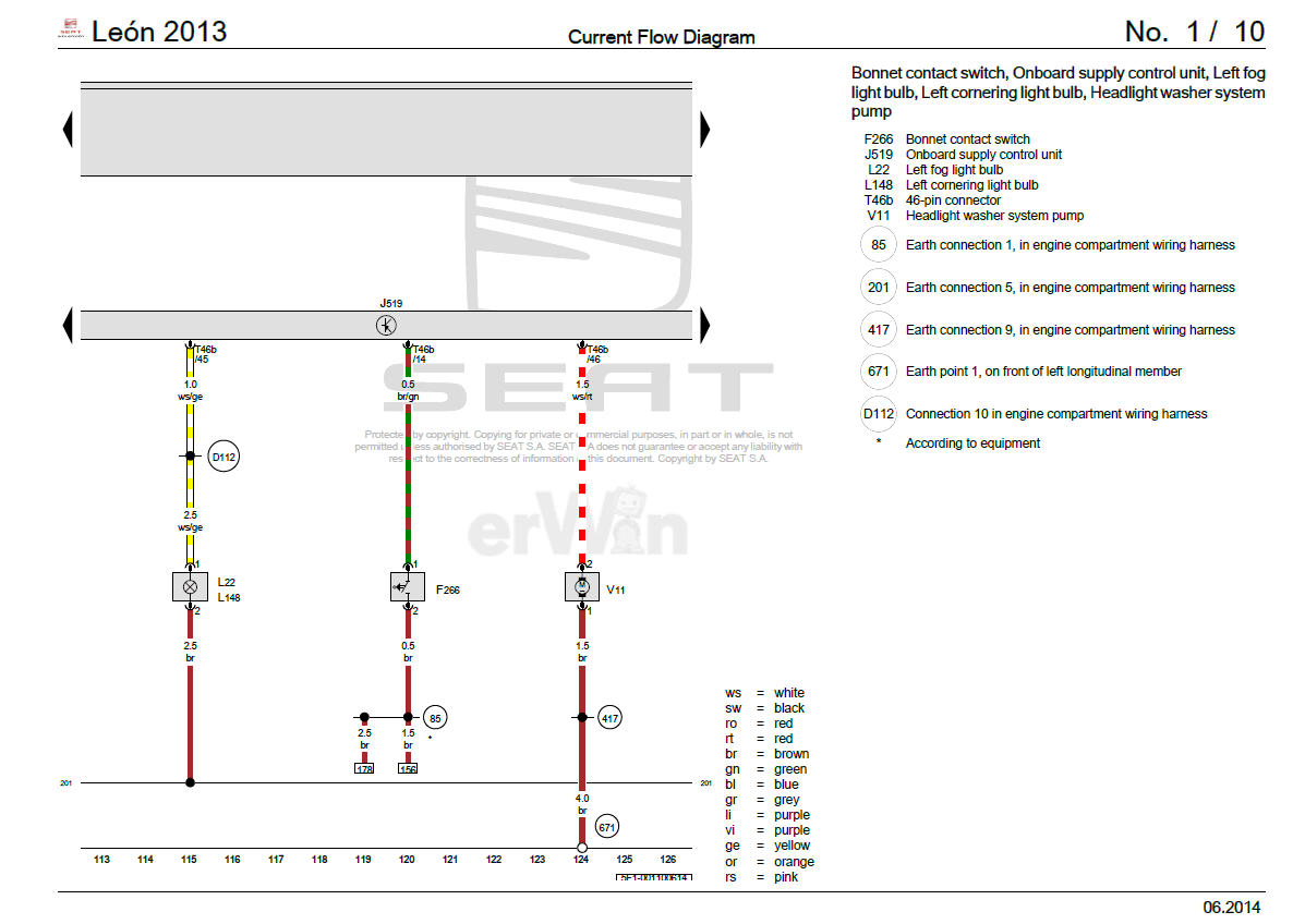

According to the attached diagram, It looks like a two wire-connection, one for the ground, the other for the central electrics control unit (J519/BCM).
Also, it needs to be coded to work. I had a quick look using OBDeleven and saw a "headlight washer" entry in 09-Central Electrics, byte 13, bit 3, set to ON in my car, as it has the feature in question. Of course some other coding changes might be needed for it to work.
