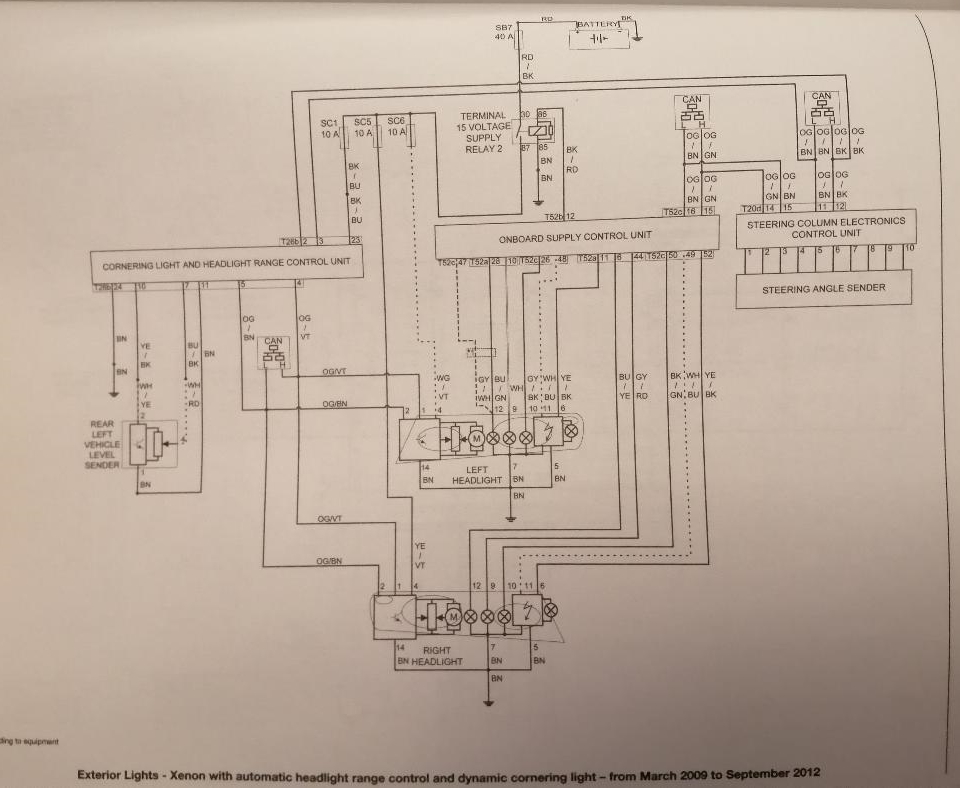

Hello does anyone have a headlight wiring diagram for the normal and xenon headlights please?
Jonathan Varley Oct 9, 2019 4 0 Oct 10, 2019 #1 Hello does anyone have a headlight wiring diagram for the normal and xenon headlights please?
Legojon I only wanted a remap Staff member Moderator Jul 7, 2015 5,284 2,714 Oct 11, 2019 #2 Not sure if someone has a digital version that's easier to read. But hopefully these help. Attachments Wiring1.jpg 362.7 KB · Views: 4,210 Wiring2.jpg 317.5 KB · Views: 4,496
Jonathan Varley Oct 9, 2019 4 0 Oct 11, 2019 #3 Legojon said: Not sure if someone has a digital version that's easier to read. But hopefully these help. Click to expand... Brilliant thank you.
