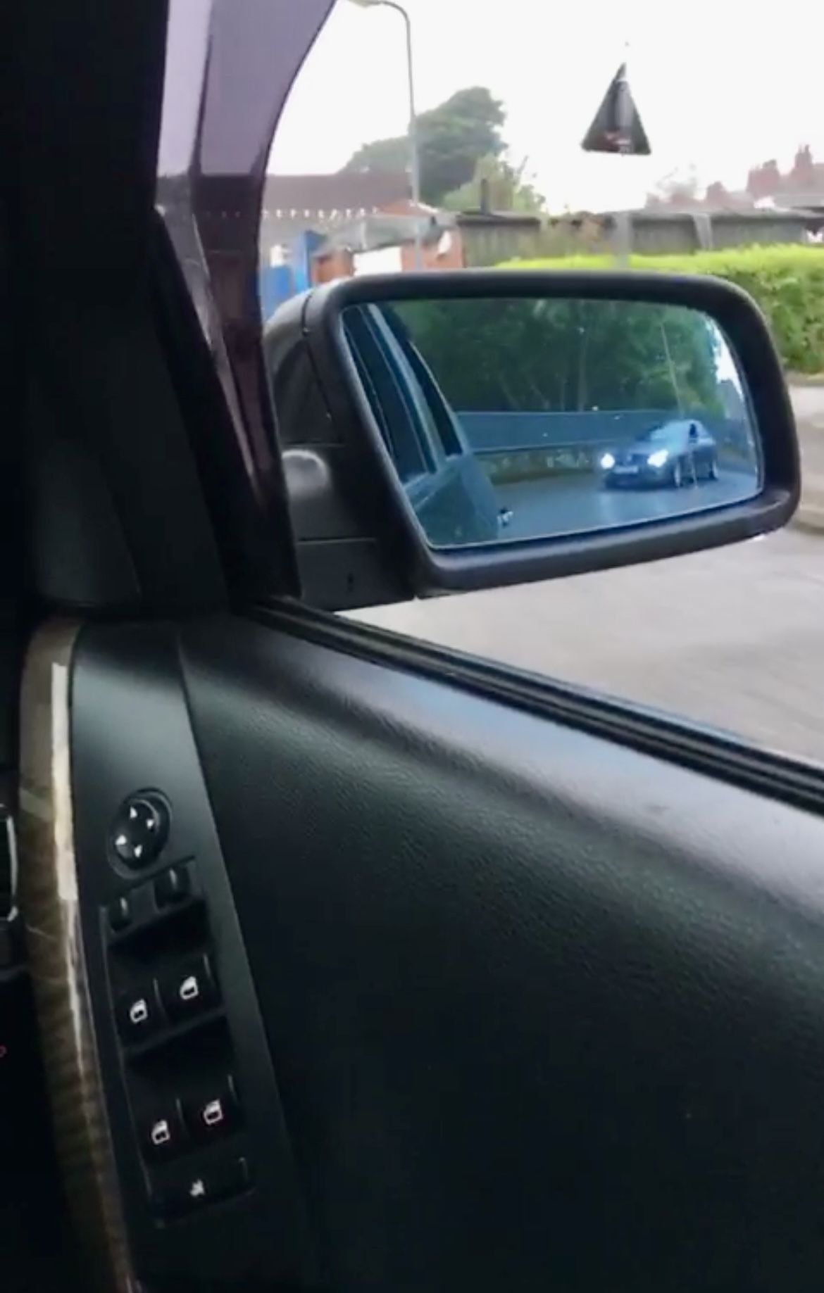

Not the greatest of pictures but this was my E60 535d, mirror had auto heating and auto fold.
There was a little slider to select left or right to adjust and if left in L or R, that side would dip. There's also a tiny button to close mirrors manually.
No auto dimming but the mirror had a factory blue tint.
Wonder if i could use normal blue tint on the Leon?
