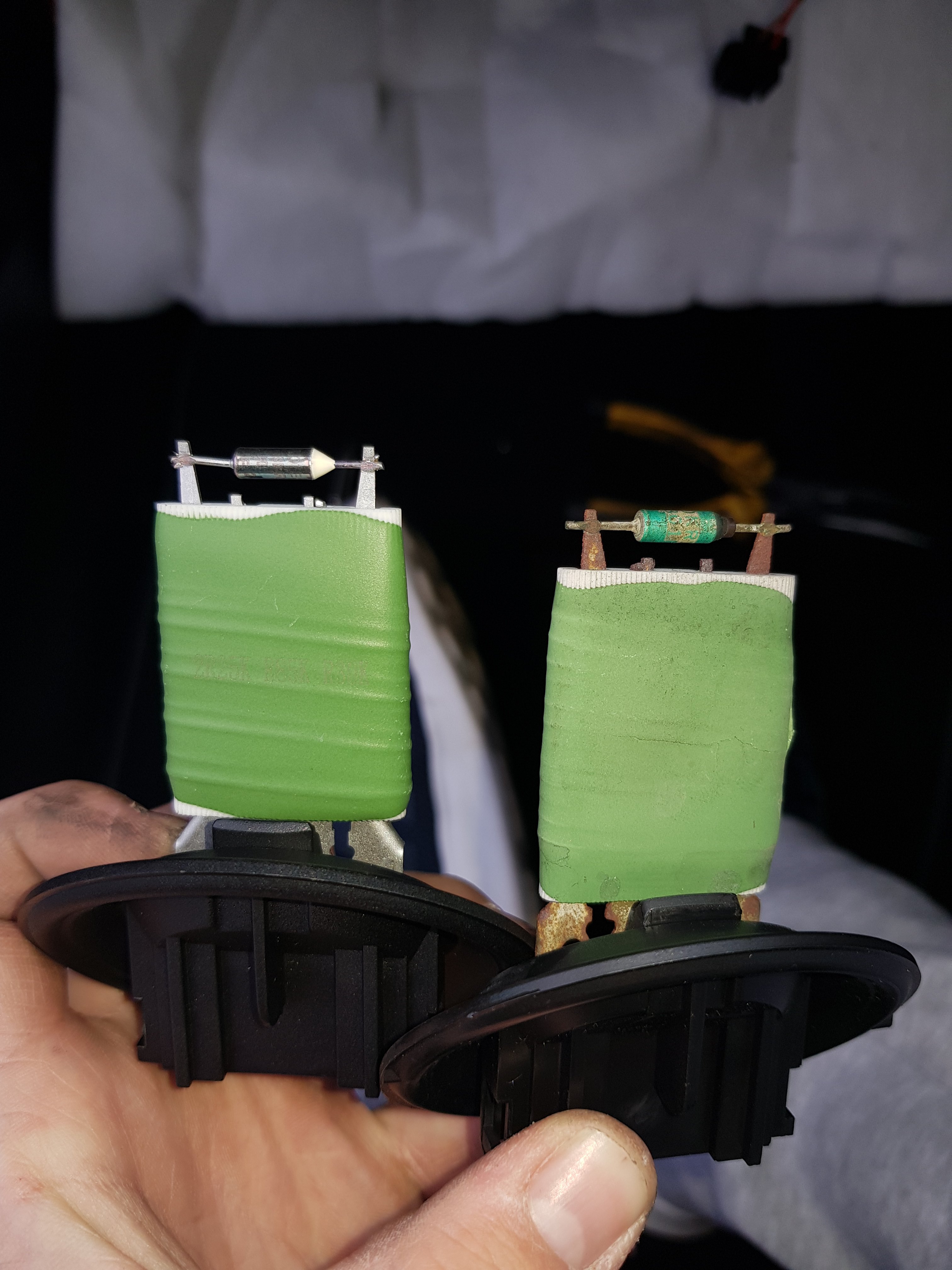

So last week my fan stopped blowing air on setting 1,2 and 3 but blew at max 4.
After some research turns out it was the resistor pack. If any of you have the same issues here is a few pictures of what's behind the passenger side dash/glovebox, maybe it will help!

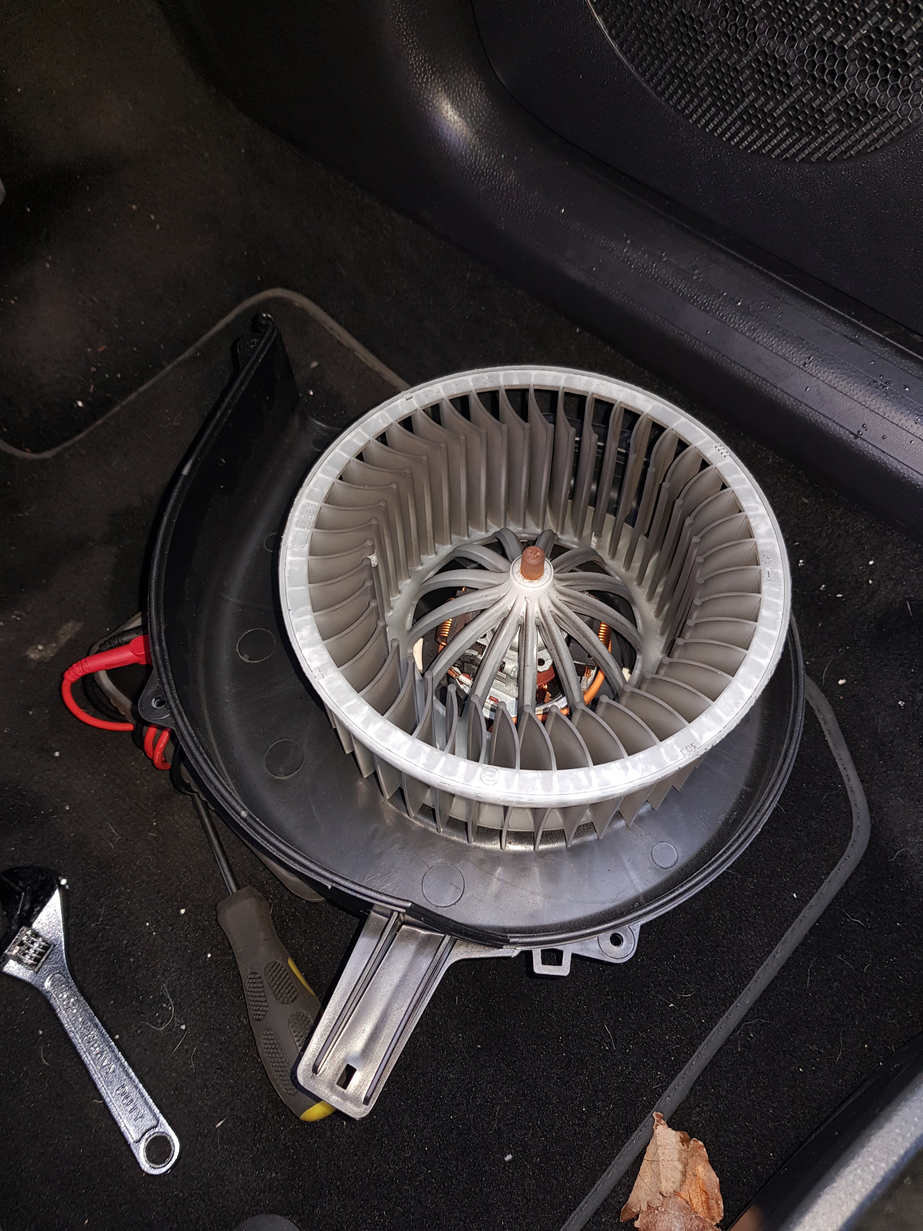

Start by removing all the screws holding in the glove box from the front roughly about 8, then there are 2 on the side panel. Next remove 4 silver bolts holding on the blower motor and it will just pop down for you with a bit of wiggling, then you look in through the vent and you'll see the resistor poking down. From the top twist it anti clockwise about 20 degrees and pull up and out. Job done!
Remember to unplug everything eg..glove box light, airbag connector and power supply to blower, they can be easily seen once glove box is out. Reason for removing the blower motor is to give it a clean with a cloth as mine was a bit gunked up

I only had speed 4 working on the fan so decided to remove the glovebox and investigate for myself, found the fan motor and tested for power, confirmed only works on speed 4, so found and removed the fan speed resistor which had the green insolation cracking and peeling away, also smelt burnt.
Anyway ordered a new resistor and refitted everything and the interior fan is working again on all 4 speeds.

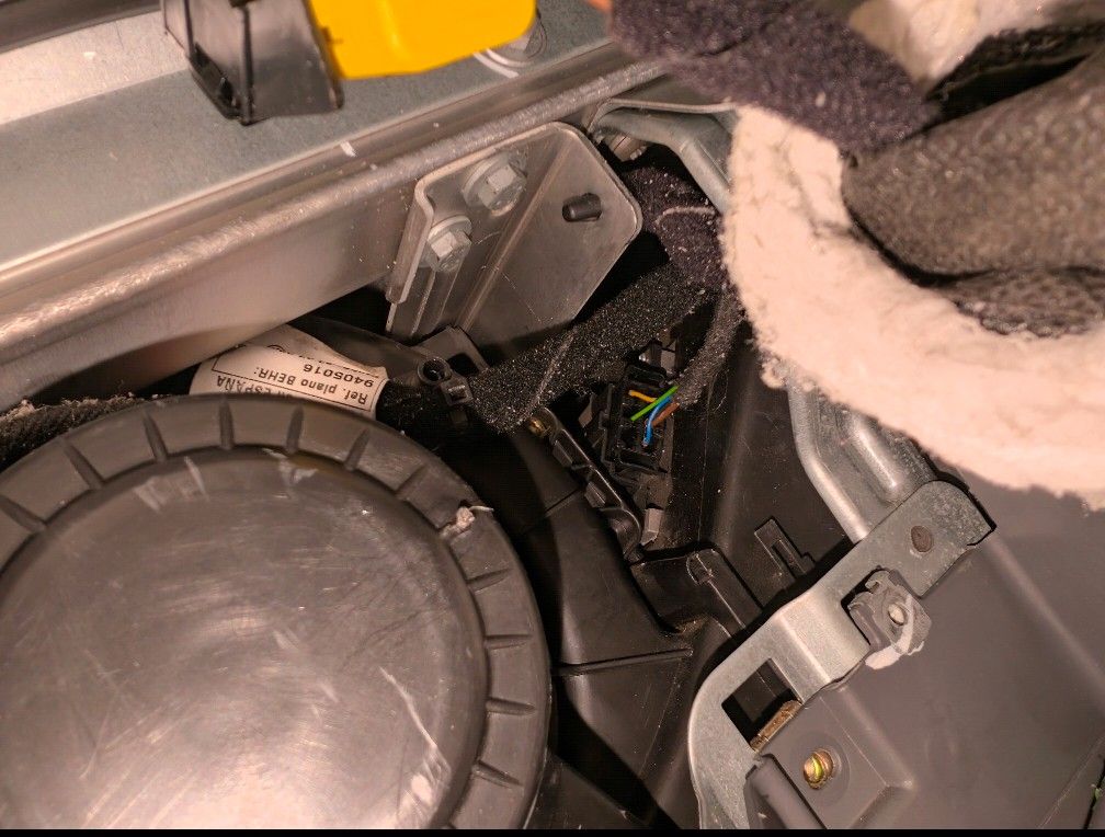

Hi, got a Seat Ibiza 2006. Heat resistor isn't in the place it's supposed to be. Anyone able to point in the right direction?

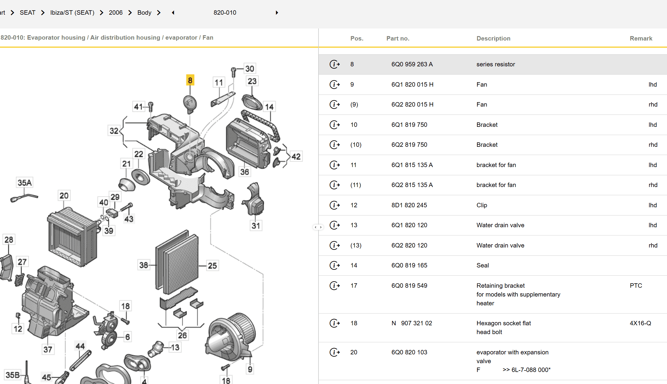

Cheers. Comparing the diagram, to the first picture in my post, my car doesn't have (8) - just a connection port. Do you know of any other place it could be?

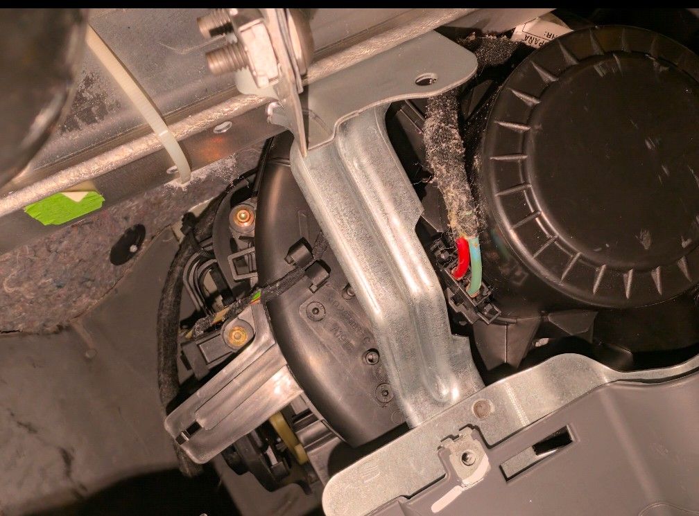

By the way, the connector there with the green/blue/red wires in your first picture looks the same as the one that's connected to resistor in a how-to video I just watched in YouTube. (It's for a VW Polo but they are basically the same cars.)
Nothing connected to it in yours ?
