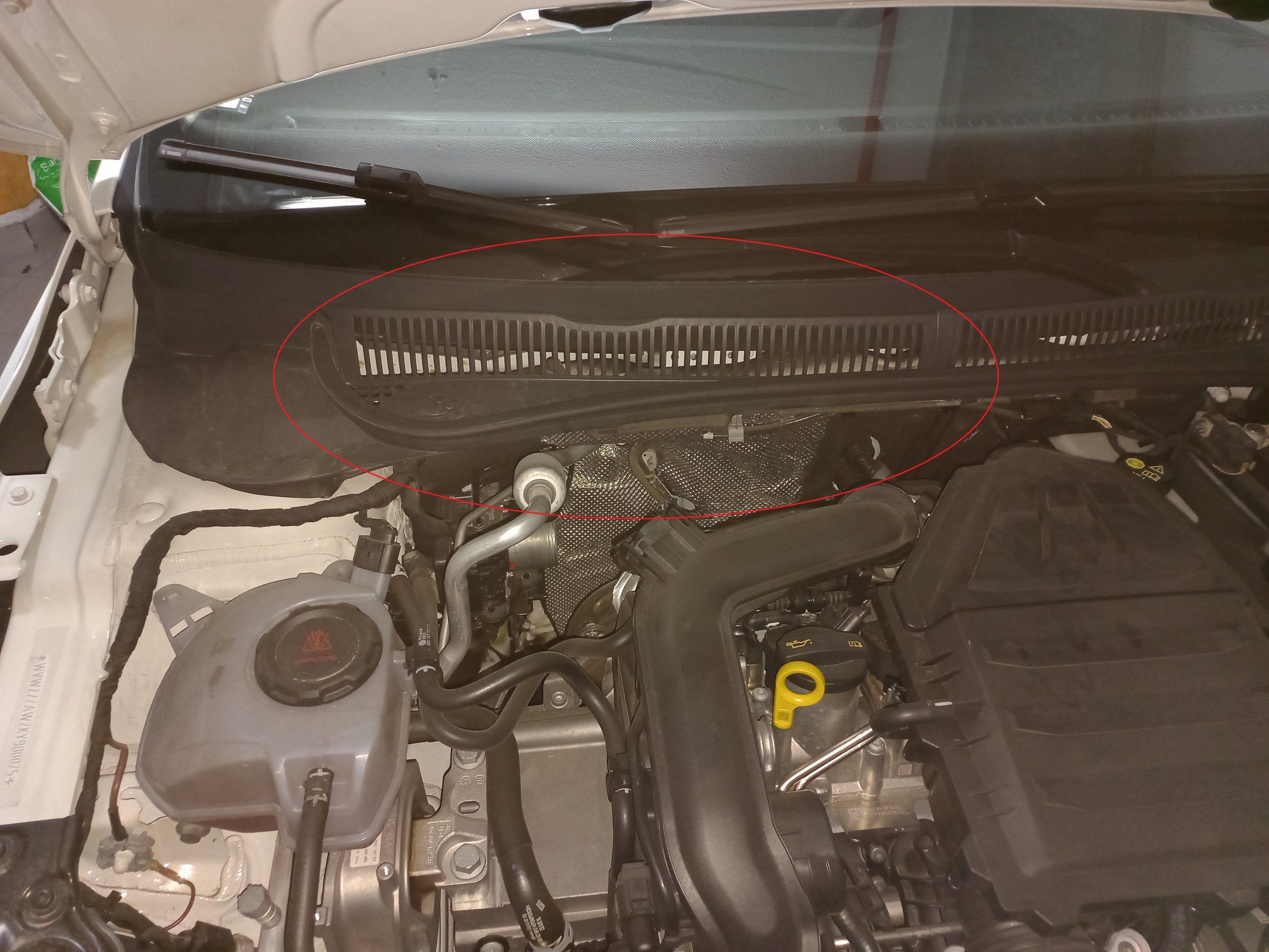

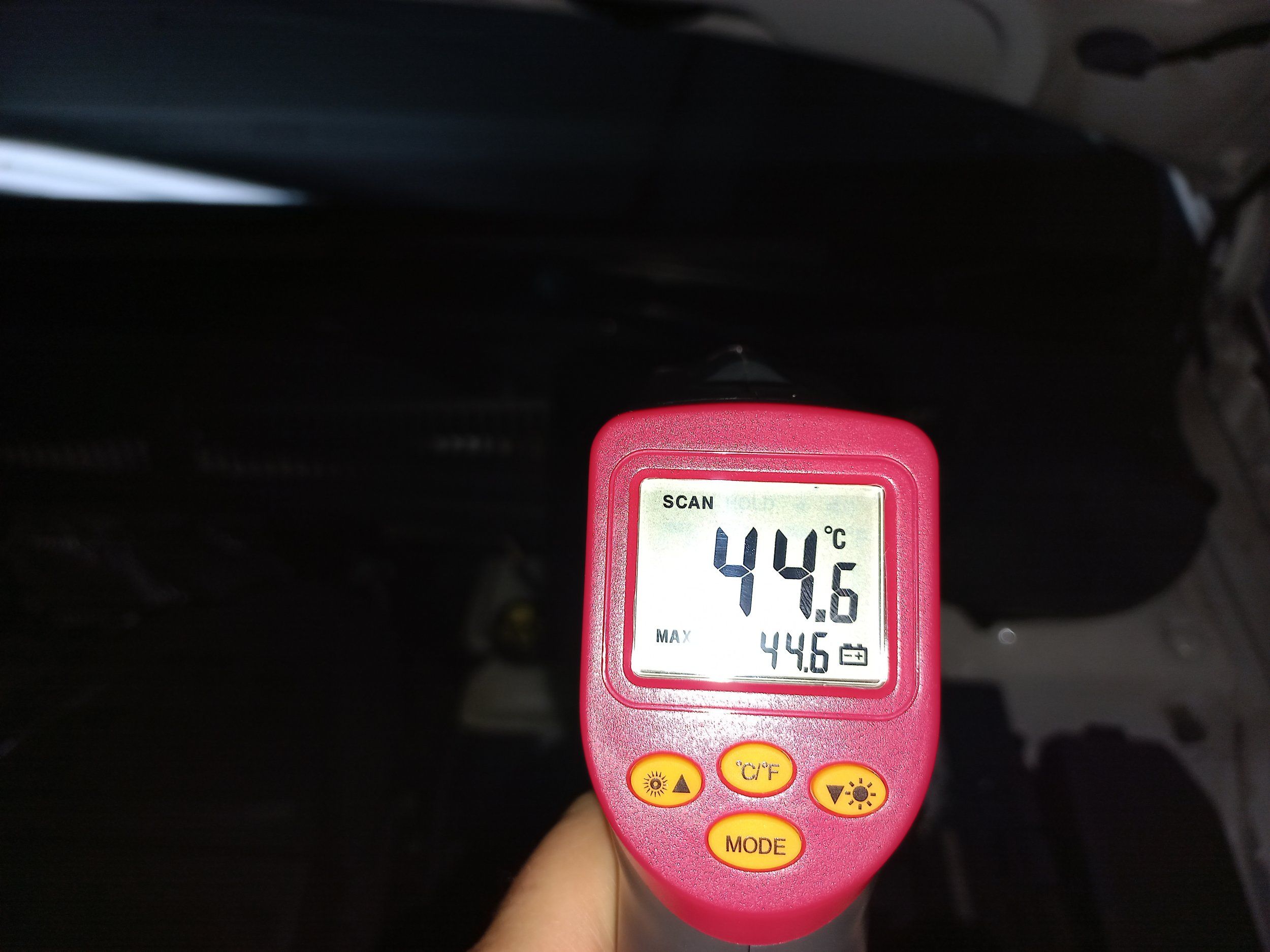

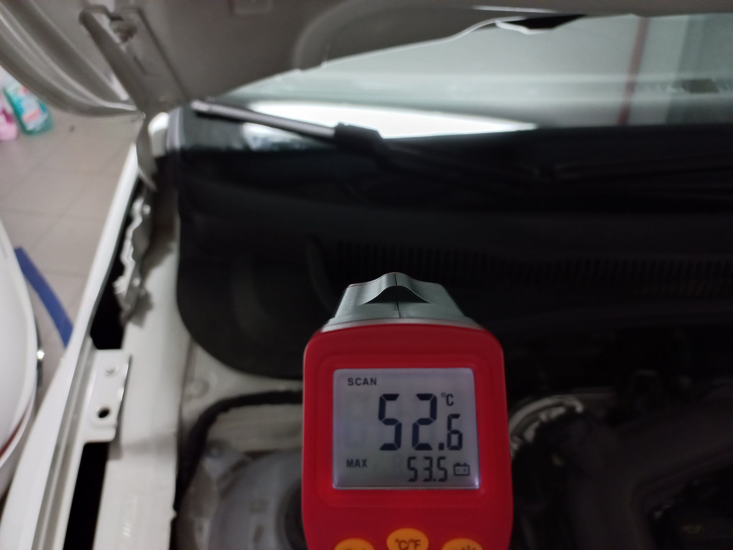

This place is where the air enters the cabin
you can see the temperature difference there and on the left side
