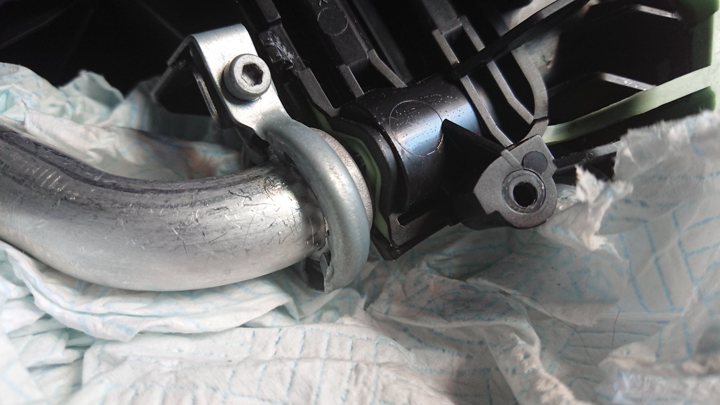

Just installed a new heater matrix without much issue but I can’t seem to get the bottom pipe/hose clamp to seal on the matrix. It’s the one that tightens with a hex bolt but no matter what a try I can’t get it to fully seal. Does anyone know what the proper method for securing it is?
I had the same issue with mine. There is a sort of knack to get the little teeth on back of the bracket to sit nice and snug and located properly before you tighten up. That then pulls it in nice and tight. The pipe needs to be pushed right in and then it sort of just `fits` right. It is literally about another 2mm. If it's not located quite right it doesn't seal when under pressure - although I suspect that you already know that.
That’s really helpful! Did you have any issues seating the pipe in the matrix? It seems to be protruding a little bit and that’s causing the bulk of my issue I think, tried applying more pressure but doesn’t seem to go in any further.
Not sure. I does need to seat properly and then the locking collar sort of just fits. If the collar is seated properly, when you tighten it, it all just seems to work. It's hard to describe, as I had the same issues as you and then it just all came together.
Maybe try to make sure the pipe is as snug as it can be, get the collar located correctly then tighten.
I think that I could sort of tell when the pipe was not located quite right (stick out a few mm than it should) and when it's nice and snug the collar locates properly and you can just tell it's in the right place.
It was trial and error for me, so I'm afraid you might just have to fiddle with it.
The o-ring is the seal - the clamp just stops the pipe coming apart. Make sure the pipe & o-ring are fully home before doing up the clamp.
Maybe use a little coolant as lubrication on the o-ring to help seat correctly.
