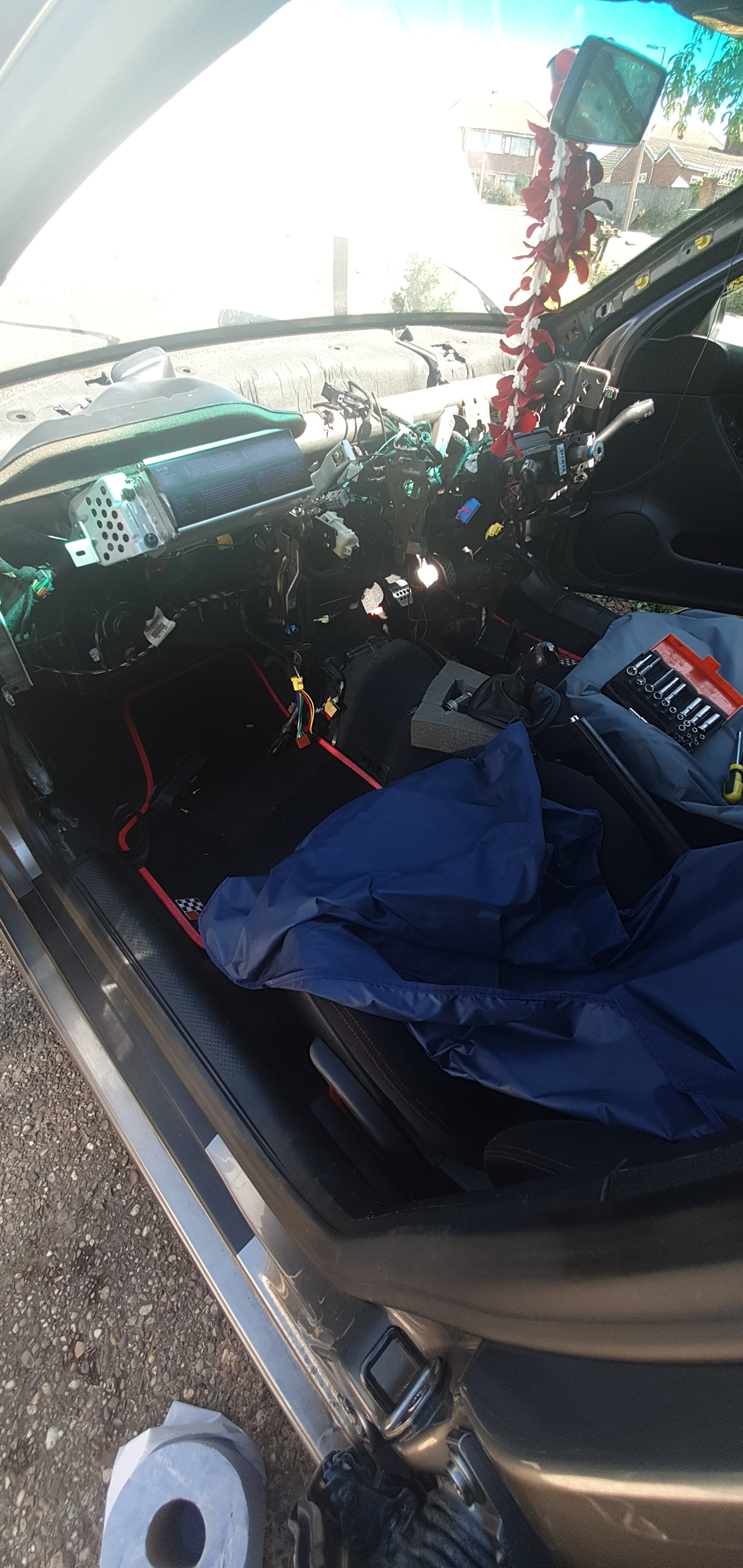

Ever wished you did not start somthing
Mostly back together now, no more steam through the heaters

all done, worst job to do on one of these. £700 quid at a garage, cost me £50 and 2 days.
Fair play to you, did it all go back together properly and without any dash rattles or left overs?
Sent from my SM-G960F using Tapatalk
tonycane
Feb 17, 2009
143
wolverhampton/solihull
Few self tappers from some lower trim panels. I just took my time. Finding those 10mm bulkhead bolts were fun.
I cured a few rattles, fixed some broken air vents, tidied up the stereo wiring ect.
Just finished the rocker gasket and replaced the washer jet hoses that went brittle.
