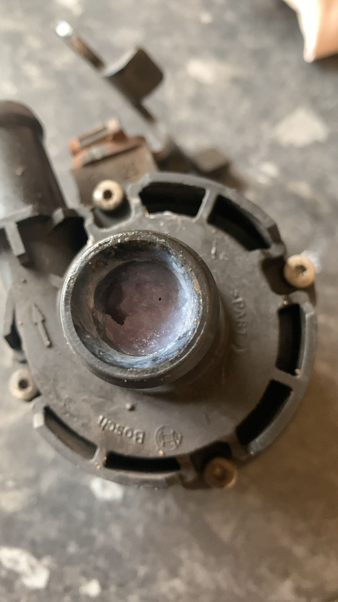

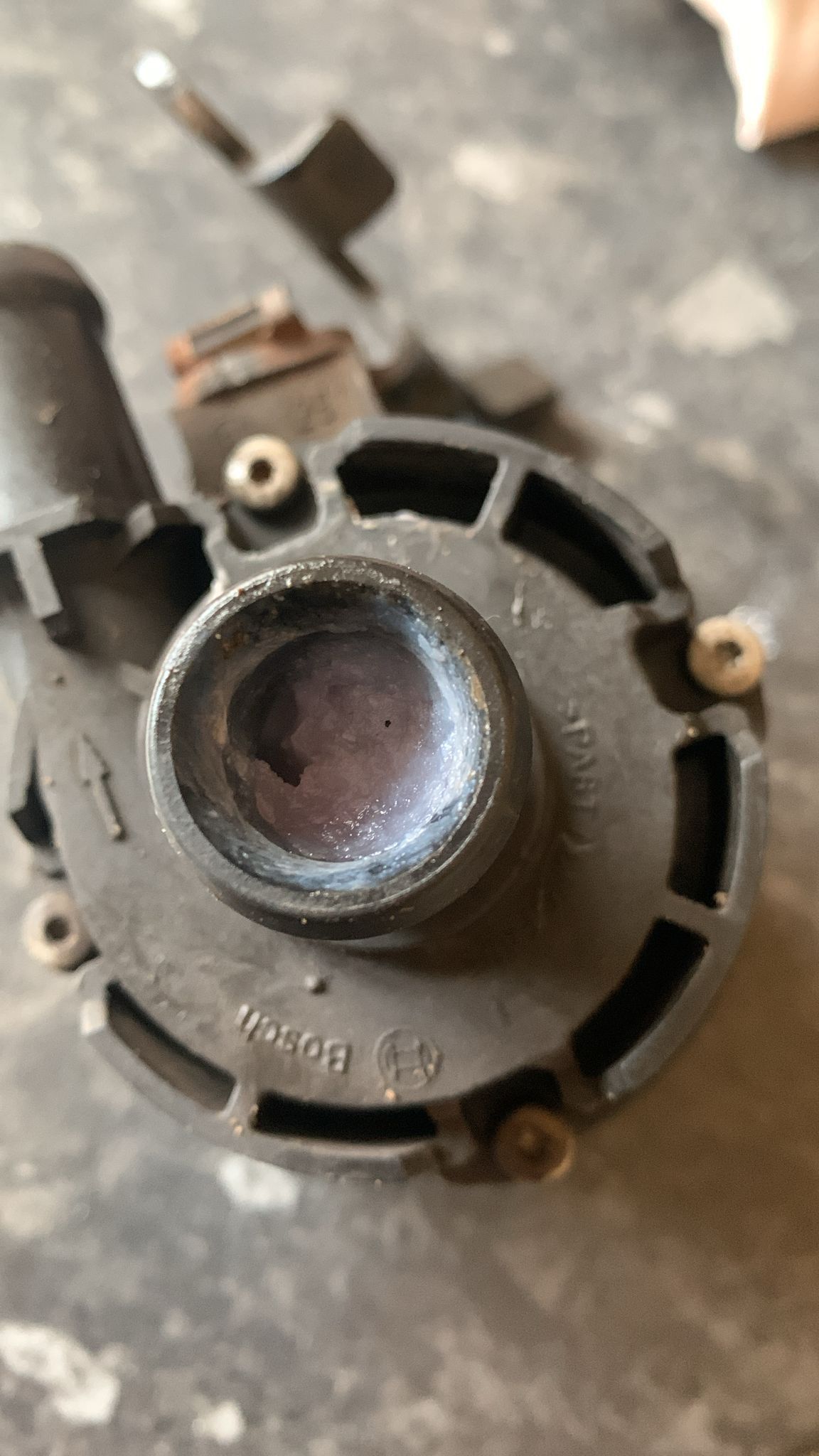

After cleaning out the crystal salt like stuff from the auxiliary heater pump and the low heat circuit pipework i could get warm air starting to come through within a couple of miles. At cold the main coolant circuit is cut off by the main water pumps shroud been closed, at that point the auxiliary heater pump is working by pumping exhaust heated coolant from the egr cooler on diesels anyway through the matrix.
