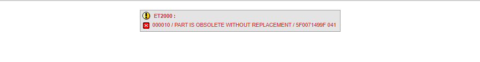

after further investigation according to the seat parts system these have been made obsolete with no replacement - something for all carbon edition owners to be aware of

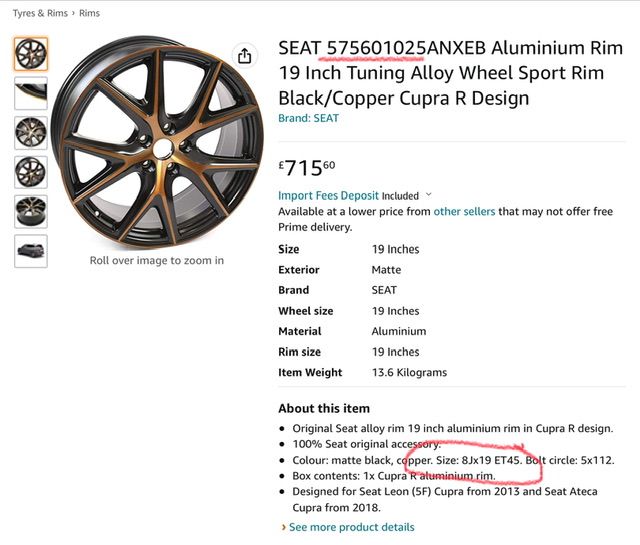

I think that one with part number 575601025APKT2 has an offset of ET45; there’s a copper coloured one with the same part number (575601025ANXEB) for sale on Amazon which includes offset details - see details below. Note; the last 5 characters of the part number relate to the colour of the wheel; APKT2 = silver coloured and ANXEB = copper coloured, otherwise 575601025APKT2 and 575601025ANXEB are the same (J size, diameter, PCD and offset).

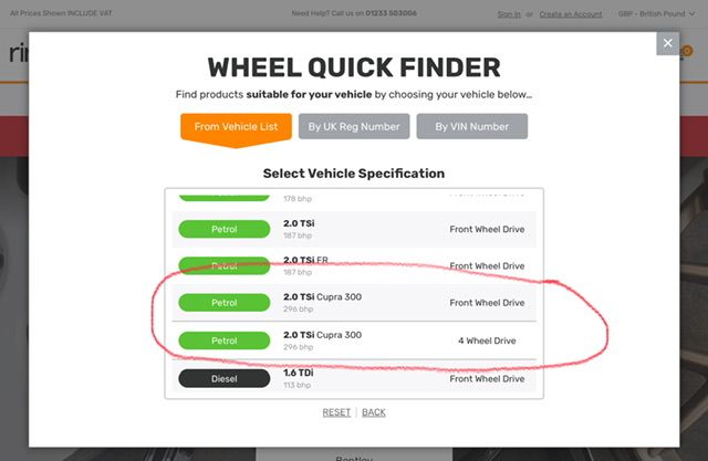

On most reputable aftermarket alloy wheel retailer’s websites, if you input details of your car, then they should only show you alloys that will fit your specific make and model of car.
The vehicle make / model lookup tables on some alloy wheel retailer websites are better than on others. The Rimstyle website (www.rimstyle.com) seems to be quite good and gives the options of finding the correct vehicle from its reg no, VIN or manually selecting the appropriate details (make, model, year of manufacture, body style, engine size / bhp, whether FWD, RWD, 4WD). Note that with Cupra, it sometimes isn‘t shown as a manufacturer - with Rimstyle’s vehicle lookup tables, Seat needs to be selected as the manufacturer, Leon as the model and Cupra is included on the engine size list - see below;
The alloys that are then displayed for your car should take into account factors as brake size to ensure there are no clearance issues between the calipers and barrel or spokes of the alloys. However, it may not take into account larger brakes if these were optional rather than standard on your model of car. (I seem to think they were part of the (optional?) Performance Pack), in which case it would be advisable to call the phone contact number or use the online enquiry form.
Bear in mind that with aftermarket alloys, the original OEM centre caps may not fit. However, if OEM style centre caps are important to you, then it ought to be possible to buy a set of Seat / Cupra emblems with 3M (or similar) adhesive tape backing that can attached over the centre caps supplied with the aftermarket alloys.

As for the ET45 wheels, I didn't notice if anyone else had already said, but these wheels WILL fit and will clear the Brembos. They're the setup of wheels from the Cupra R ST so will give you a 10mm wider track (Sadly doesn't give you the better geometry/added camber :D).
Downside is you'll need at least two of them to balance the axle you're putting them on, or 4 if they only come in Copper (which was my impression).
If they do come in Silver, I'd just get the 2 and run them on the front to help reduce the understeer of the 4Drive...
Reactions: mallet
