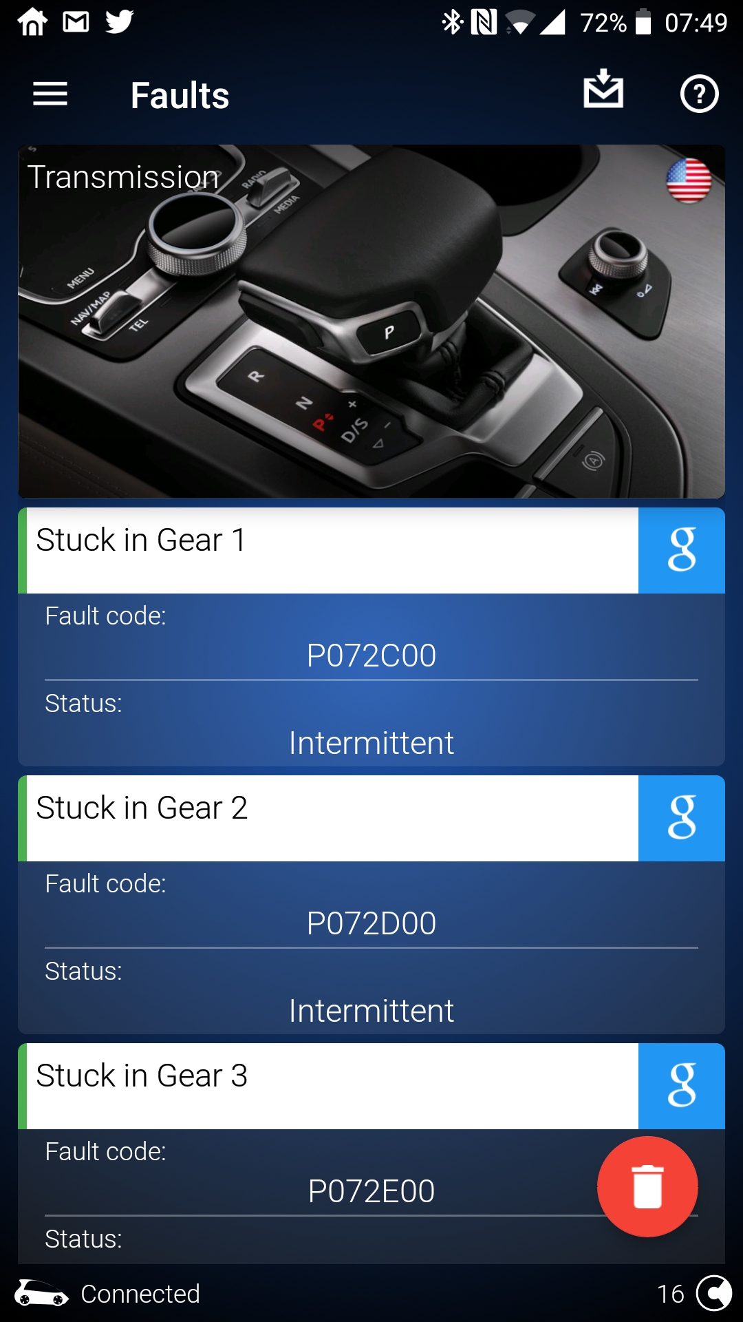

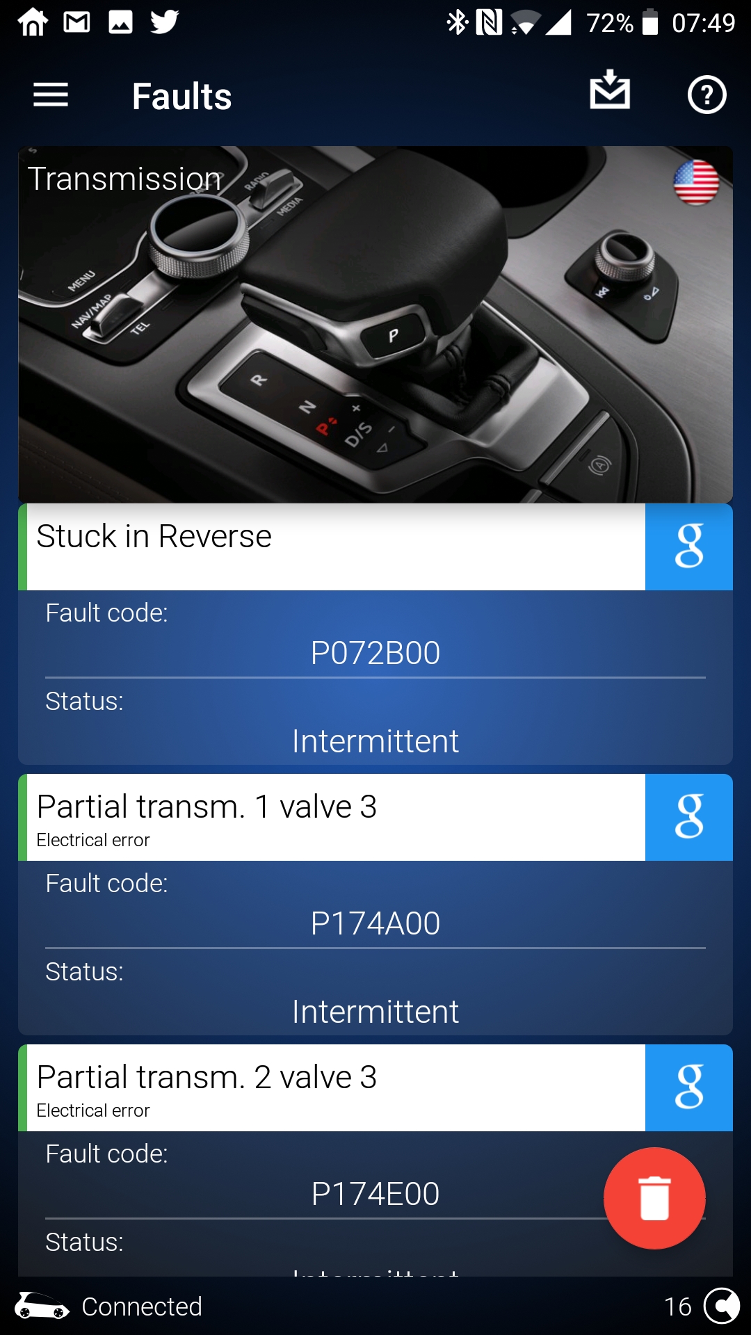

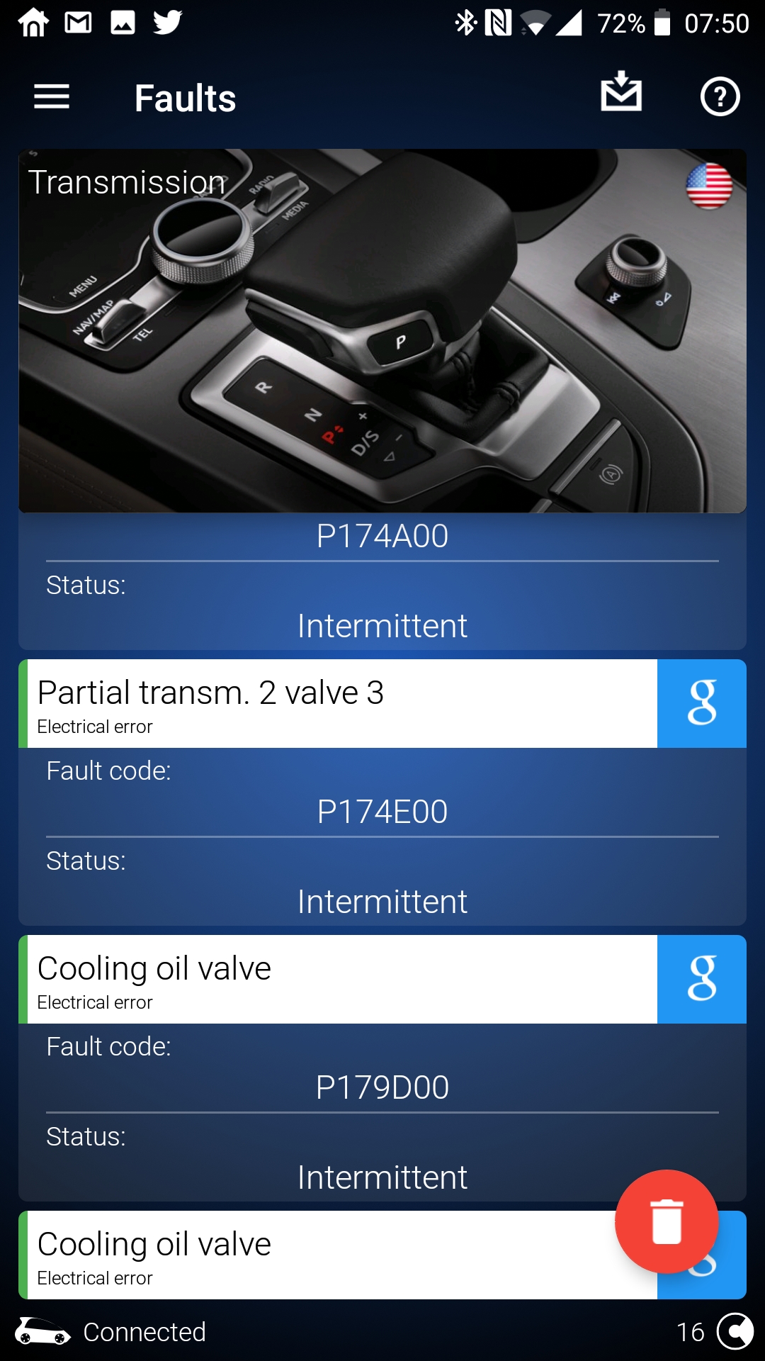

Hey all, just need some help and thoughts on a number of intermittent faults being generated by my transmission on the ST 4Drive. I have done 28k miles now and think there could be something deep in the gearbox that just doesn't feel right. (using the arse sensor)
Using OBD11, these are the faults (see screengrabs)
Stuck in Gear 1 - P072C00
Stuck in Gear 2 - P072D00
Stuck in Gear 3 - P072E00
Stuck in Gear 4
Stuck in Gear 5
Stuck in Gear 6
Stuck in Reverse - P072B00
Partial Transm. 1 Valve 3 - P174A00
Partial Transm. 2 Valve 3 - P174E00
Cooling Oil Valve - P179D00
These faults have appeared 3-4 times now, I can clear them and the car seems to run ok - though I feel overly sensitive to what the gearbox is doing. This might just be me being OCD or there could be something strange.
The car is in warranty and the gearbox and engine is stock so obviously I can go to the Stealers and ask them to take a look but I'm hoping someone might have a similar thing and perhaps some ideas!

Hi, any update on this?
I also get these codes and they reappear if I clear them. I’m using the latest OBDeleven and drive a 2WD Cupra ST 300 DSG.
No other symptoms, car runs and changes gears just fine.
Nora2004
Oct 15, 2017
176
80
You guys aren't running a scan with the engine running are ya? As these will pop up, do it with the engine off and ignition on only!
