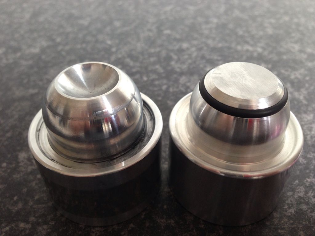

Could be that, there is a service kit available from forge as there was an issue with the piston, either that or could be a possable boost leak, ie split hose somewhere
Old piston left and new piston right, this caused an issue with mine as now its changed it holds boost better

Changed the diverter valve today an seems better, will give it a few days an see how it goes but hopefully thats part of the problem :)
