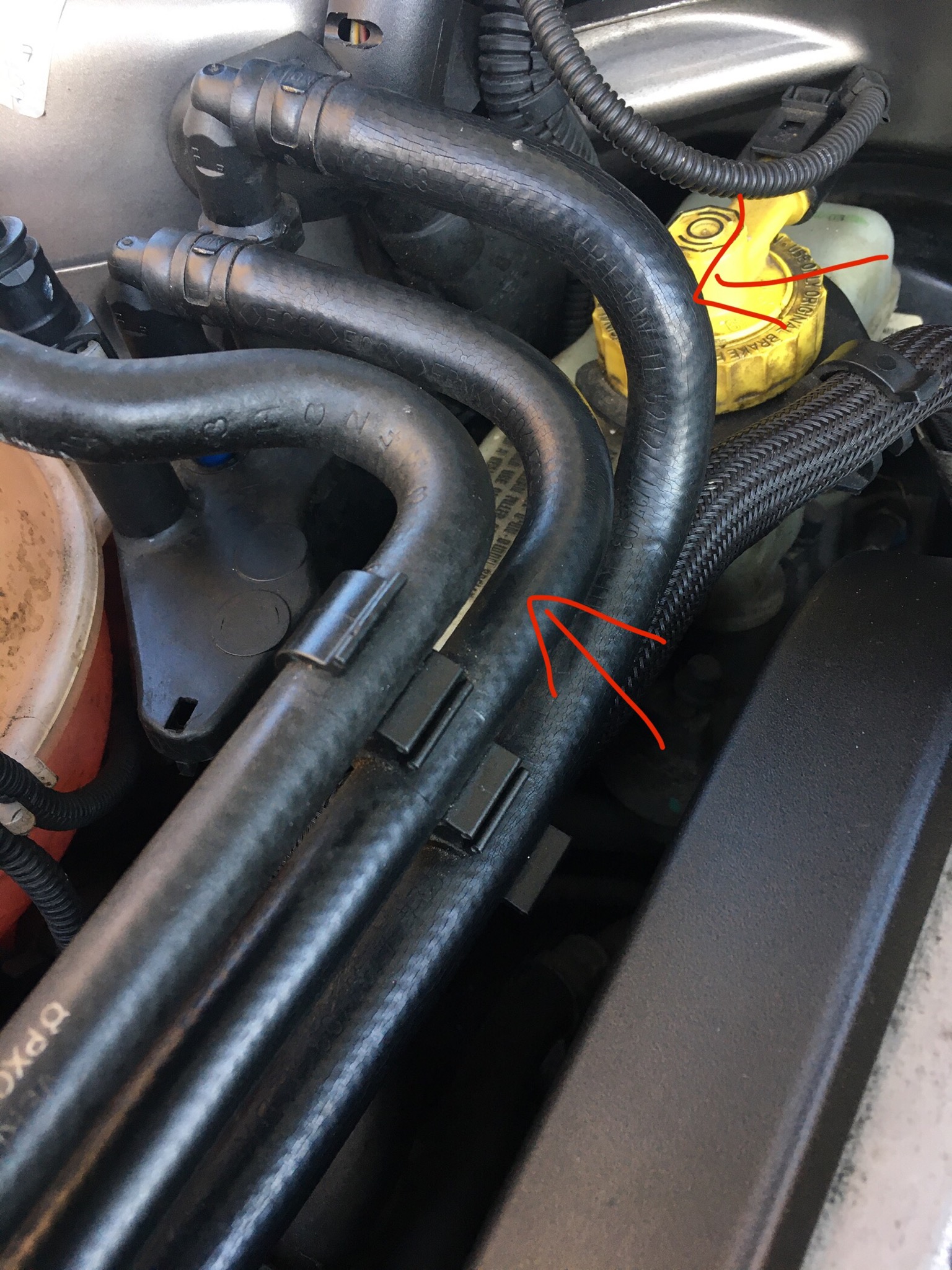

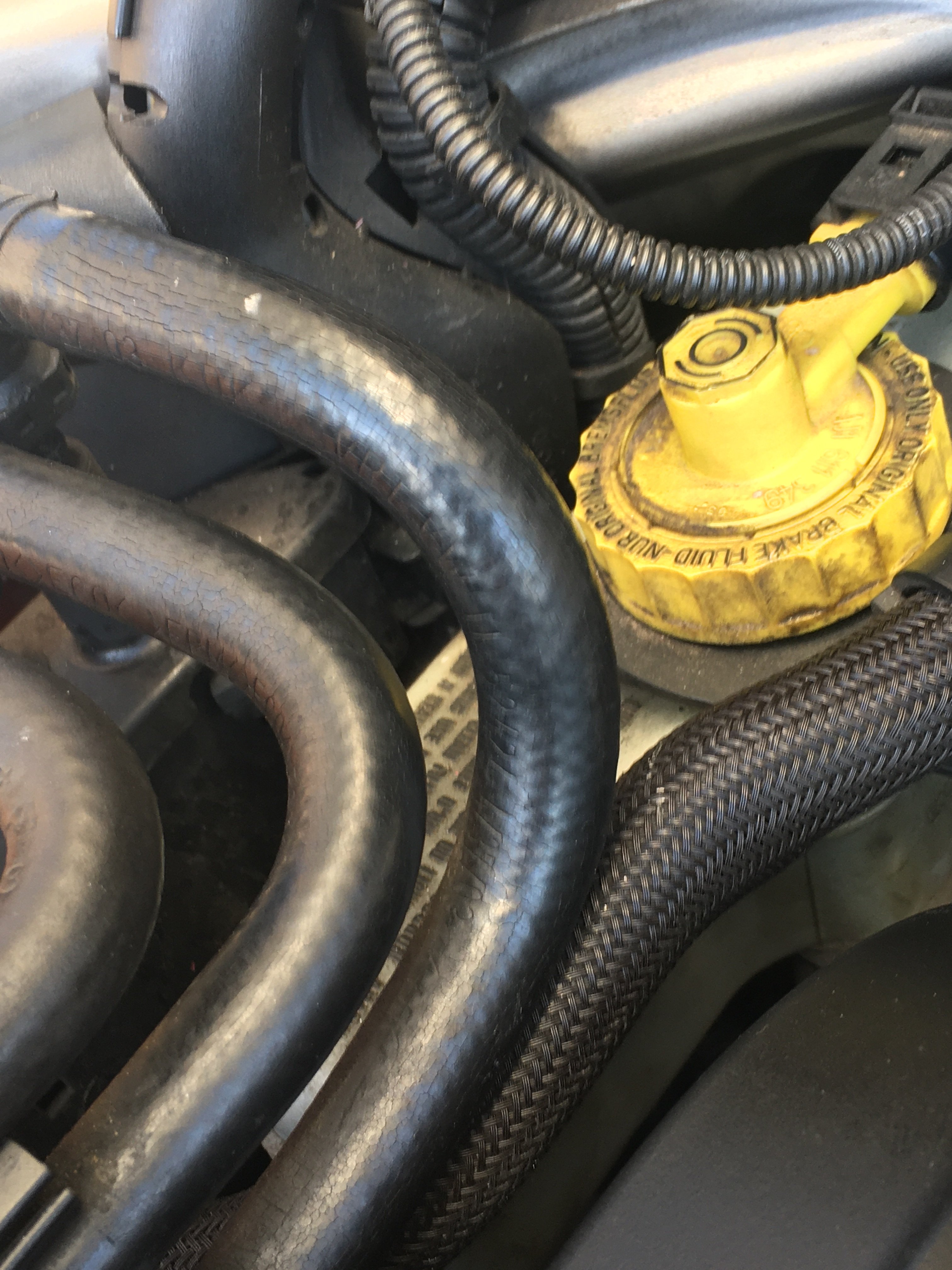

Cleaning my engine bay today and noticed these fuel lines(?) are badly perished.
what do these hoses do exactly? And what issues am I looking at with them perished as such?
also looking into replacements, might as well spruce the bay up. Looking at braided fuel hose, 8mm I believe? What kind of fixing will they need?
I’ll probably get some 8mm ID silicone hose off eBay for the coolant hose there.
TIA

From memory, they're 'Fuel feed from tank' ' Fuel return to tank' and I think also 'vent pipe to the charcoal canister'. The standard ones are almost £100 from seat. (if you can find them) http://www.oemepc.com/seat/part_sin...133/subcategory/133050/part_id/1399318/lang/e
https://www.ecstuning.com/b-genuine...expansion-tank-hose-fuel-line-set/1j0133699c/
You could probably replace with standard fuel hose, reuse the exsisting connectors, and fit new clamps. Not sure what clamps would be best, as obviously if that comes loose you will have fuel pissing all over your exhaust manifold.

I looked into it and it seems most people just use stainless braided fuel hose and the appropriate clamps. So I’ve ordered some of that with a 8mm ID. See how it goes! Assume I’ll have to take out the fuel pump fuse or something when changing them?

With the ignition off you wont need to pull the fuse (but nothing wrong with pulling it if you want to do so), there maybe pressure in the lines still though so be careful (I would leave the car over night to reduce any pressure.
Mine were an absolute **** to get off the fuel rail , so I ended up cutting the hose rather than take it off in one piece.

Well today i received my hose in AN -6 with the same size hose finishers. For starters the hose finishers were wildly too big for the hose and once clamped the finishers were just free spinning/moving. Great.
Second sh*tter is that the new fuel hoses were too big, saw all over the forums to use AN -6 (8mm ID) and it needs a 6mm ID to fit. Maybe its cos i have the AUQ so the fuel lines arent as big? :headhurt:
So just to warn people about doing, just take your fuel line off yourself and measure otherwise this happens.

Just measured my LCR and the fuel line I.D is closer to 8mm than 6mm - Sorry probably doesnt help much :-(
Well ive ordered some 6mm ID hose of the same variety, and some AN4 finishers. See if that fits! Id rather it be stretched to fit than clamped down to fit as it seems like a very tight line. Maybe the LCR does have bigger lines after all?

Nightmare the 6mm hose didnt fit either so im thinking the first lot i bought was just wrong and threw me off.
Ended up sorting it out with some fuel hose from halfords lol (8mm)
