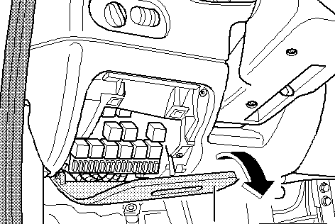

If it worked fine before Christmas, and then wouldn't start after two months sitting, my guess is either:
The relay for the start solenoid or fuses - there two, one in the engine bay, one under your dash.
The start solenoid its self (this is a big relay on the side of the starter motor)
