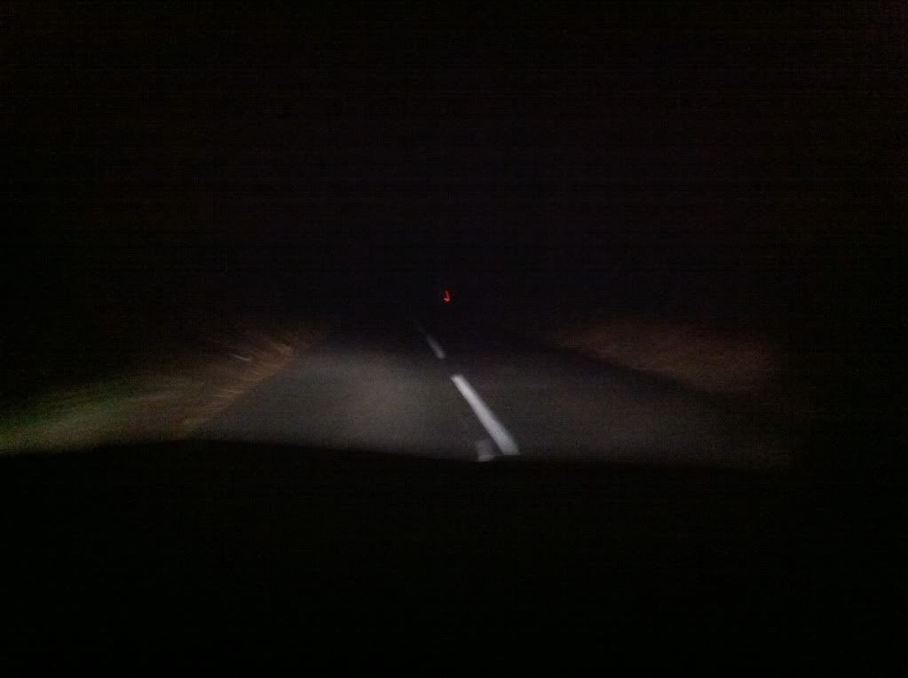

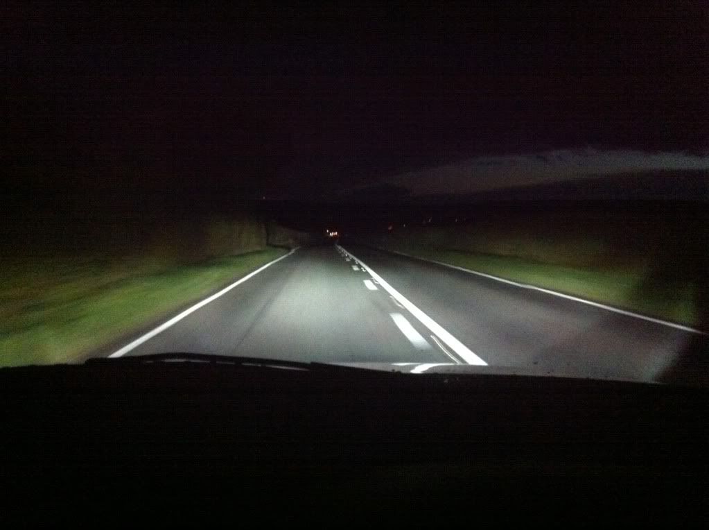

Just lows but there's loads if room there, I reckon I could hide a family of eatheopians there!
If there's one piece of advice I can give is, don't rush it and take your time it will show on the quality of the install ! Mine took me about an hour and a half to 2 hours but all cables are wrapped up in flexible conduit! . I have gotta do mine again now tho as I have orderd a relay harness to stop radio interference
