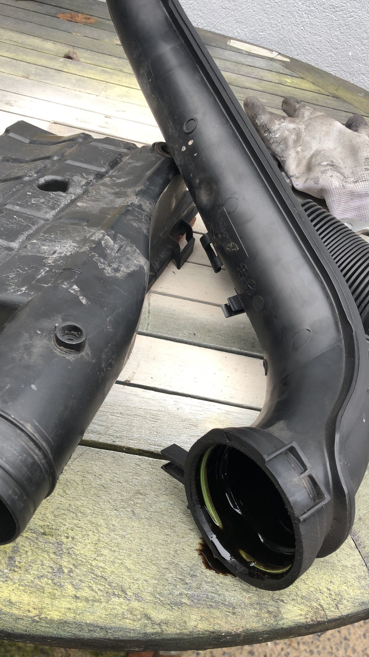

Hi lads, me again. Changed the sparks plugs and cleaned the throttle body and the hesitation is gone. However I noticed quite a lot of oil in the pipe between the turbo and throttle body (charge pipe?). Could there be bad seals in the turbo causing the high oil consumption.

Has that engine got a chain driven cam 8V or a belt driven cam 16V?
When last did you have that charge pipe off, that oil could have been building up in there for years, my wife has a 2015 VW Polo 1.2TSI 16V and I took that charge pipe to make changing the plugs a bit easier, it had oil in it that I cleaned out, and that was the first time that that pipe had been removed in 24K miles/4 years.

16v, that pipe was off about 15k kilometres ago. It seemed to be an excessive amount of oil.
