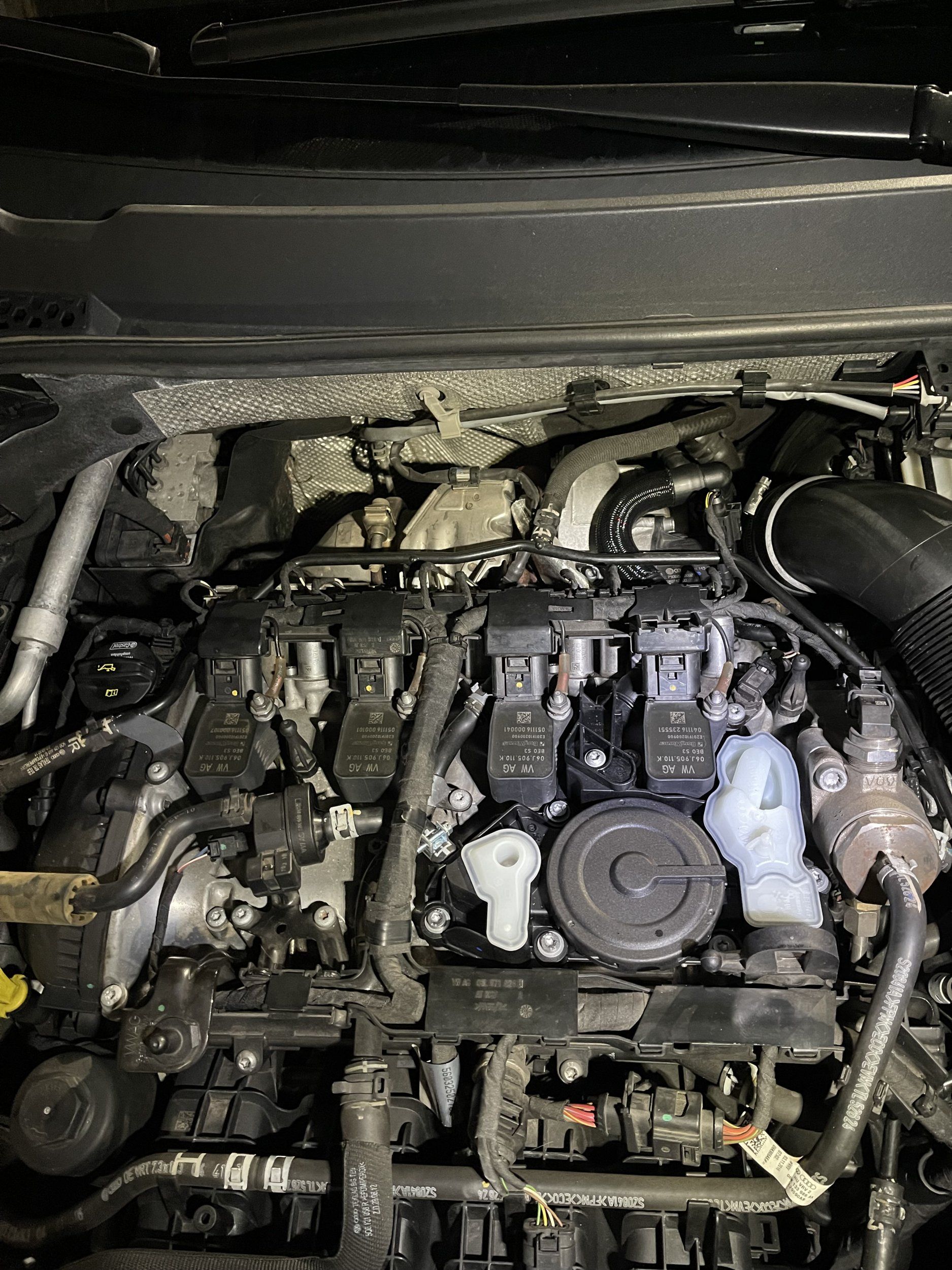

Hi,
I own a 290 cupra DSG 2016 with 86000km.
I noticed 2 days ago that on starts a puff of white smoke comes out of the exhaust immediately after the engine start.
I’ve never noticed it before but it could have been mixed with condensation since I bought this car on November and the days are juste becoming hotter.
The car is under warranty so I’m waiting Seat dealer to get back to me to book an appointment and as it will probably take at least 3 weeks before I get one I started digging by myself.
So :
- only one puff at start
- nothing if I start again after driving a bit (happens again after 15min or more.. the longer the bigger cloud)
- nothing on heavy acceleration
- idle steady
- no error code (except a catalyst one few hundred kilometers ago)
- no noticeable loss of power even if when I drove hard the car this morning it seemed to be less « kick in the ass » when accelerating as it uses to be when I think about it
- the cloud smells like gas (I think it is similar to the smell of when your start your car in the garage). Even though I’ve never smelled burnt oil I think it is recognizable.
- the car is not mapped, I only did a resonator delete and I have r600 intake + inlet + outlet.
- no oil consumption
- no coolant consumption

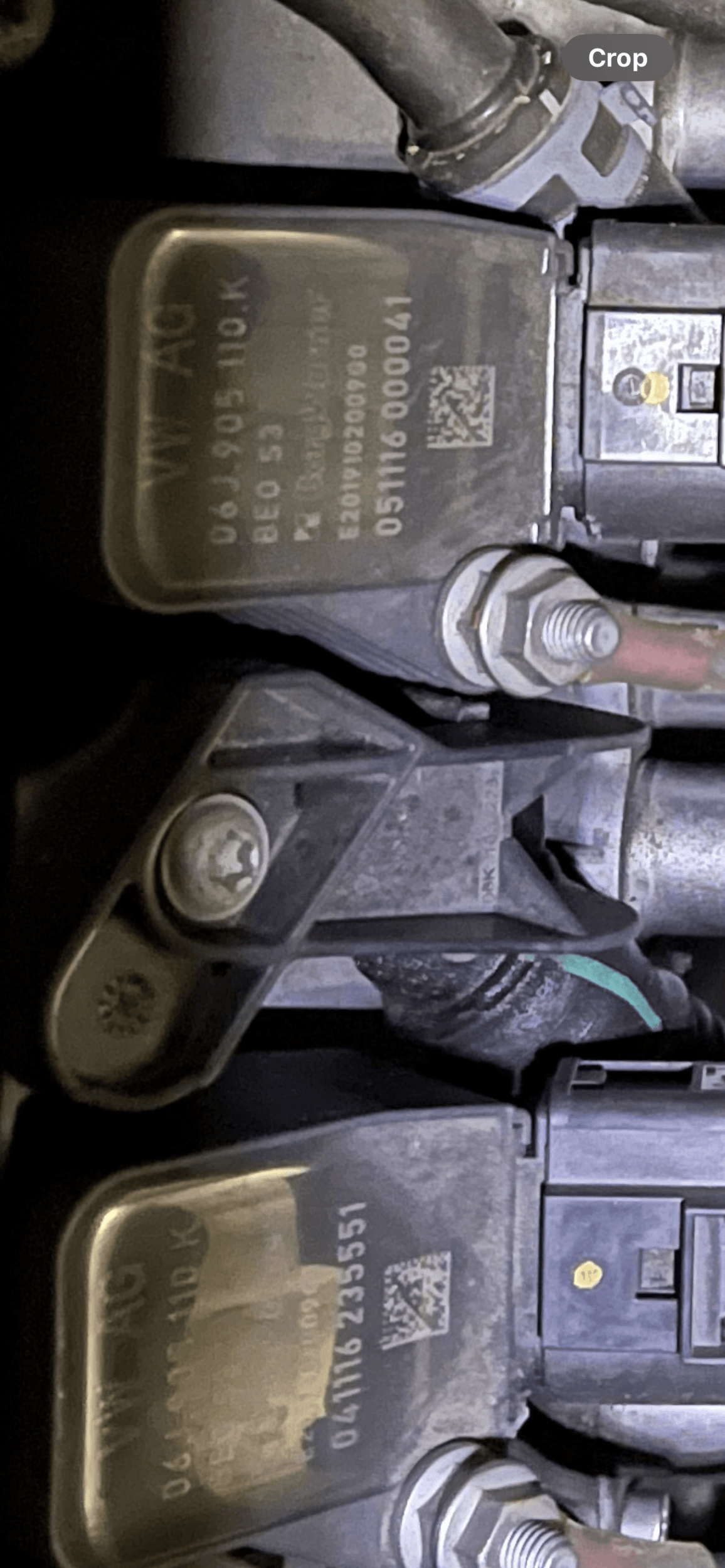

Checked the spark plugs nothing to report, except one was smelling petrol and thus the thread was greasy with petrol.

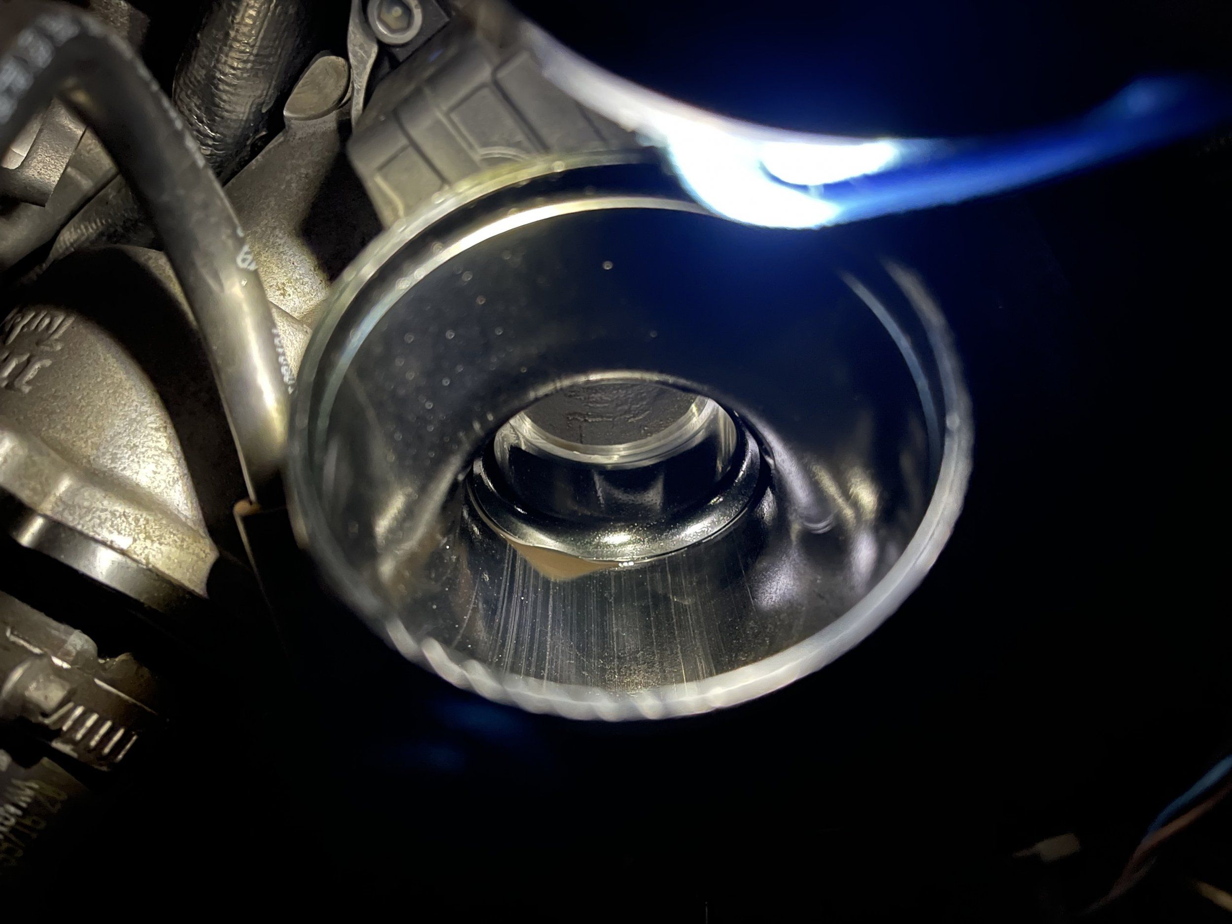

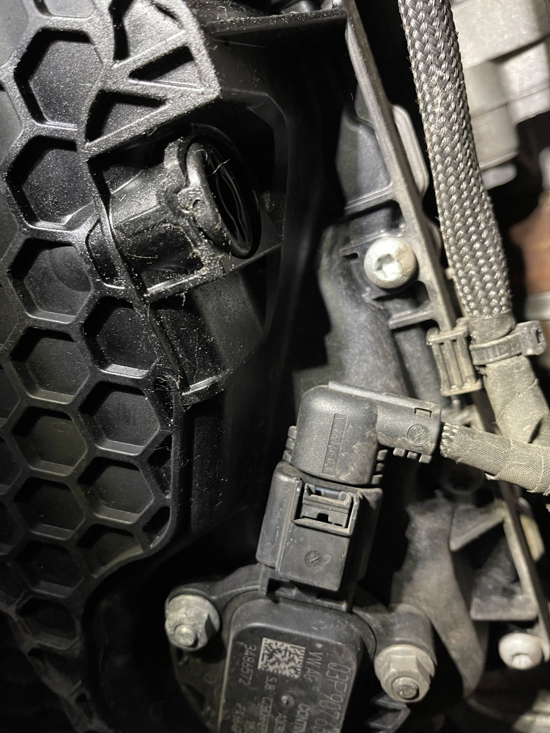

I’ve also discovered some serious vacuum from the oil cap when engine is running.. could it be related to my issue ? PCV failing like stuck in open/close position ?
I know some vacuum is ok but it took some force to take off the cap and the engine struggle while doing so..
Vacuum from oil cap

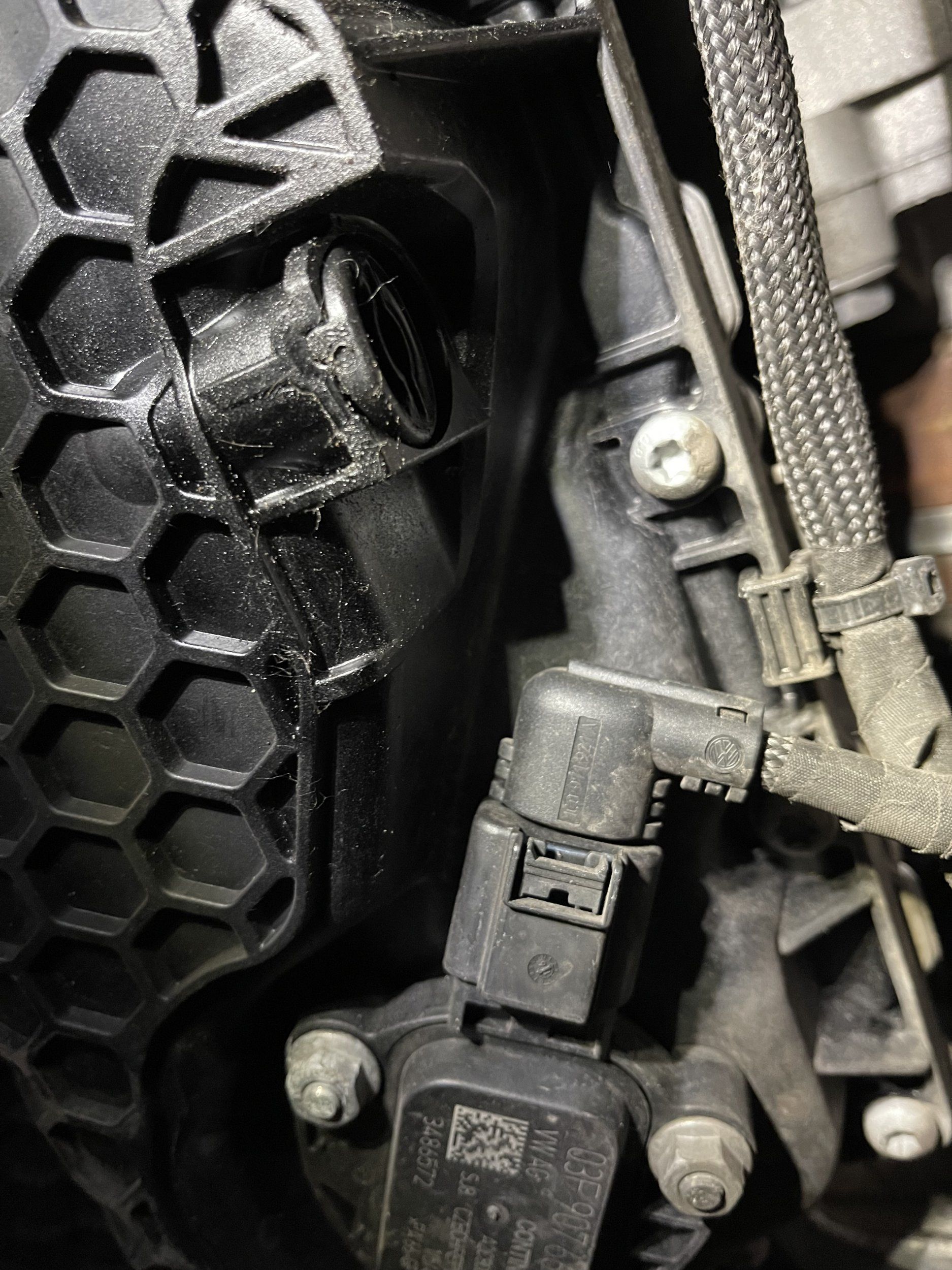

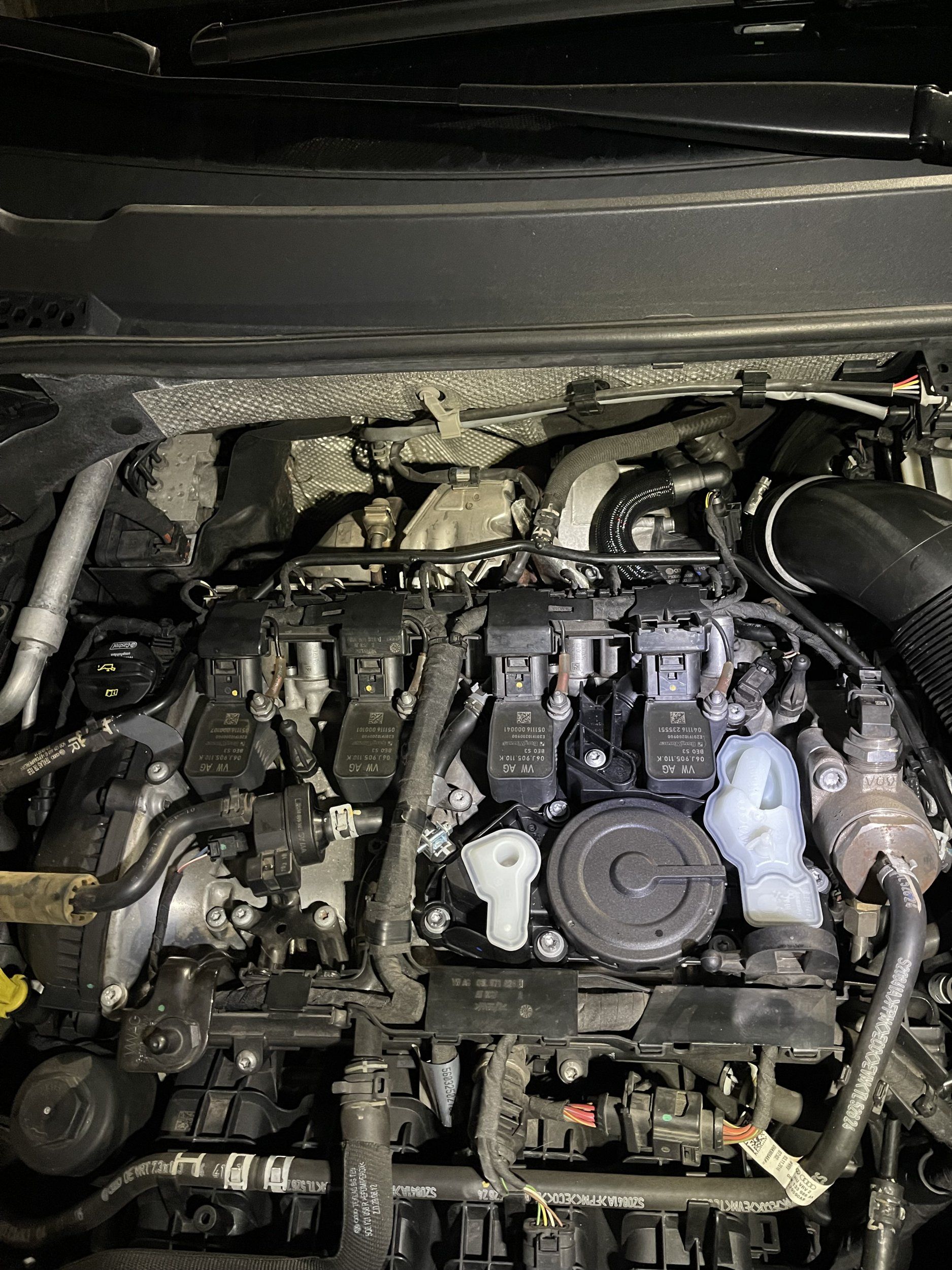

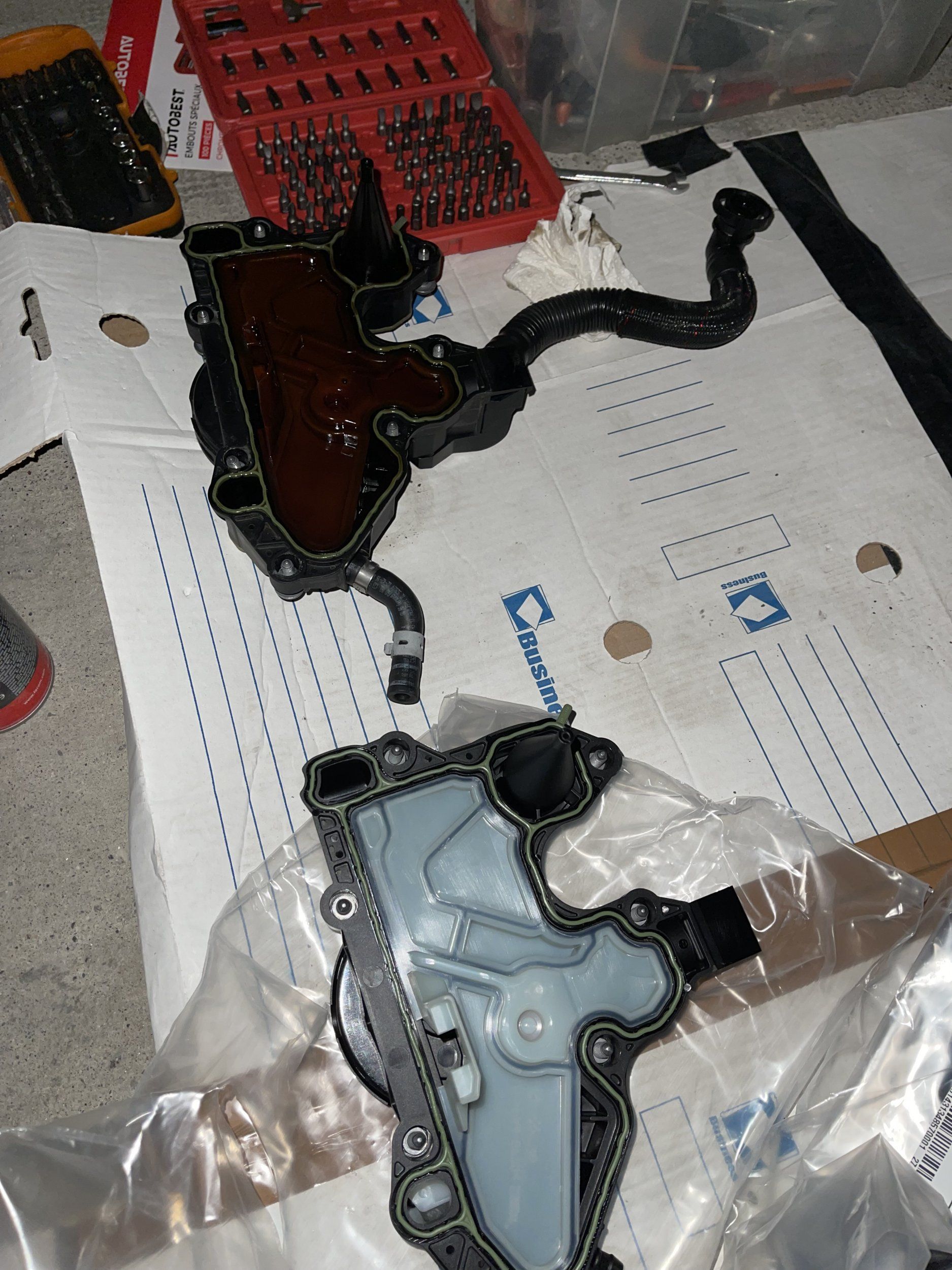

Anyway, got back home and ordered a new PCV along with the hose connected to the air intake. Should install it by the end of the week.
The fact that you only have slight vacuum comfort me in the idea of replacing the PCV. I’ve also noticed some oil around the hose so it might indicate too much oil going there.
I also ordered a new upper cam timing chain cover, cam oring seals and a new oil filling cap since I noticed it was a bit greasy (might be related to the messed up vacuum in there).

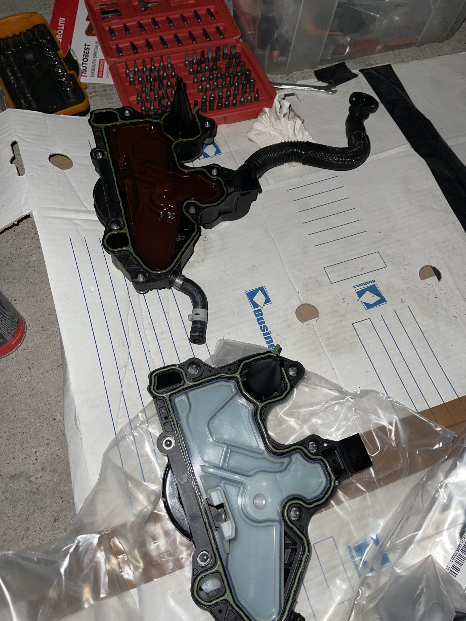

Hi, new PCV just fitted, same amount of vacuum as before and other cupra owners did confirm they do have the same negative pressure at idle..
Don’t know yet for the smoke I’ll drive it tomorrow and let you know.
But after cleaning the oil in the intake & putting back the OEM air box (I had r600 box, pipe, inlet, outlet without remap) I’ve never had again the same smoke I’ve shared on the video..
Only little puff of startup that doesn’t seem alarming at all.
Only little puff of startup that doesn’t seem alarming at all.View attachment 41564

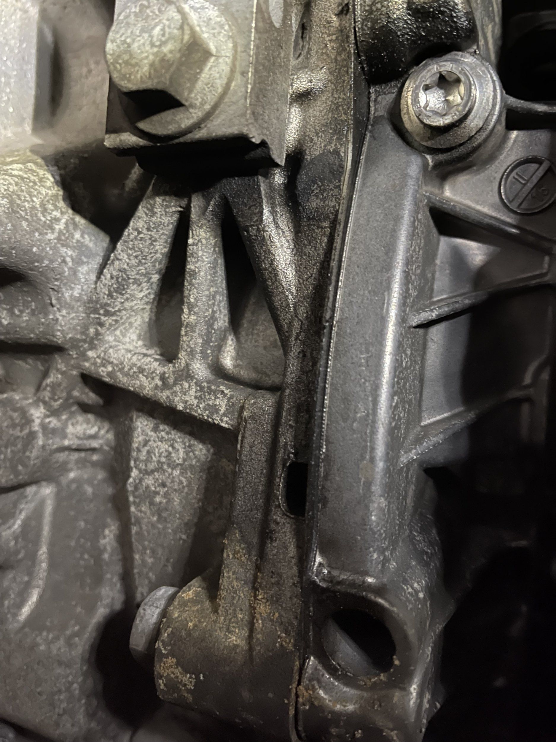

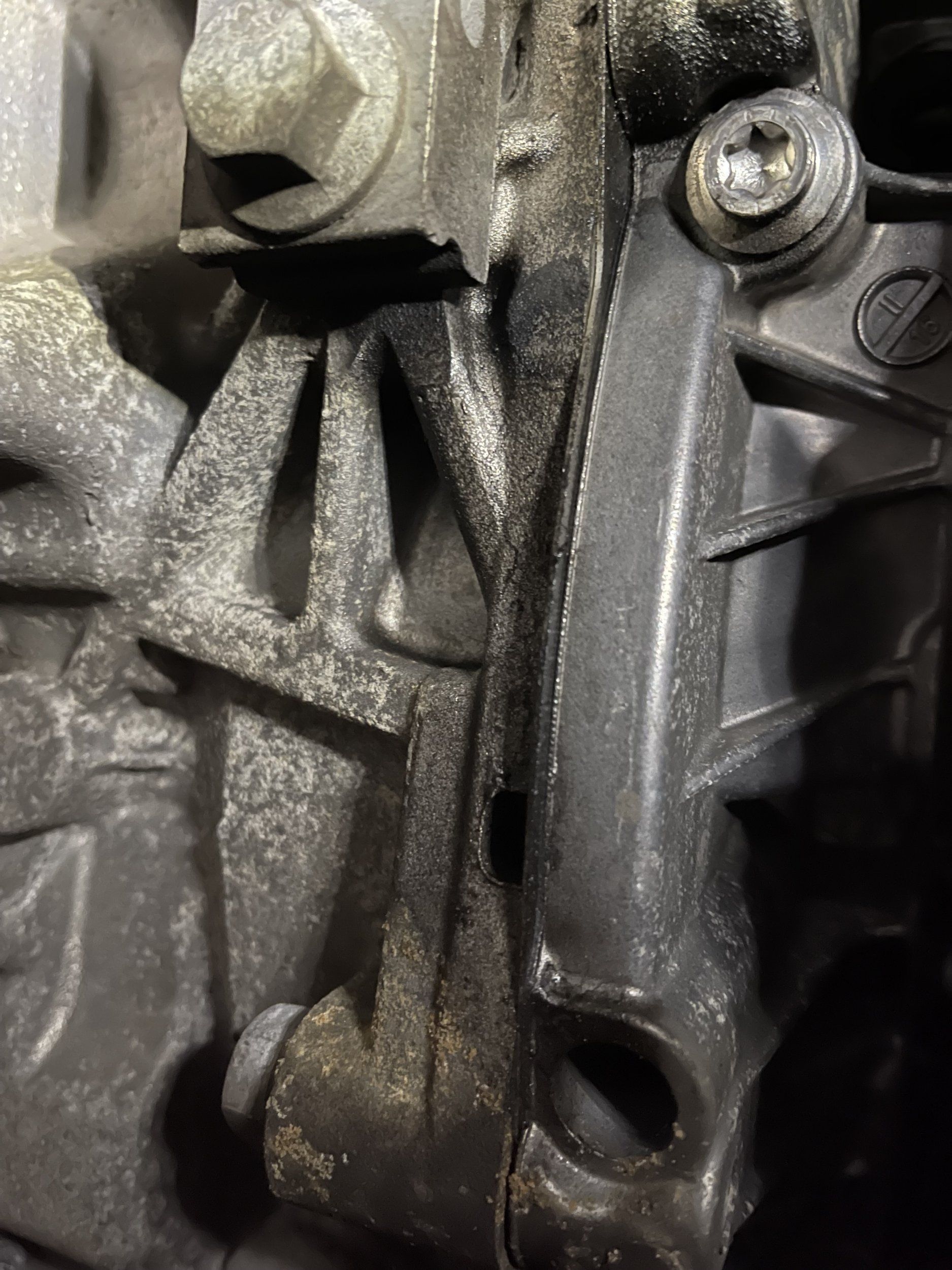

I did noticed some oil under the car around the rear main seal and the purge cap on the oil pan.. this oil wasn’t there before all these problems. It could have been related to a messed up pressure in the crankcase and thus the PCV ?
I’ve cleaned it and will monitor it along with the smokes.
I believe the rear main seal leaking oil is due to a bad PCV (causing too much pressure). Iv seen this mentioned a few times. What mileage is your car? Has it ever been tuned? Tuning it can giving the PCV a harder time and therefore need to be replaced sooner.
Your best bet is it leave the car 24 hours and then monitor it on a cold startup.
Fingers crossed its ok, keep us upto date! Im going to replace the PCV on mine too!

54000 miles (87000km) is low milage. I wouldnt expect the PCV to fail by then. Iv seen people say 60k miles is a good place to replace it. Ill be doing mine next week.
Reactions: AVCUPRA290
Yes and the car is in a really good state from what I’ve seen so far..
anyway I did replace it in case smoke was coming from it failing..
Don’t know if the old one had failed, I was able to blow through it when removed but didn’t try on the new one before putting it in..
