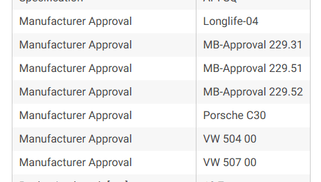

Personally I wouldn't pick this oil- presuming you used: DRIVETEC - Engine Oil LS Pro 5W-30 - 5L ?
it just says;
Meets ACEA C3, API SN, VW 504 00, VW 507 00, MB 229.51, and BMW LL-04 standards.
Oils need to say Approved/Approval - to actually 'meet' and have been tested to the 504/507 requirement - otherwise its just marketing and you have no way of actually knowing if it does actually meet this spec - and the 504 & 507 is quite a high spec to meet.
You'll find all the good oils say Approved/Approval for 504 & 507.
The cheapest oil with 504 & 507 approval I have found is Mannoil 504/507.

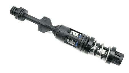

Okay, I had this after supposedly being serviced by a "VAG specialist". Not saying it is your cause, but this was mine: The fugwits had left off a rubber washer off the oil filter housing assembly. This caused it to set off the oil pressure warning at tickover, but not if oil was cold or revving. I immediately took it back, and they said "must be an oil pressure sensor - we see that a lot". The next day, did it again. I wasn't buying that explanation. Took it to another garage who went through what was done at service, and found the washer missing. fitted new filter housing, and been fine since.

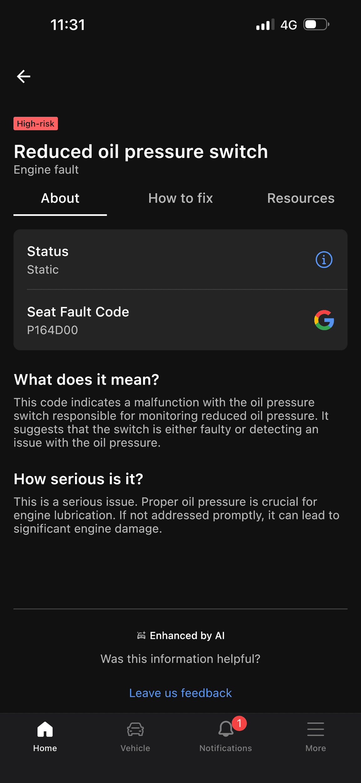

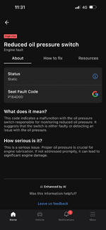

The engine is the 1.8tsi, I bought all the parts from GSF after putting my reg in.
This is the fault that’s coming up

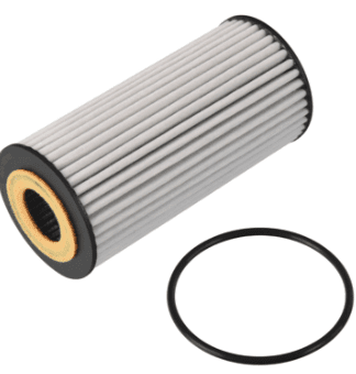

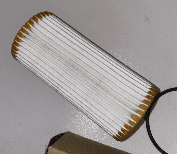

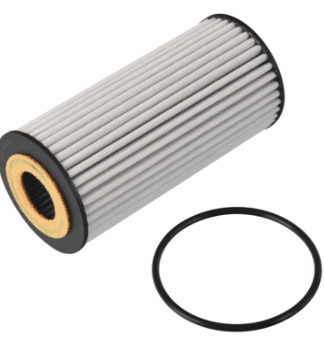

Which parts exactly did you buy?
For example, the Blueprint version has a different design to the OEM (Mann) filter - with what looks like black plastic and a yellow seal on one end.
If you brought the Blueprint version, could this have been fitted the wrong way round? so the seal wasn't sealing?
I would still get it scanned for fault codes.
Blueprint vs OEM (which is made by Mann-filter)

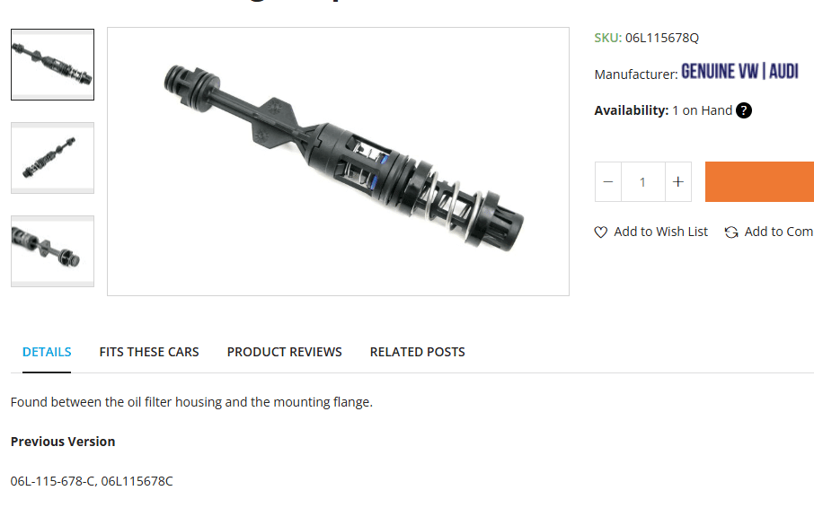

Just to clarify the washer missing on mine, I believe it was the one on the end of the rod check valve assembly? [I think, I didn't take it apart, but the guy showed me a breakdown diagram -the long bit that goes down the middle of the filter, has a washer on the end of it]. The washer was missing off the end of it.

i bought the mann filter: MANHU6013Z ive posted the code fault. might need to take it back to the garage that serviced it for them to have a look.

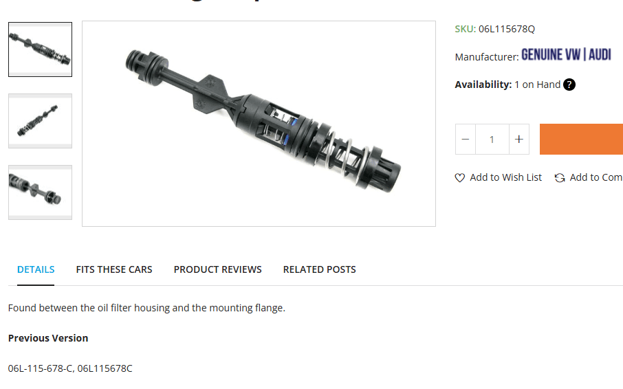

One of these: 06L 115 678 C

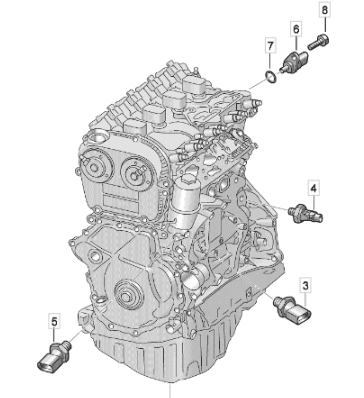

Ok, so it's not your filter.

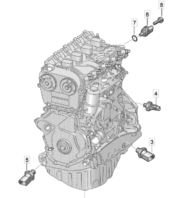

Looks like you have 3x oil pressure switches on your engine.
3 (brown) ,4 (green) ,5 (blue):
There can be a lot of causes for the low oil pressure, hopefully its just one of the switches.
Could also be the oil pressure control valve - or the associated wiring to each, or the previously mentioned o-ring.
Additional info: This is for facelift, for prefacelift you need:
Partnr 06L115678C

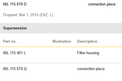

Seems like C was dropped in May 2017:
ShopDap for example, are showing a supersession from C to Q:
On the 2.0 I can see another supersession - but also including a new filter housing!
Personally would just get some new 0-rings rather than the whole assembly - annoying when they don't list these separately.

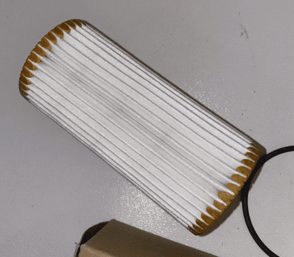

I just realised my oil filter is under the hood, so I can check the o ring myself. If I remove it can I put the same on back in or is it recommended to put an entirely new filter ?
