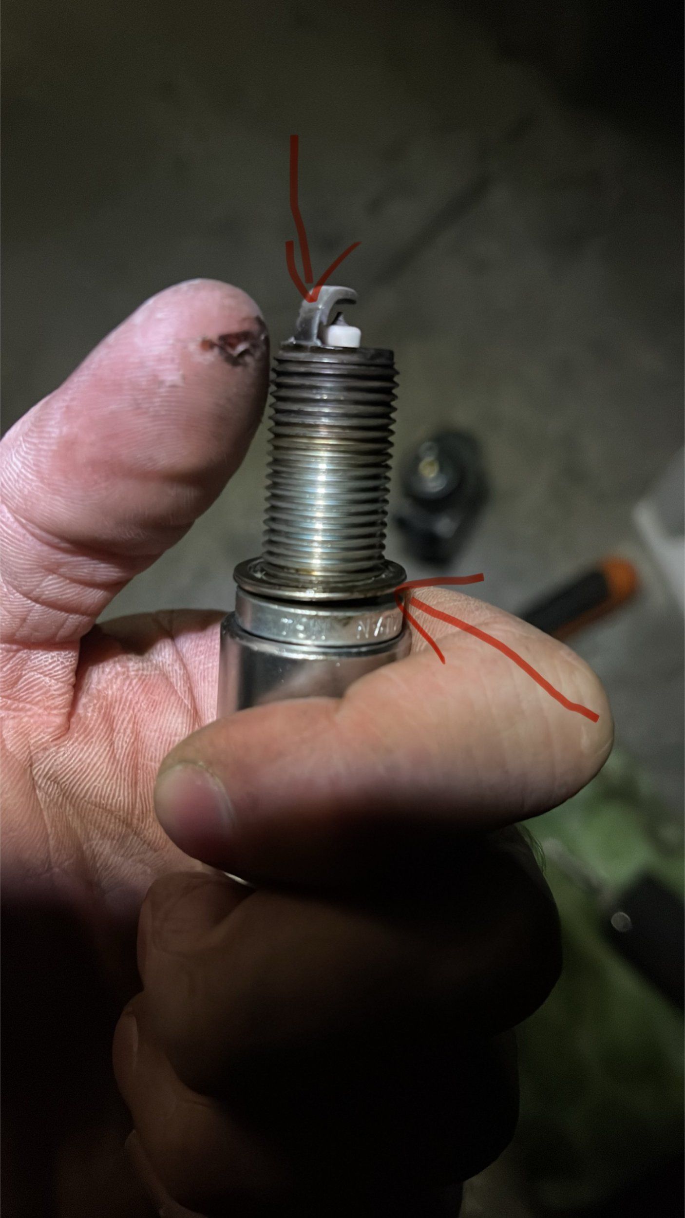

Valve cover? Can be, because I found some oil on spark plugs threads on 1 and 4th cylinder. but the spark plugs head was clean. How can oil get to the cylinder from threads, it should be sealed when tightened?Right or wrong?

Do you have any oil on top of the spark plugs or on the spark plug threads? Pop your hood, pull the plastic engine cover, pull the clips on the coil packs, then pull each coil pack and check your plug wells. If there’s oil in there at all that’s your problem. It’s not uncommon for oil to seep past the valve cover seal and drip past your plugs into your cylinders. If it sits and builds up it’ll burn off right when you start and you’ll get smoke.
If there is non then it could be your PCV and i would replace it. Then if that doesnt solve it maybe it could be the valve stem seals however valve stem seals would be a big puff of blue smoke.
Its coming from the valve cover, there is a sealant (not a gasket) that covers between this and the top of the engine... its leaking and its common. This is your issue NOT valve stem seals. I believe its like a 1k job.

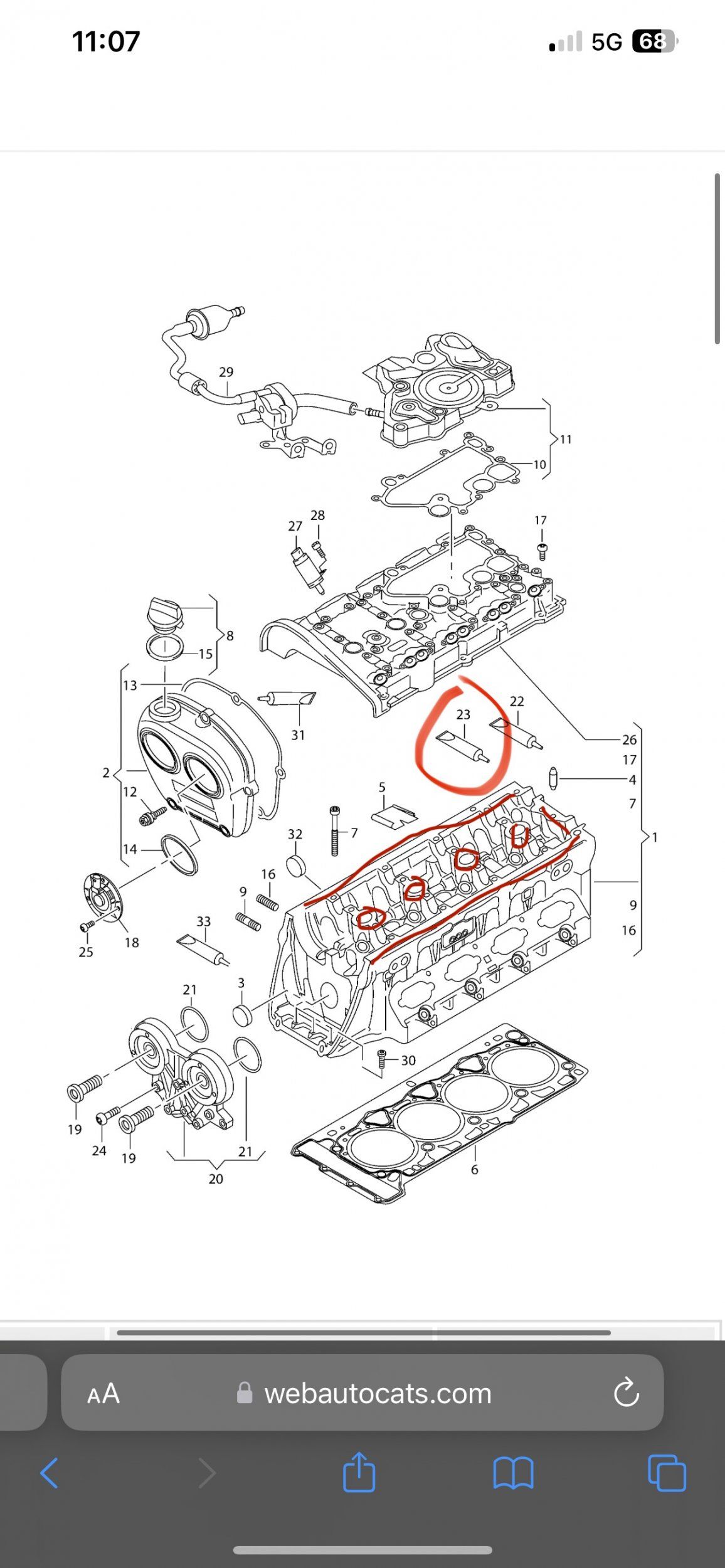

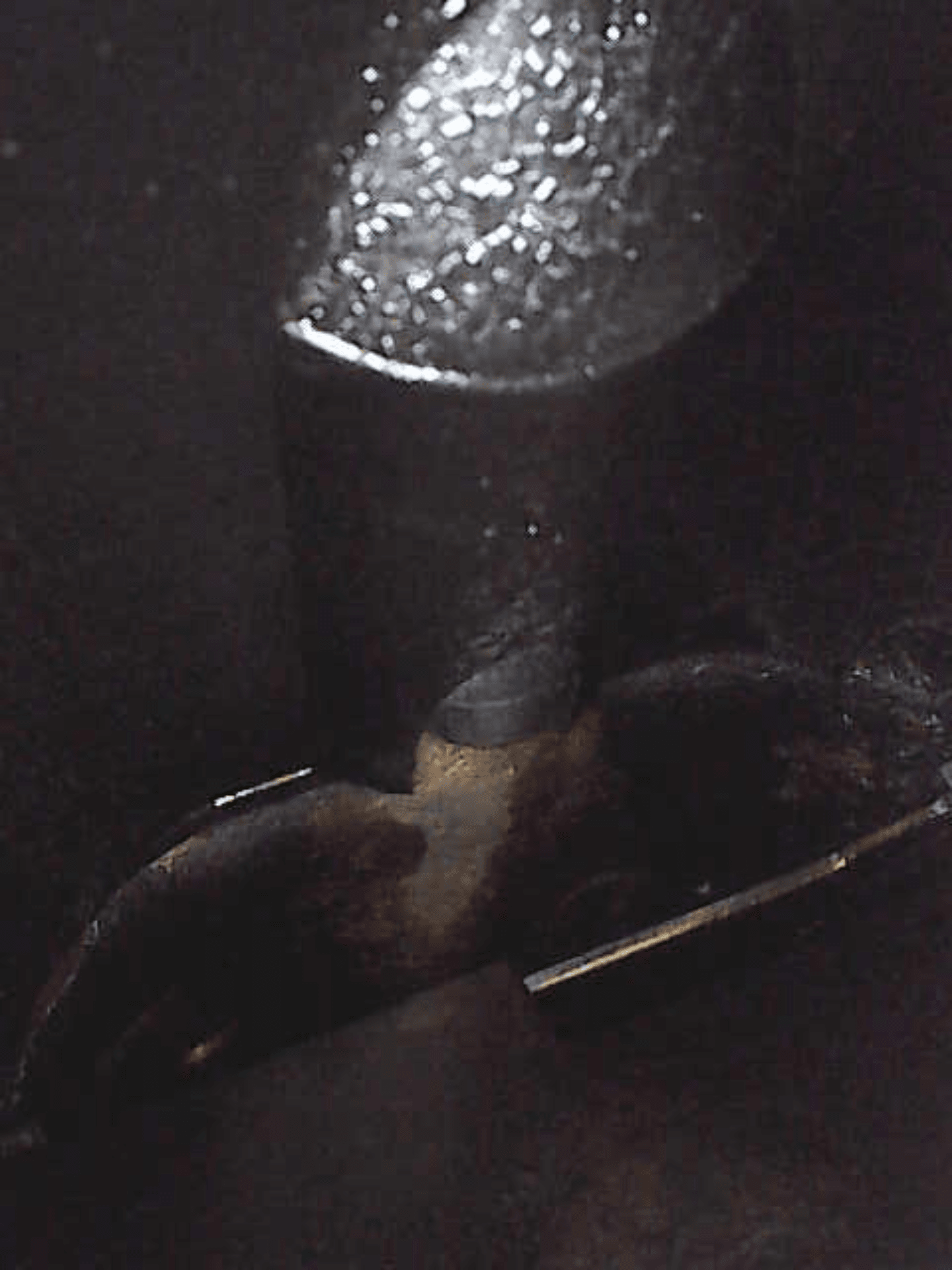

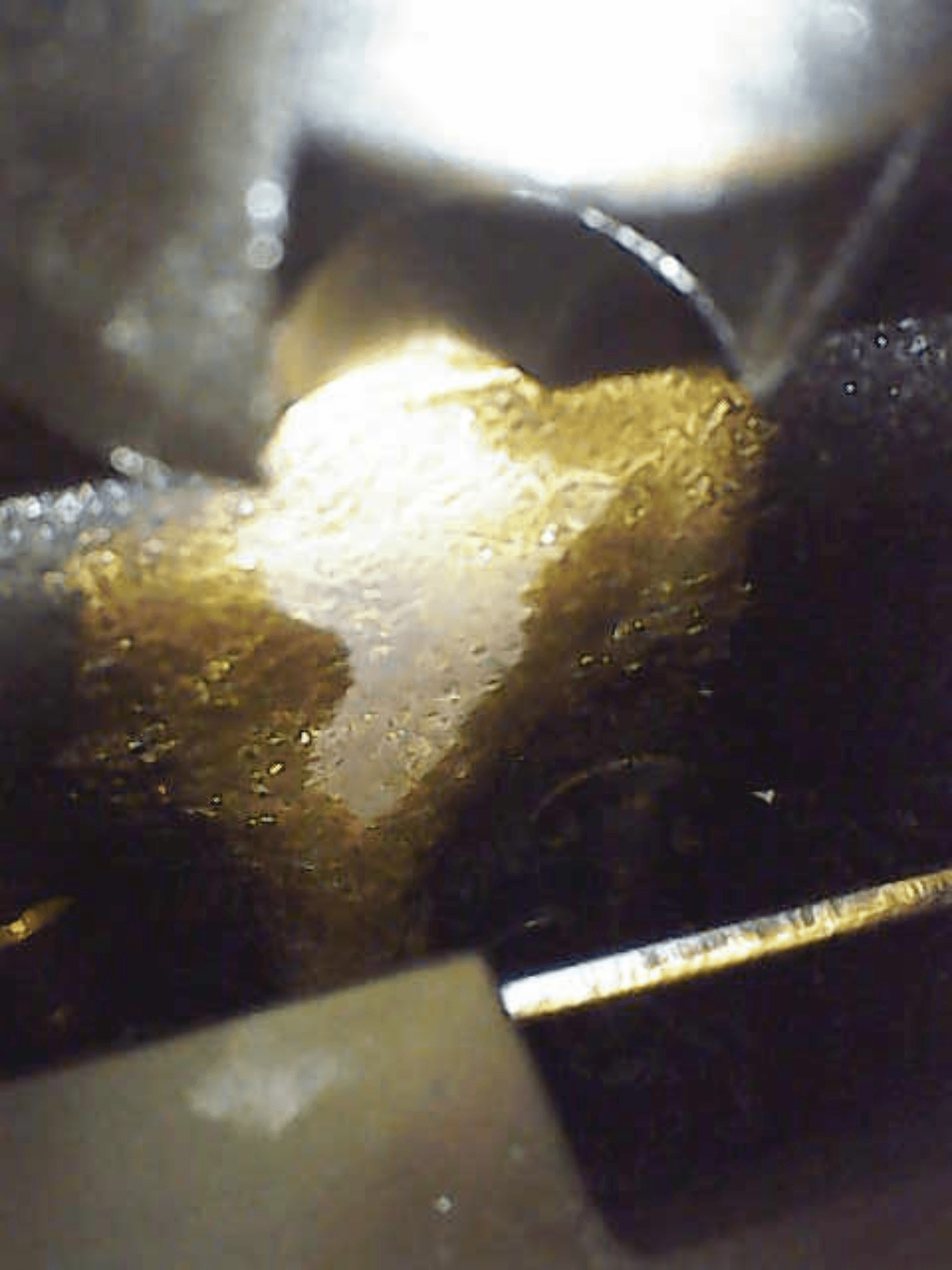

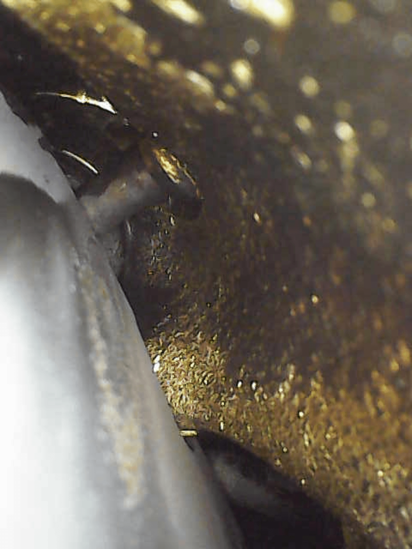

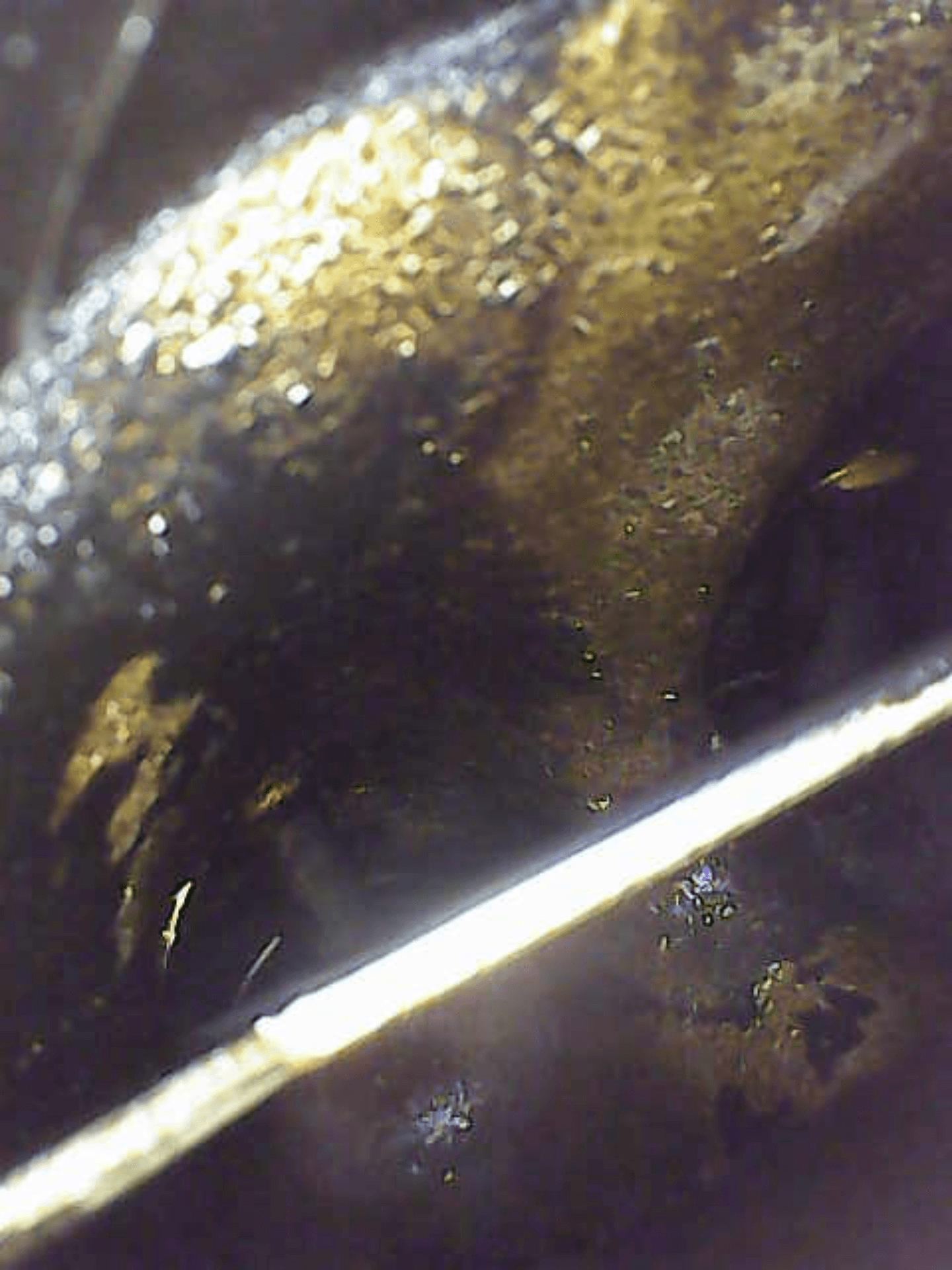

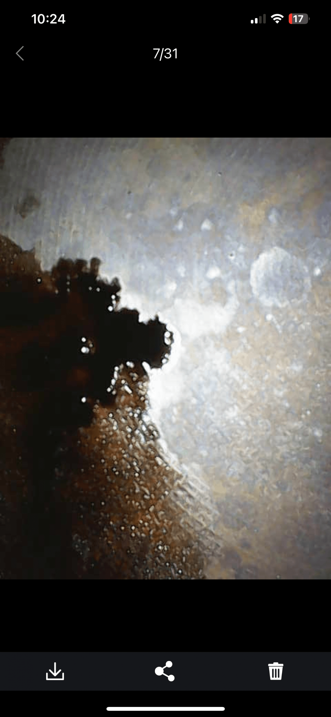

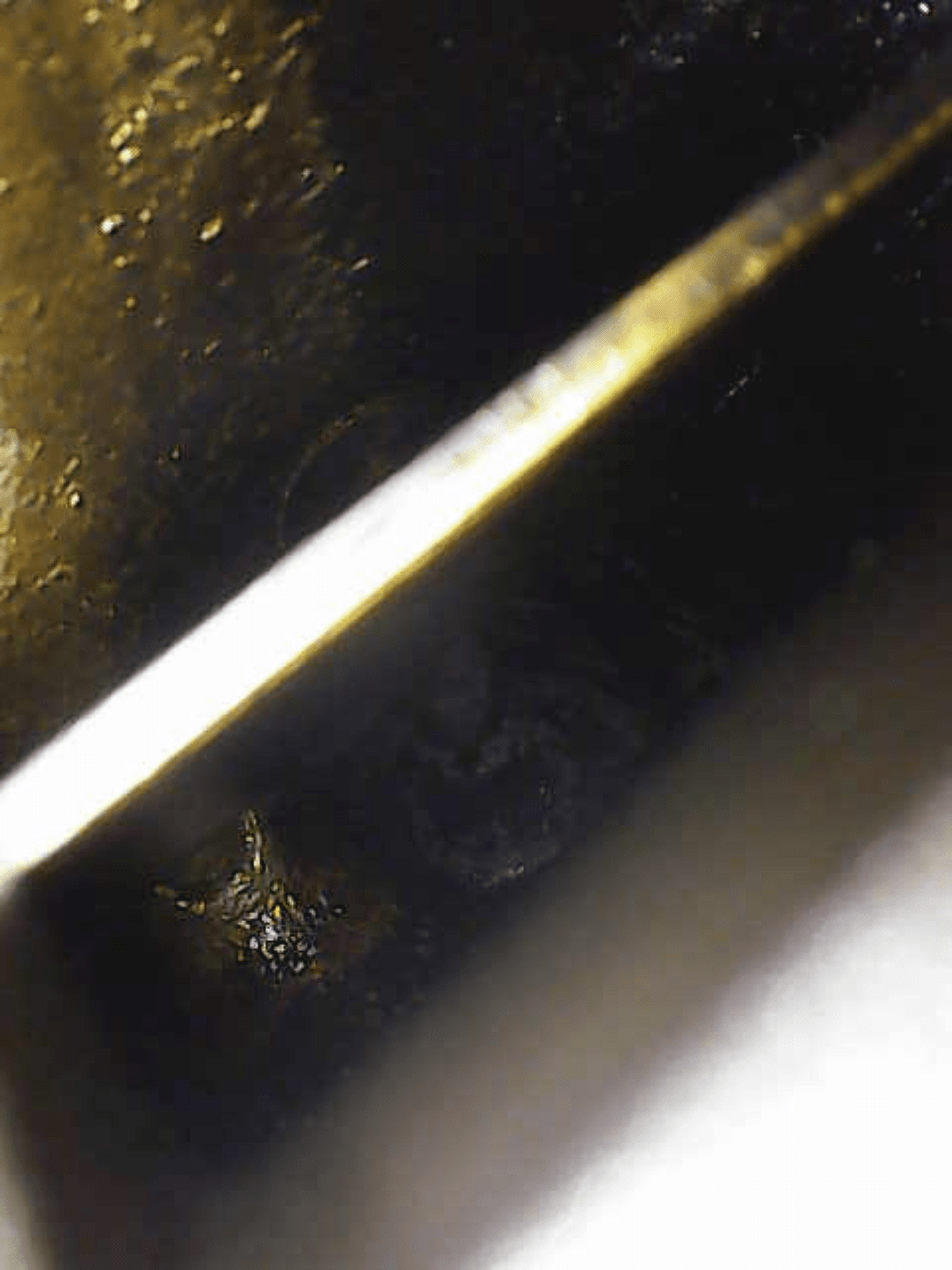

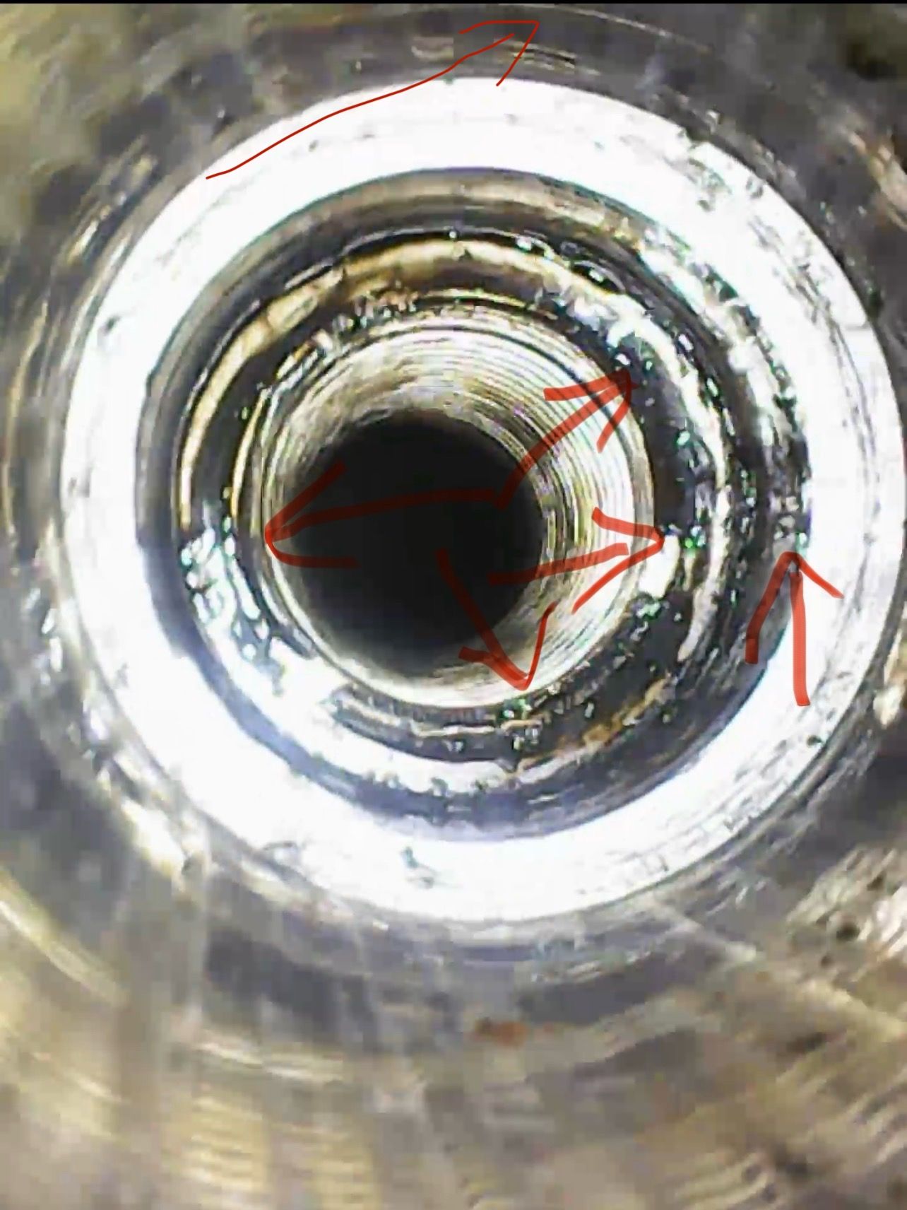

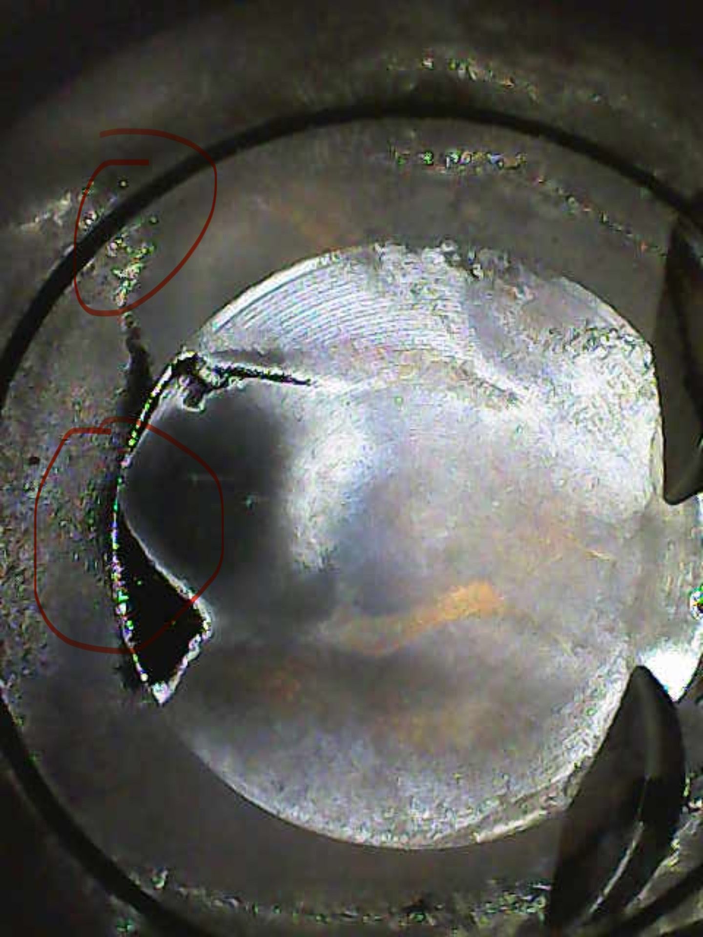

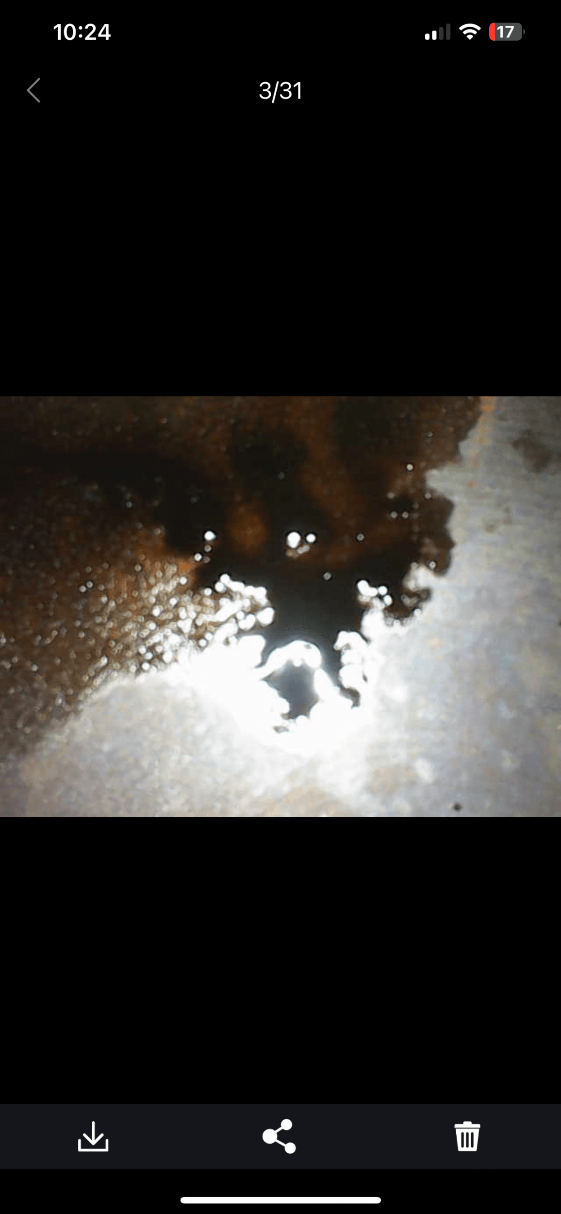

One mechanic told me that but it cannot come from the valve cover. If you look at the picture, if oil was passing through the sealant it will fill the plug well and not go inside cylinder. So it will in the worst case cause misfires.
But there is no way the oil is dripping along the plugs if they are screwed..
or there is another way for the oil to go inside the cylinders but please let me know I’ve considered this option with no viable answer.
+ I didn’t see oil within my cylinders and still got smoke on startups.

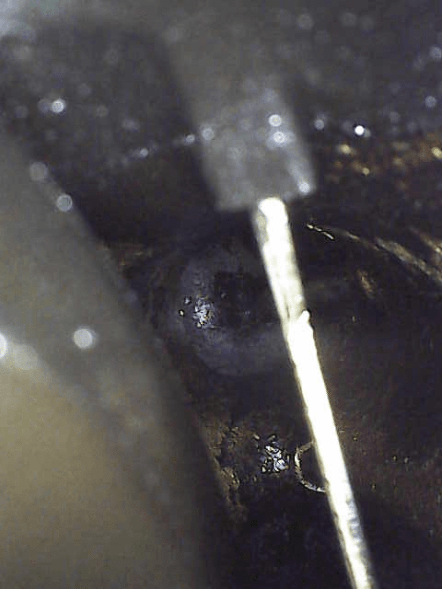

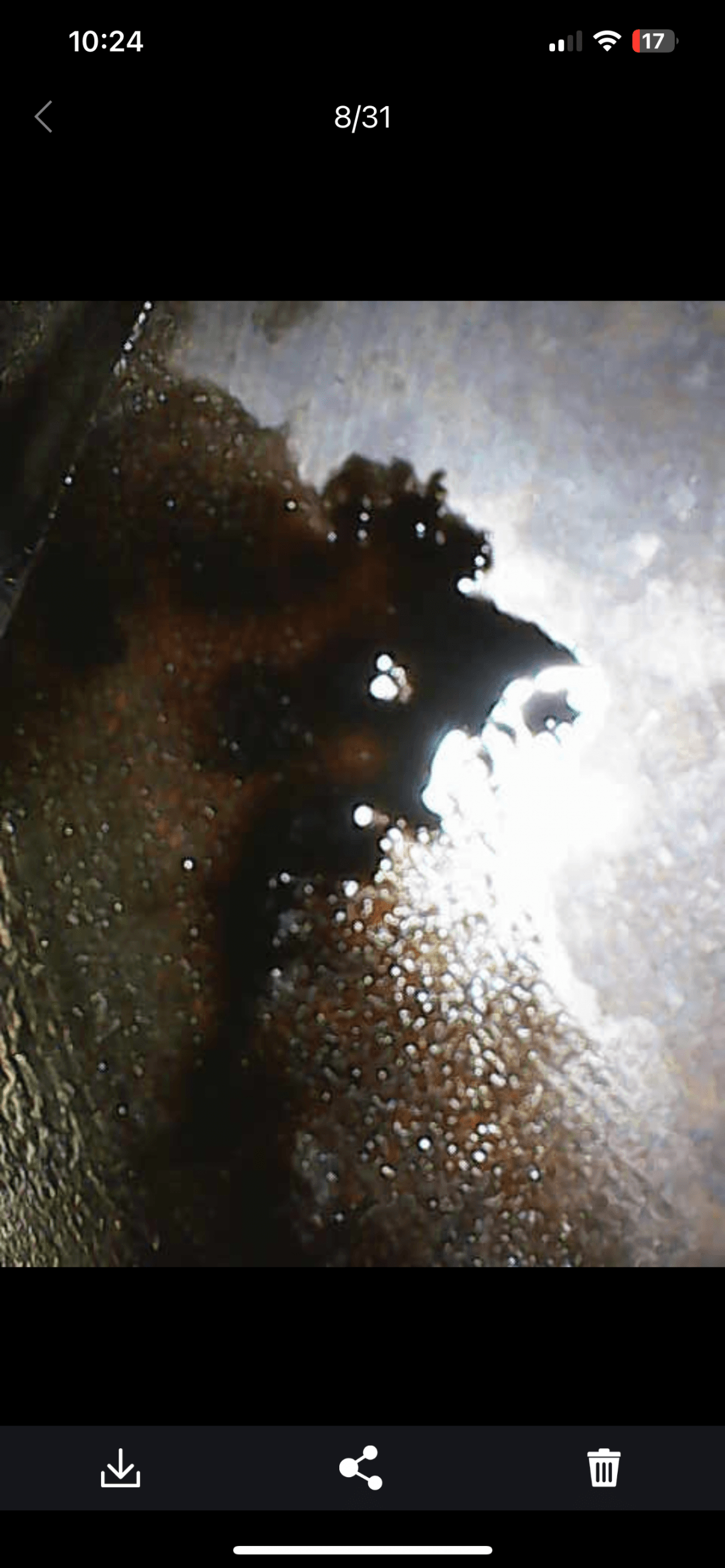

below some pictures linked to this valve cover idea. I’ve found some green residue of the sealant when I’ve looked into the wells with a cam, I think the one in the cylinders fell in because of the cam. The other green bits were in the well where the plug is. As you can see there is no oil on the plug thread..
The sealant is probably under some pressure and heat or my old PCV messed up so pressure was higher and some sealant moved.. don’t know why I got some. Maybe I took the plugs out too many times also.
