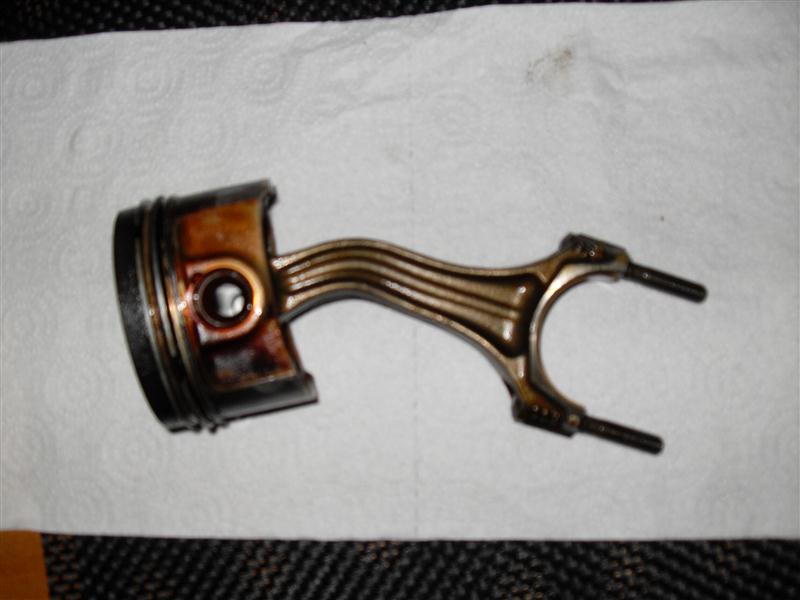

think of this happening
210 Audi S3 suffered this.. also broke off oil squirter and portion of the base of the cylinder wall on cyl #3 - eak! :(
also, is there anything else I should do down there while everything is henging out anyways?
Well, that's graphic enough. At this point the block is scrap, from the bent rod smashing into it I'd guess. Pretty much time for a new engine, I'd have thought.
