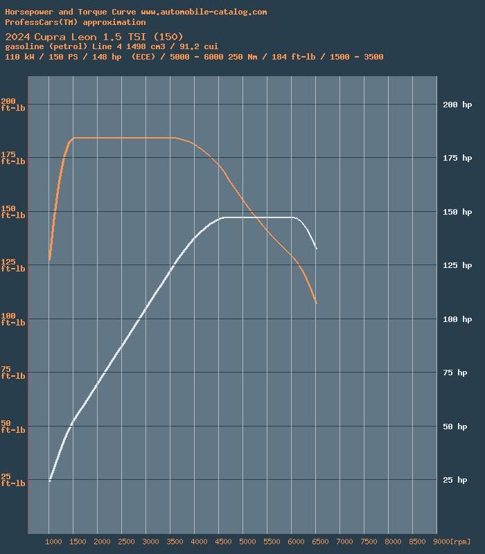

Probably just that 6th gear is extra long for fuel economy figures, and 70mph isn't giving you enough revs for the turbo to build the boost that's needed to maintain that speed up a incline. I would try the same hill at 80mph and see if it can manage that.
Edit What RPM is it doing at 70mph in 6th? Here is the torque curve, if it's 1500rpm or above then it should be able to maintain speed, less than 1500rpm and it won't have enough boost.
Edit What RPM is it doing at 70mph in 6th? Here is the torque curve, if it's 1500rpm or above then it should be able to maintain speed, less than 1500rpm and it won't have enough boost. View attachment 42675
Thanks for that @mty12345 I’ll check tomorrow what revs it’s doing at 70mph in 6th. Is that torque curve for the manual? I’d assume the automatic has a different torque curve with a narrower peak torque band than a manual.
I'm pretty sure that graph is at the flywheel and is probably the manufacturers data rather than a 'dyno run', but i'm not 100% sure.
Went for a drive today, at 70mph in 6th it’s doing 2000rpm
