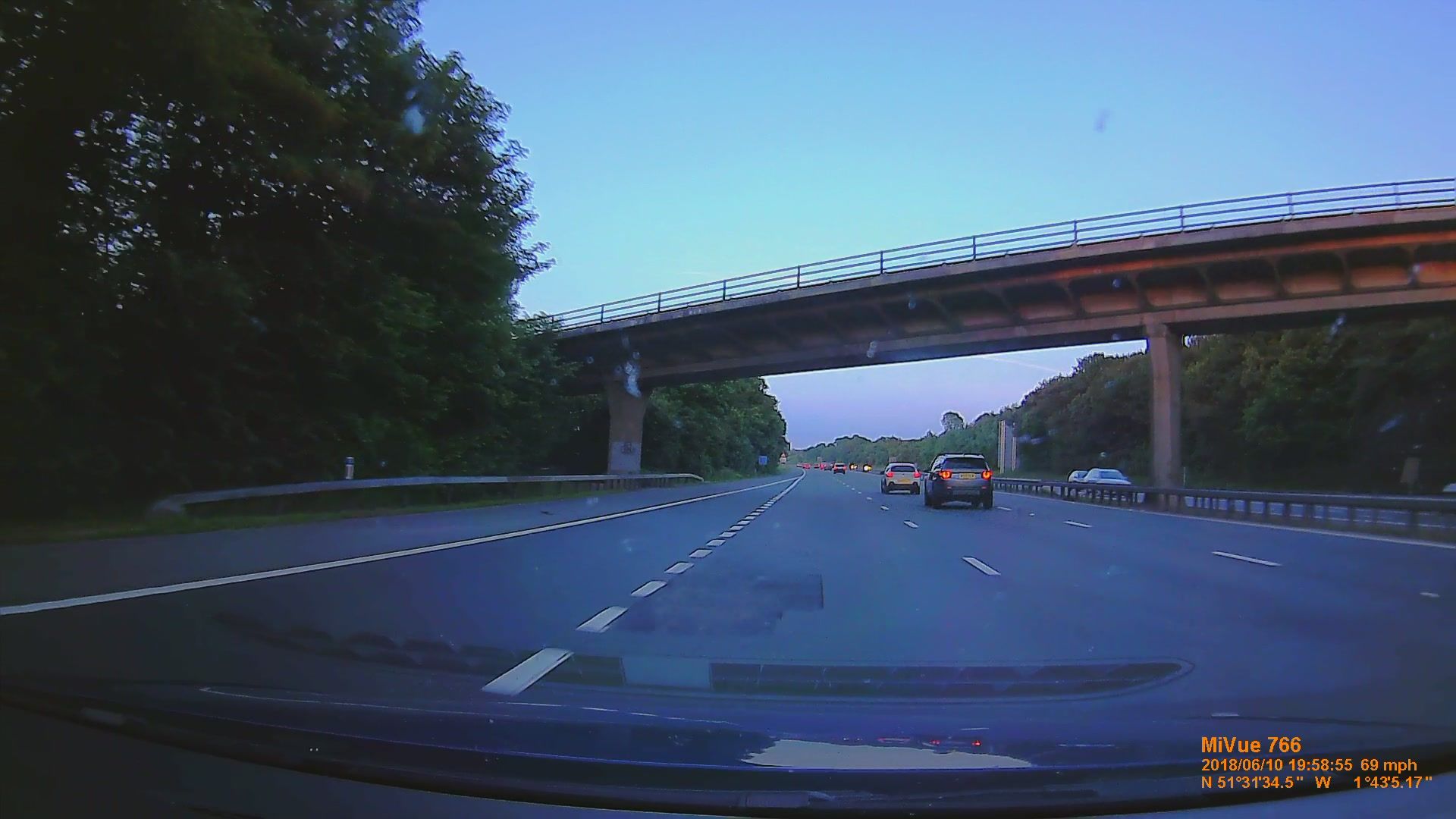

updated first post with video / picture from dashcam ...
It's hard to see how deep the hole was .. but u can hear the bang

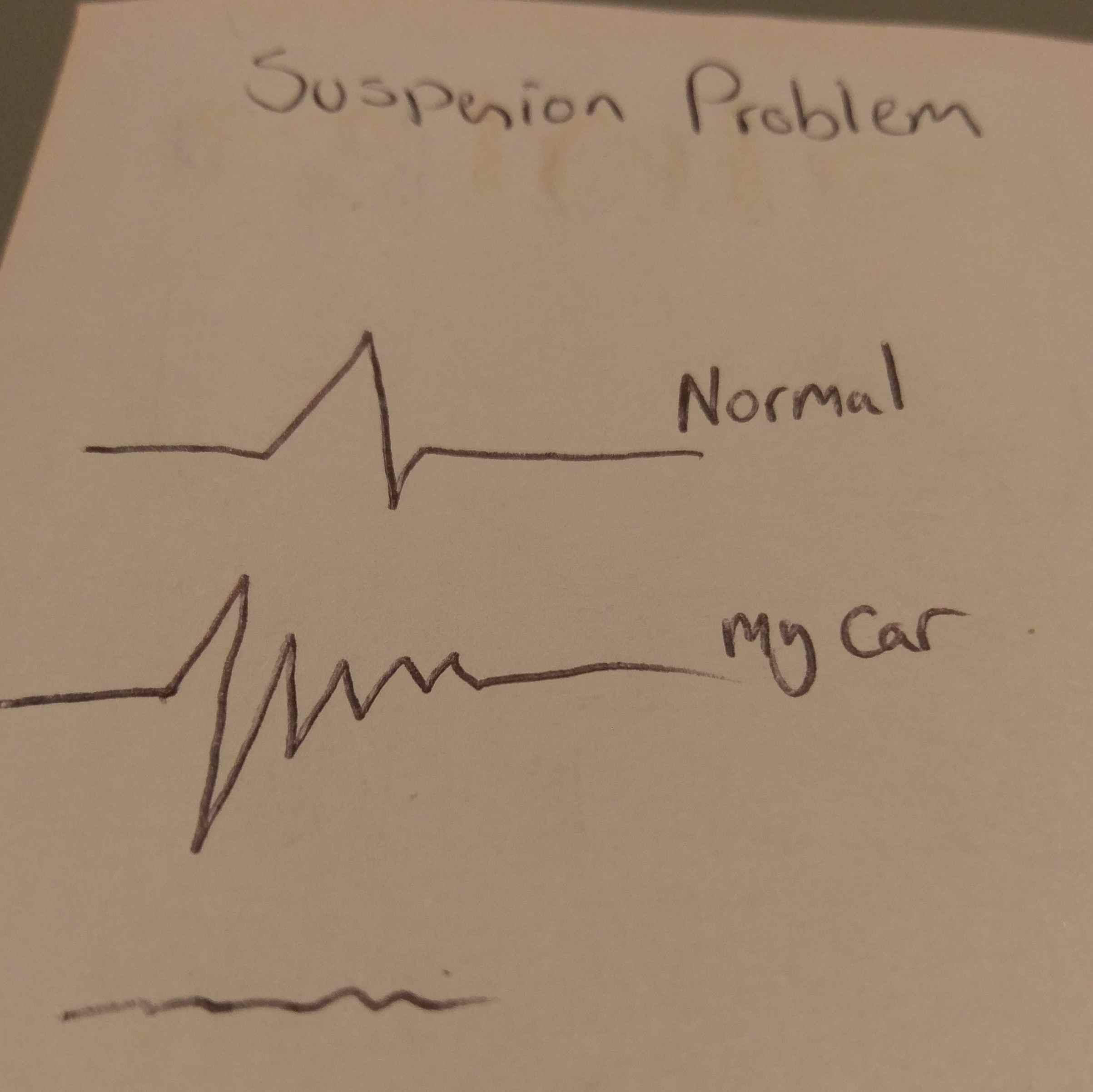

Be mindful me and a few others have issues since hitting big pot hole. No obvious damage but just odd dampening, feels like jelly when hitting some bumps and has a tiny after shock wobble So hard to describe
Could be a bent/damaged shock absorber, or other suspension component. A high-end wheel alignment check might help diagnose it.
If only if was that some. There is no visble damage, even had a seat master tech look visivally and he couldn't find any obvious issues. My guessing is the strut but until I replace then won't know.
