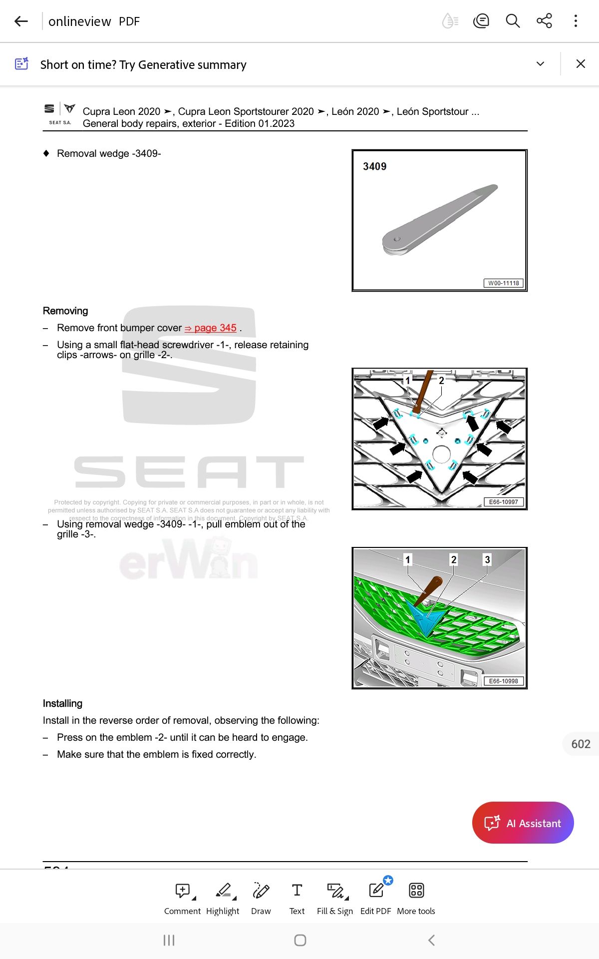

I have a damaged front badge and want to order a replacement, however I cannot find a guide ANYWHERE on how to properly take out the front badge to replace it.
I know that there are clips behind it and to get to them you might need to remove the front bumper, but I also cannotfind a guide anywhere on how to do this either.
Has anyone successfully removed the front bumper/badge and can provide detailed instructions on how? or if anyone knows of a video I have somehow missed that would be even better
I downloaded them a while ago and they come in useful, its about 700 pages long
