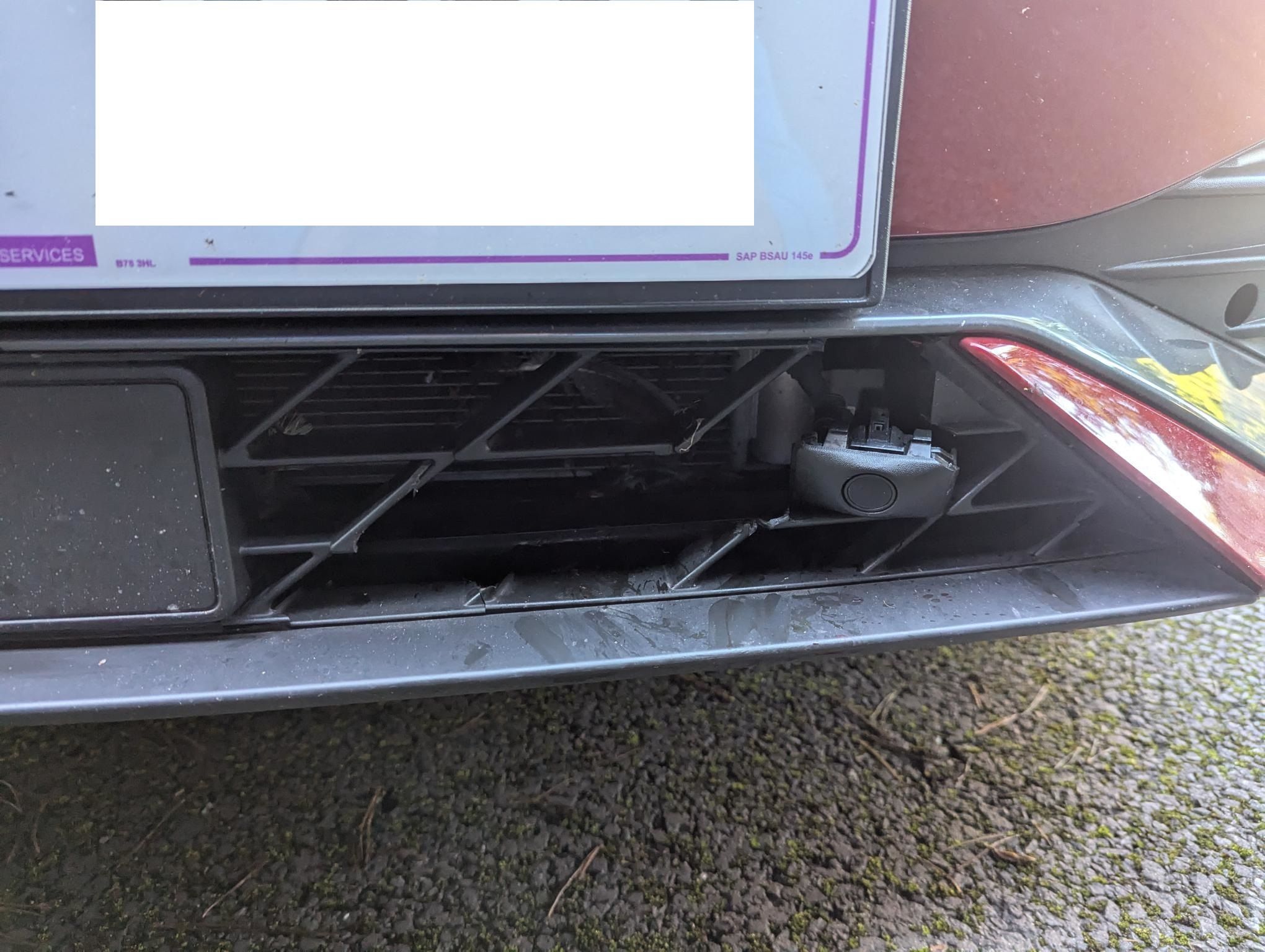

New to the forum - 2023 Cupra Leon V1 driver here! :)
The other day I hit a pheasant at about 50-55mph and it damaged my lower grille - the one that holds the two parking sensors and the cruise control radar. Doesn't seem to be any damage to bodywork or radiator etc, but the impact dislodged my passenger side parking sensor and also the radar from the middle of the grille (and broke some of the plastic). These have since been cable tied back in place and the parking sensors and cruise control all seem to be working ok, so think it's just this grille that needs replacing.

Images attached for reference (taken before things got cable tied!)

I think he'd had a pheasant go through the grill at 50mph, so that big hole improved access enormously - your issue is different and sounds like it just broke the radar free from its mount.
