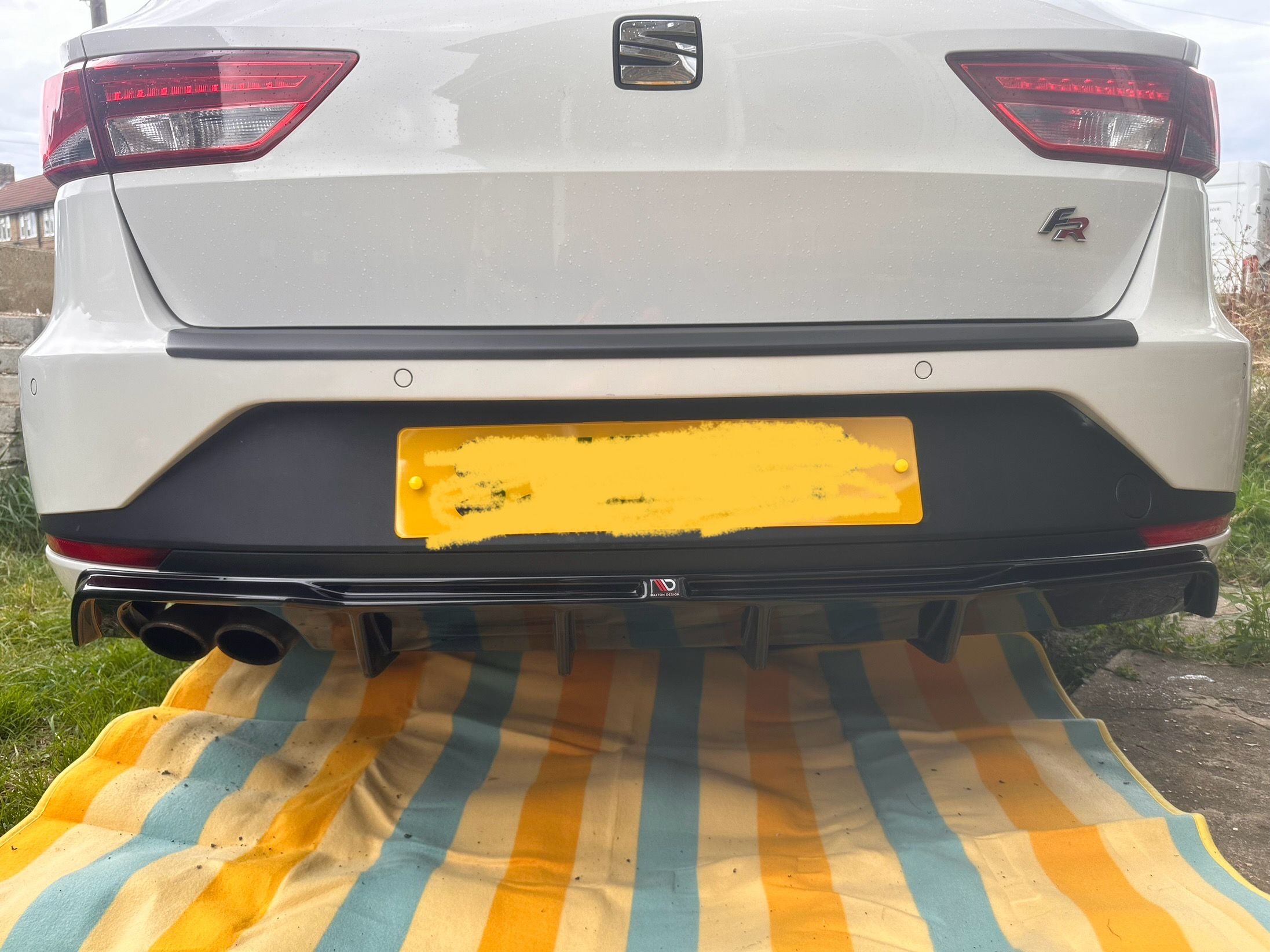

Hi guys, recently bought this for my Leon estate: https://www.maxtondesign.co.uk/body...lance-seat-leon-fr-sportstourer-mk3-2012-2016
But I'm struggling to see how it fits. I understand that you unclip the standard diffuser on certain leon models but there is nothing on the st (estate) to unclip and this fits ontop of the rear bumper. Anyone know how it secures in place?
There are about 6-8 self tapping screws provided but these go underneath therefor hidden, but this leaves the top part of the diffuser loose? Can anyone help? Please
Hi mate not sure if you ever ended up getting this sorted I had the same issue by miracle I had some 3m tape laying about and ended up using it on in the inside of the top lip,
I ended up fitting it in place with the self tapping screws then once It was in place I was able to peel back the 3m tape whilst pushing it into position
