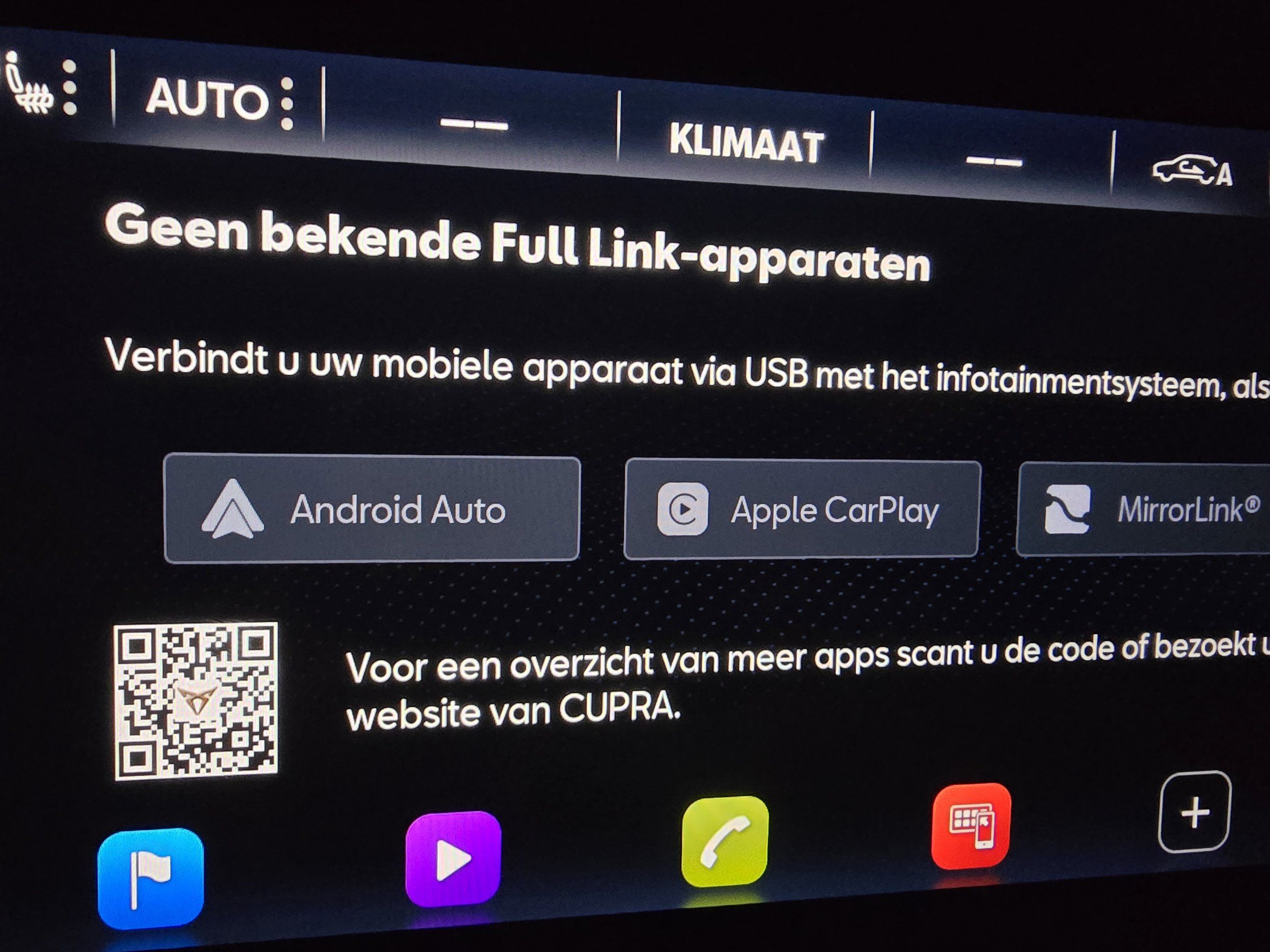

I have a cupra leon 2021. When i want to use android auto, it work well with usb cable. When unplug the cable, android auto is gone.
Any way to get it working? The 3 icons (apple/AA/mirrorlink) changed to grey when unplugged.
Thanks

You need to ensure your connected both the Bluetooth and the in car WiFi.

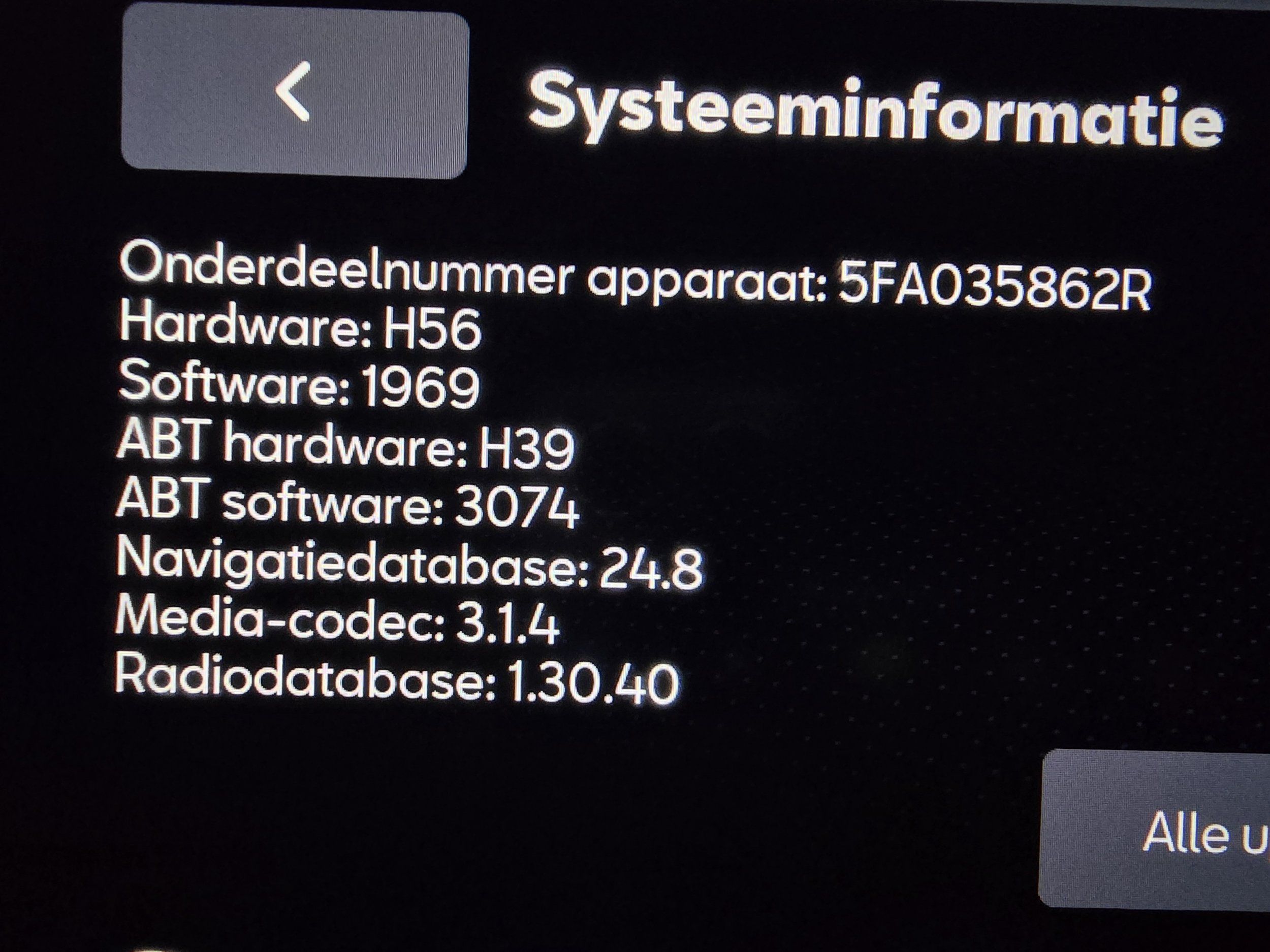

I Got an Galaxy s24 Ultra on Android 14. There is no option for wireless connection. Is it possibile that it has no wireless options? I have to buy a obdeleven for check then?
No way that S24 Ultra does not work wireless. My Samsung A34 works...
It was so easy that I don't remember specific way, the only thing I remember was that you need to have car wifi working, BT paired mobile and then for the first time use cable and I have some confirmation on the phone as well (just follow the instructions). Pretty easy setup.
Try to reset unit, setup wifi, pair BT and plug your phone.
