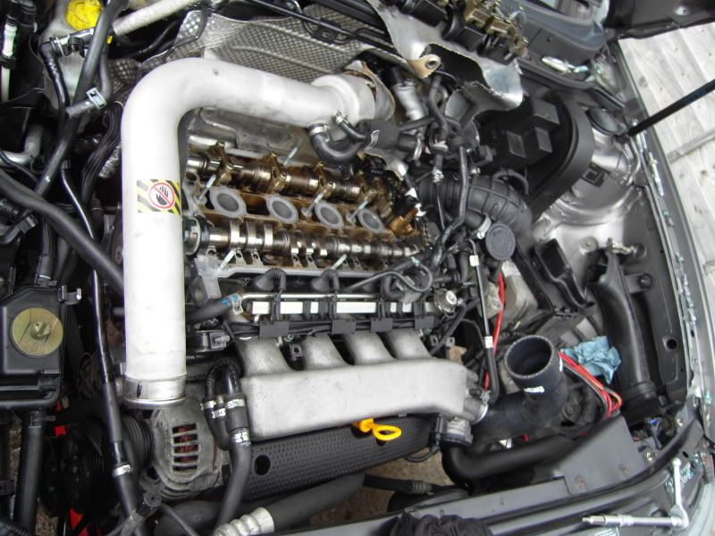

Its not simple thats the thing, i dont have a video as i didnt hire a camera man lol
Only pics i got -
If your not confident you can do it, id pay for somebody to do it with know how. Last thing you want is do it wrong then try start car and lose engine/top end etc.
Just my 2p worth.
Only pics i got -
Just my 2p worth.
that picture brought back some knuckle cutting memories of replacing my brake servo!,
|I found the 20vt one of the easiest cambelts to change, its just access thats the ball ache!
& totally agree, its not hard just logical thinking, get the timing wrong and you'll have 20 valves dancing on your bonnet,
if youre confident, do it, if not get someone who is .....
from what i remember though getting the cover in and out was a pain, take your time with it and you'll get it out, I also remember getting it past the mount and m/C after fitting the cambelt took a good 10 mins to find the right route,
a bottle of tippex comes in handy too, mark up the cam sprocket and bottom pulley and transfer the marks to the belt before removal, as long as you mark cam and crank you cant theoretically get the timing wrong. (you'll most probably already know this anyway!)
Thats what i was doing lol Thought id do the cambelt etc while there!
