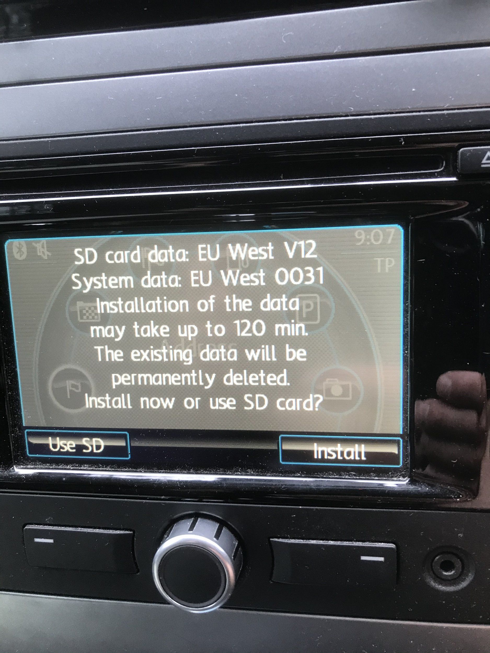

I have just bought an sd card and have the same message. Wasn’t sure whether to go for the use sd option or install? I’m guessing it’s the install option right?
Legojon
I only wanted a remap
Jul 7, 2015
5,316
2,748
Personally I'd go with install. It takes a couple of hours, but then you can take the SD card out. The other option just reads the map data directly off the card - so you have to leave it in 24/7 and I imagine it'd be slower. Whilst installing, you can turn the engine off and take the keys out as many times as you need.
If you INSTALL, there's less chance of data corruption, as it becomes stored in the head unit. Like sd cards in cameras, for example, there is the increased chance of data corruption the more often the card is read/written to/from. If you experience data corruption in the head unit, you have a virtually unused sd card that you can reload the data from.
Reactions: Legojon
Jun 6, 2020
6
Thanks for the response.
I did ask the company who I got the card from and they have just advised To use the sd card option for first 2 weeks and if no problem then use the update function so I’ll probably do as they suggest.
