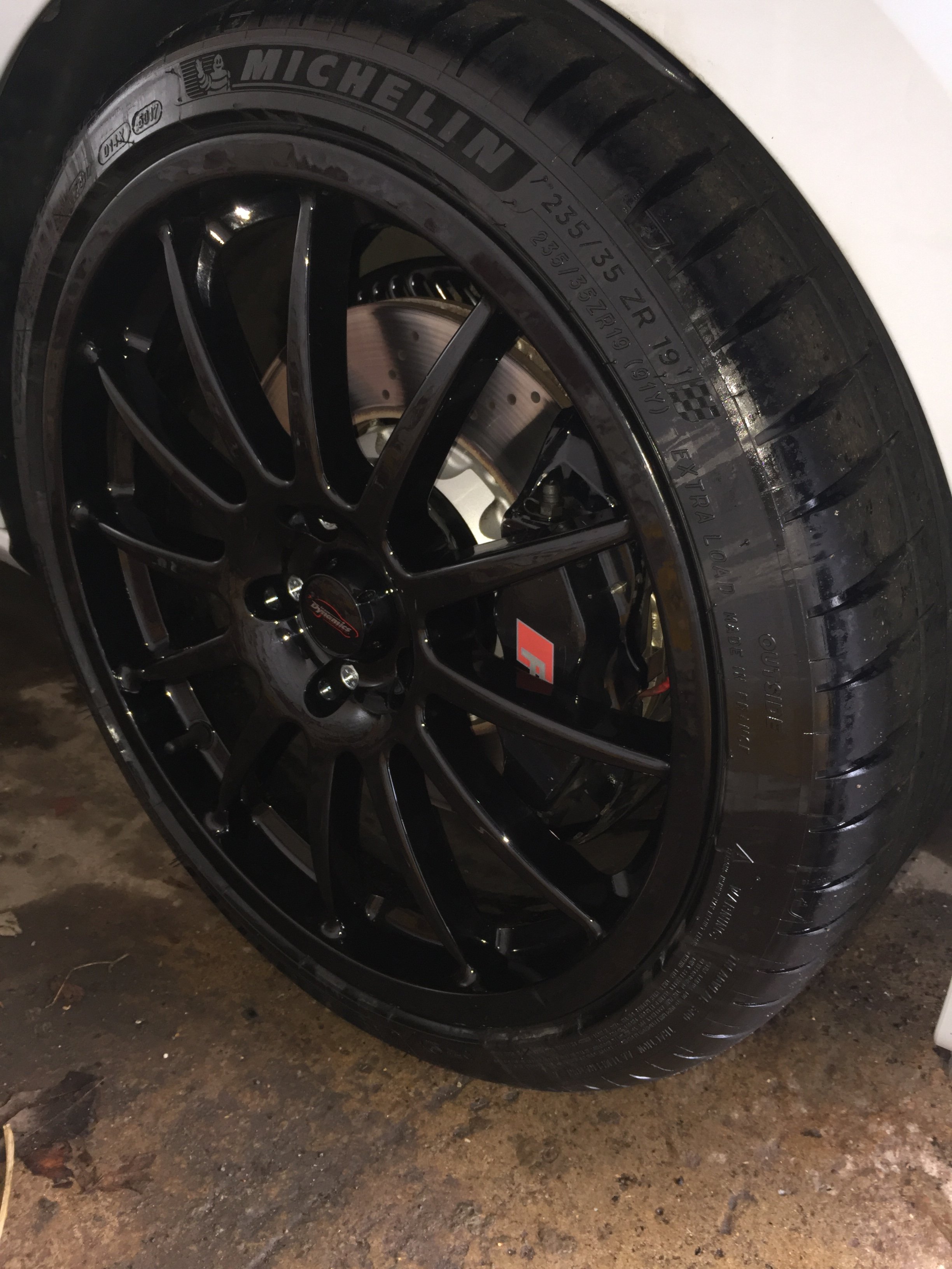

Well the brake upgrade is done.
TTRS calipers, RS3 vented dust shields, RS3 brake ducts, Vagbremtechnic caliper adapters, HEL braided brake lines, GTI Clubsport S discs, OEM pads for road and Brembo fast road/race pads for track and 5mm spacers to clear the calipers from the Team Dynamics 1.2 alloys 18x8” - 5x112 And ET45. Discs are 900 grams a side lighter than OEM and the calipers are a shocking 6.5kg a side lighter. A total saving of over 15kgs on the unsprung and unsprung rotating mass, which makes a huge difference.[B)]
REVO engine and transmission mounts also went in the car, which tightens things up nicely, but does give a little extra NVH.

Oh my...that is the exact same brake upgrade I’ve been kicking myself around in doing! Stock calipers are so silly heavy!
Was it all plug and play Hurdy?

Roll on RWYB.
billman
Dec 20, 2009
119
18
Nice wheel setup and brake setup! Are these team dynamics pro race 1.3 19x8? What ET are they if you dont mind me asking?
