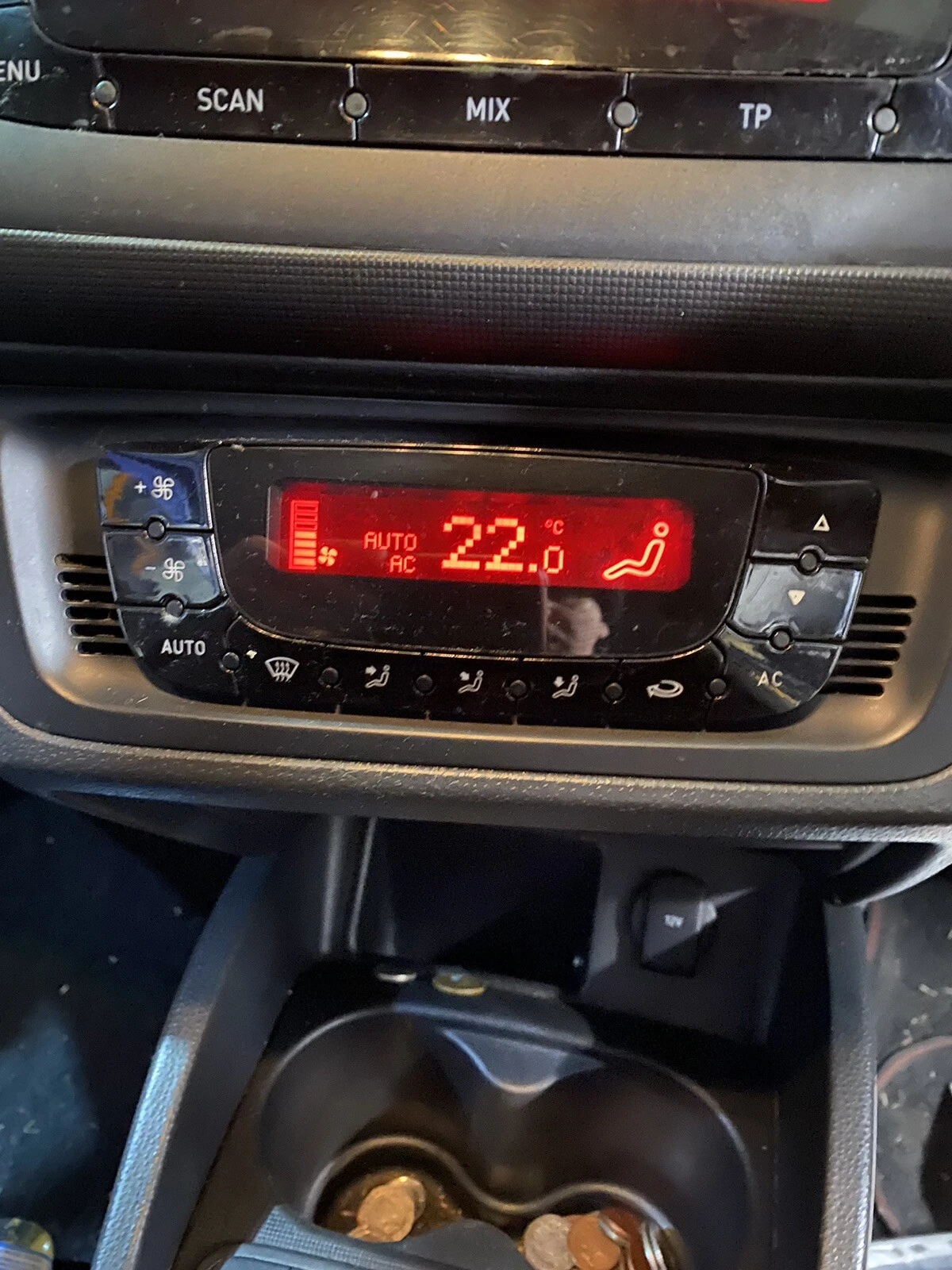

I've got a Seat Ibiza 1.2 TSI 2012 (steering wheel on left side), since I bought the car in March 2015 the fans haven't worked properly, quite often there is no airflow at all although I hear the blower motor spinning. Pulsating noises etc.
Mine looks exactly like this:
