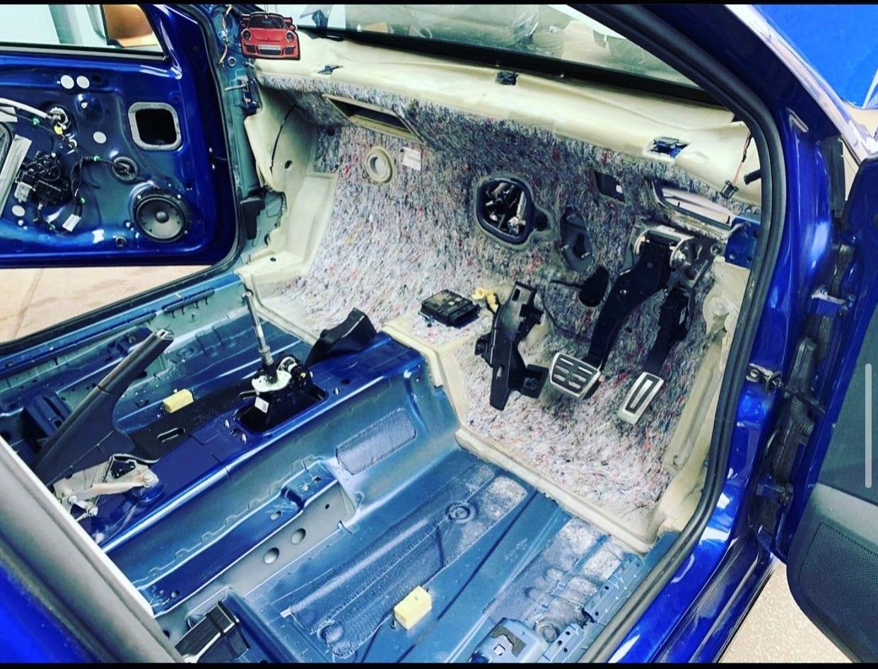

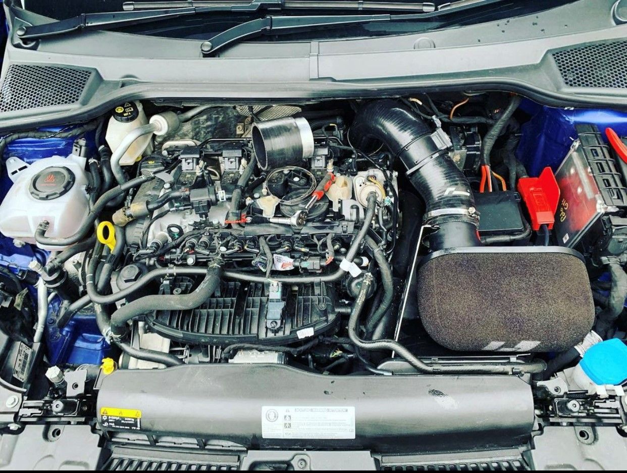

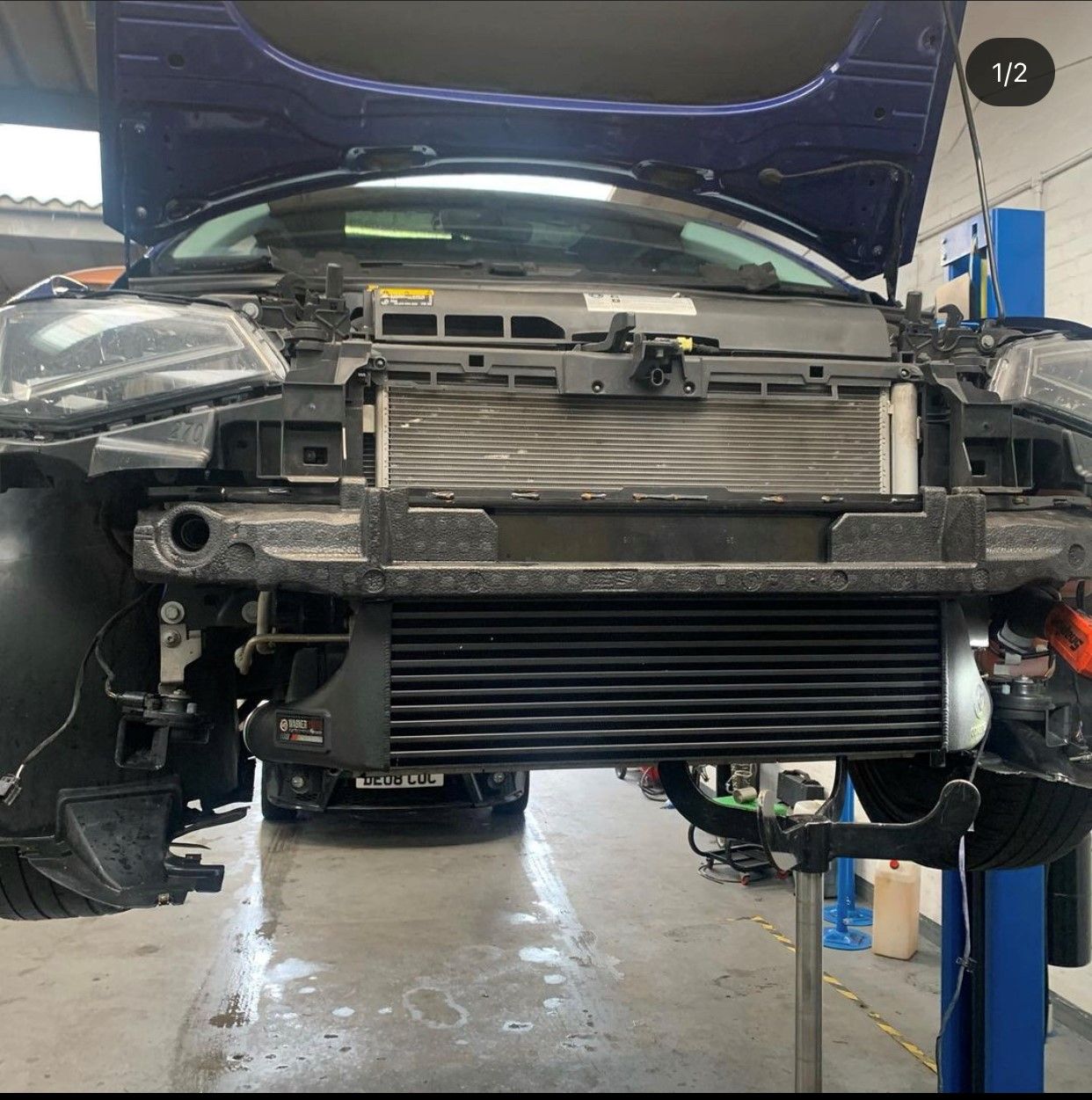

New to this forum but back in 2020 i decided to build a 2.0tsi ibiza to my knowledge the worlds first to my knowledge.4
Project has been complete now some time and ive driven over 22k with no issues.
still have a few things to fix like cruise and wireless charger
here is a couple of pictures
my insta is andy.parts
tiktok is ibizacupra6f

You have done some great work! That's a really nice swap! What was the original engine, 1.0 or a 1.5? And how was the process, pretty straightforward or have you find some problems?
Reactions: Ibizacupra6f

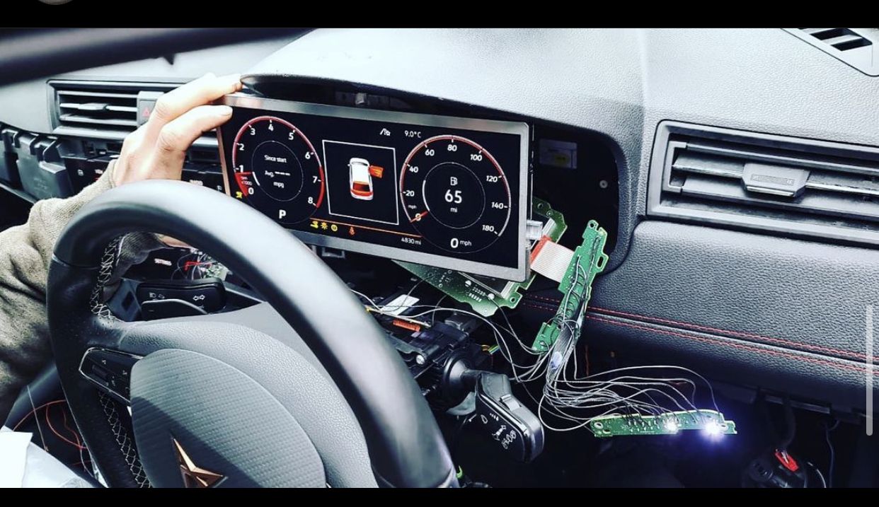

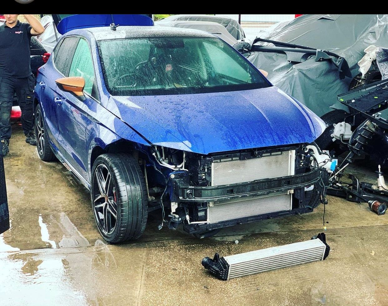

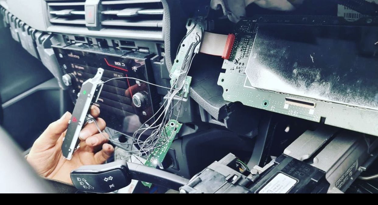

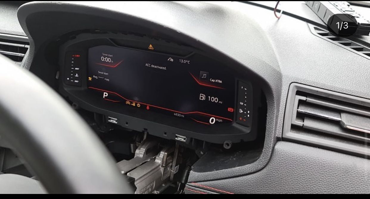

Originally a 1.0 manual. The swap was fairly simple itself however the headlights and virtual clocks were a nightmare I couldn’t code the seat VC into the polo so the polo clocks were deconstructed to fit inside the ibiza casing

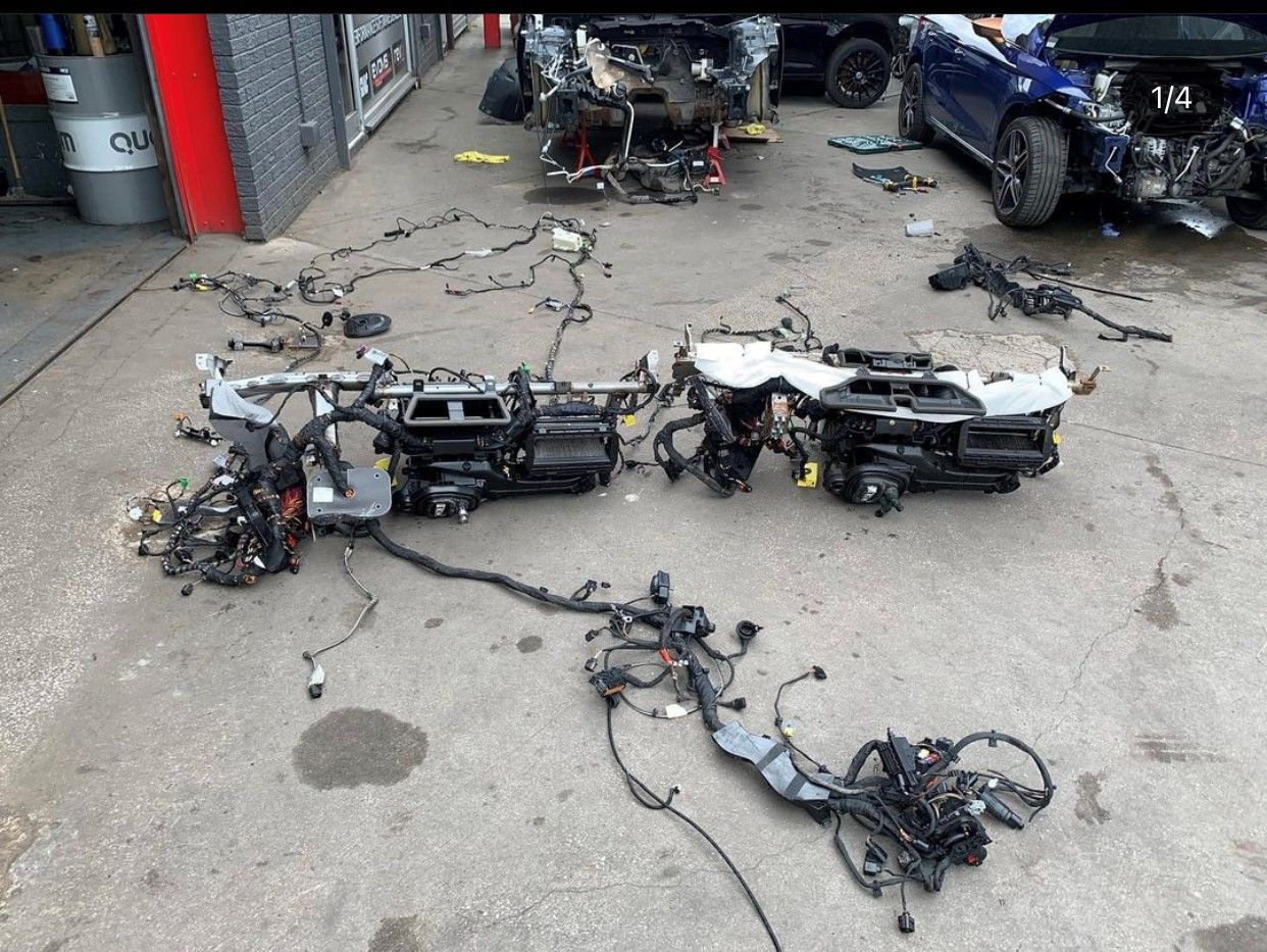

I saw on your insta that you also changed the 'ventilation ducts' behind the dashboard. Is that necessary for the engine swap?
Everything from the polo was swapped over full wiring loom went in. As it’s semi MQB the loom doesn’t split so had to swap the full car engine loom over
