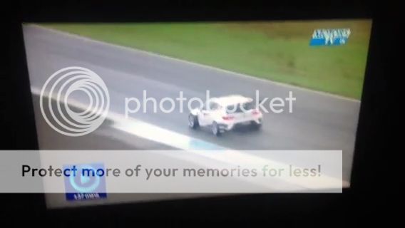

Just read this now was unaware you were going racing in it, good work as always mate will be logging in more often for updates on it
Not bad when it's wet but seriously out gunned in the dry. :cry:
Haha yes good spy. Nearly every corner had a similar 'MOMENT'!! I wasn't even thinking about the corrections they were just happening so quick, very intense! That race was probably the most fun I've ever had in a car!:D
I watched the show on motors tv. I was enjoying watching you give it hell;) Looked like a great day for you bud regardless of the rain. Keep it up mate. Got a series link on the sky box so hope to see more of your car soon.:happy:
