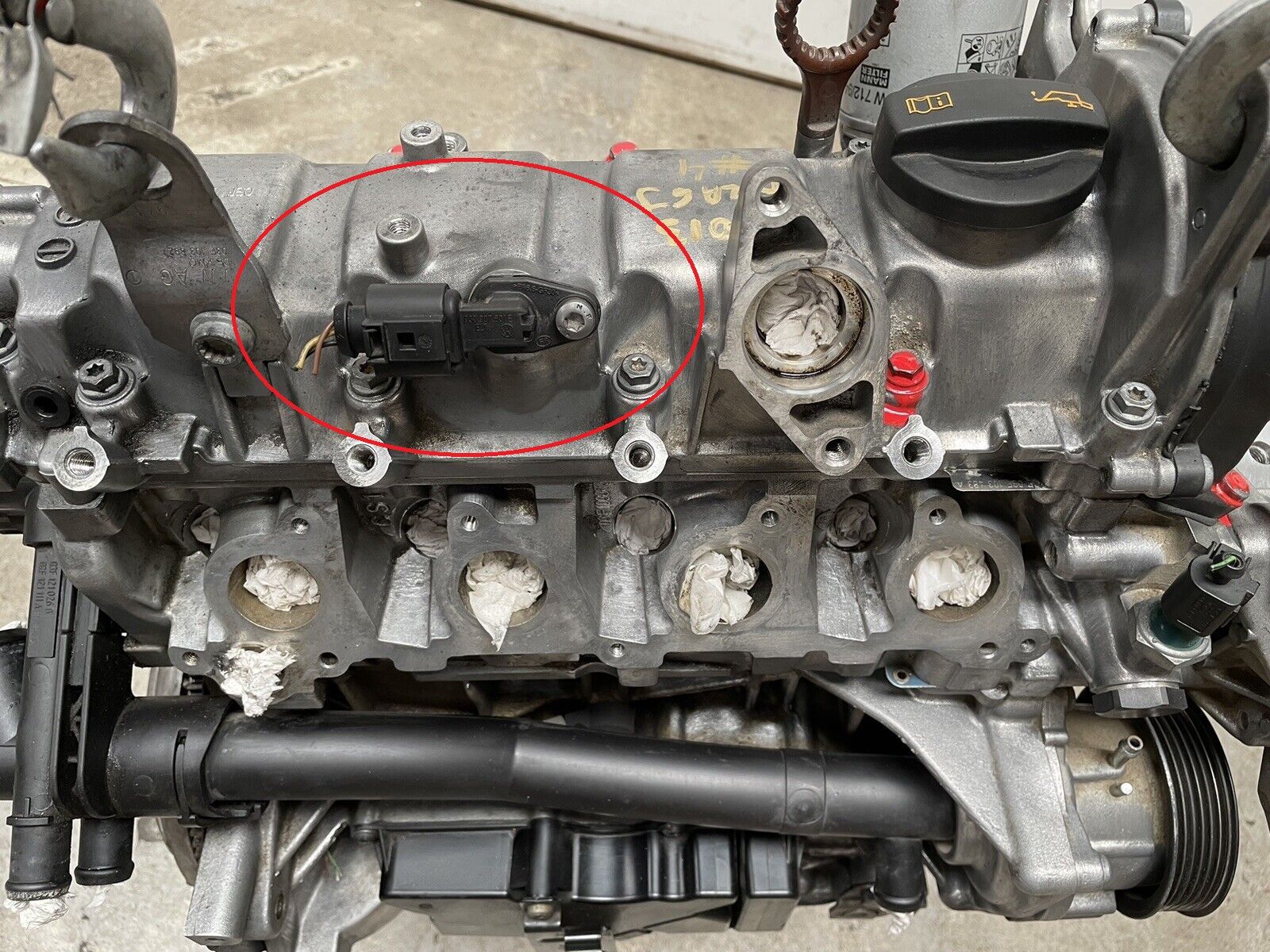

Getting camshaft sensor faults on my 1.2 tdi, barely starts and rough idle, where would I find the sensor? Done tons of research and nothing comes up for the j6 it's all mk3 (pre-facelift) or mk5
If it even has one, the mk3 and 5 both have but I can't find anything on the mk3 face lift
Not familiar with that engine but looking at some scrap engines on ebay, i'd be 99.9% sure it's this sensor here mate.
