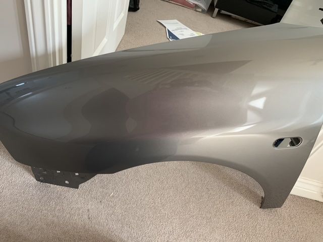

New painted wing arrived yesterday. Looks fairly well finished at first glance.

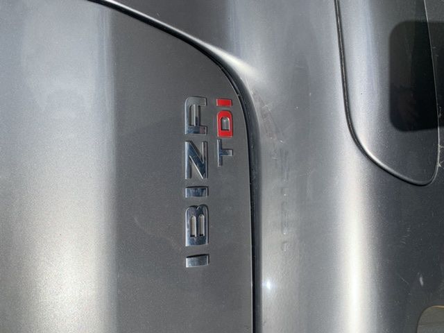

Ive also renewed the TDi badging on the tailgate as originals were tired

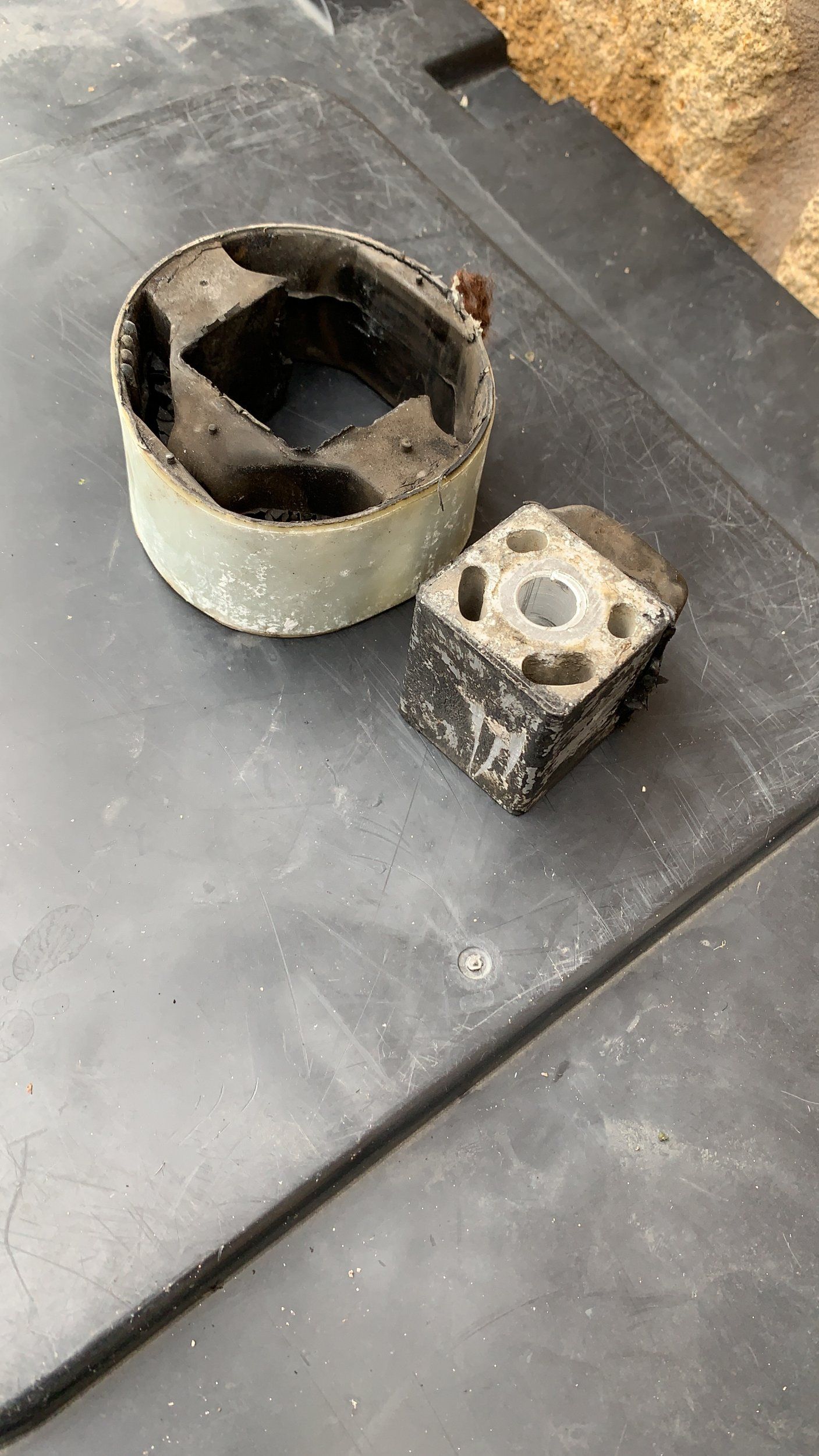

Dogbone mount replaced. Must have been the original fitted as the bush centre was separated from its surround & the outer rubber as good as fell out. Was in very poor shape.
Replaced with a red powerflex item. Seems spot on. Throttle response 100% improved & no more squeaking & creaking from the front end.

Well the dogbone mount didn’t last long- powerflex item has split through. Unfortunately that allows the dogbone bracket to pull out of the bush in the lower gear- cue mega-vibrations! New one en route!

Dogbone bush all sorted- powerflex purple jobber fitted now. Bit of vibration at idle but drives much better.
