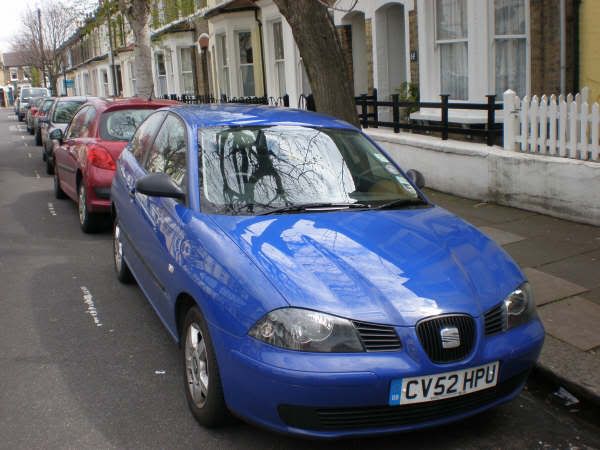

hmm.... i dont know havent seen any pictures! lol well i think i might just go and take a look...to see if it does!
brownie
i got a picture of it and im sure unsure..
confused:
hartless
confused:
that's not a 130 sport mate as far as I can see - no foglights, wrong alloys, headlamps are the single type rather than the dual ones on the sport...
