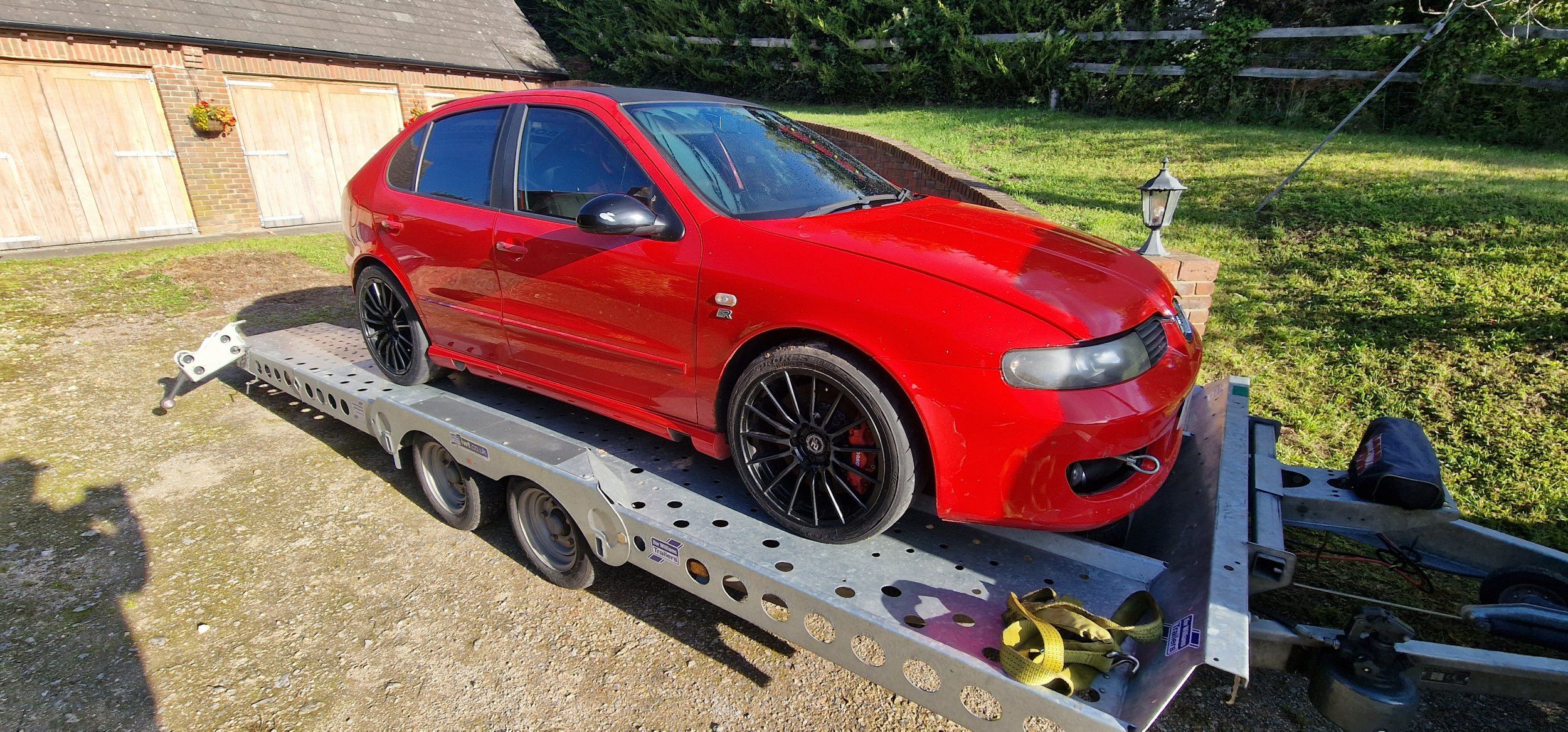

Car has been sorn for the last 2 years and its finally went to TSR Performance last Monday for a full engine rebuild and other work to get the car back on the road.
Picked up from Tsr this afternoon, running low boost until fully forged engine is run in, power around 350hp, engine specs as followed now :-
##T/BELT KIT VAG 1.8T 96-03 (WITH VIBRATION DAMPER)
IE rods
Wossner 1.8T 20v Piston Kit
Supertech Inlet valve 1.8T single collet
Supertech Inconnel exhaust valve
Supertech single groove keepers
Supertech valve spring kit 1.8T
Valve Seat Replacement and Cut Seats
VW/Audi Big End Bearing Set
ACL Race Main Bearing Set
Thrust bearing set
MAIN CAP BOLT
Oil pump kit 1.8T 20v with chain
EA113 Oil Pickup Pipe
CONVERSION SET 1.8T 20V
Head Gasket Set HGSK
Febi Hydraulic Cam Follower 1.8T (Intake x12
Febi Hydraulic Cam Follower 1.8T (Exhaust x8)
Febi Timing Chain Kit inc Tensioner 1.8T
Head Bolt Set 1.8T 20v BAM
Water pump Genuine
